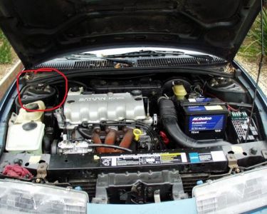

I'm not sure how to answer that. Last I had my car looked at, the mechanic pointed to it (circled in the pic below) and said "this motor mount needs to be replaced." I only brought it up because I told a neighbor about it and he said it's pretty cheap and easy to do. Not sure if that's true.
Either way I circled what I'm calling the motor mount. Not sure if it's right lol.
Note: NOT actual pic of my car.

You have the strut tower circled but if your talking about the engine mount the circle is touching then yes it's easy to change. You just take a floor Jack with a piece of wood under the oil pan and Jack it up againist the oil pan to take the weight off the mount. Then take the 5 nuts off and replace the mount.

Ah! The way the mech was talking, I understood the "strut" as the engine mount. Ok. That makes a bit more sense. Could you direct me to a site that would provide details about the labor? As I understand, it's relatively easy (I've been told).

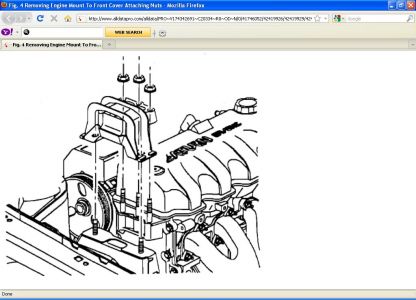

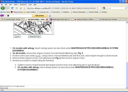

https://www.2carpros.com/forum/automotive_pictures/416332_1993_SL1_upper_mount_part2_1.jpg
https://www.2carpros.com/forum/automotive_pictures/416332_1993_SL1_upper_mount_part1_1.jpg
https://www.2carpros.com/forum/automotive_pictures/416332_1993_SL1_upper_mount_part3_1.jpg
I just told you how to replace but here you go anyways.

I know you told me, but seeing diagrams (for me) is easier. I do appriciate you locating and providing that information for me. Still working with the PCM. I'll let you know as soon as I get it fixed.
