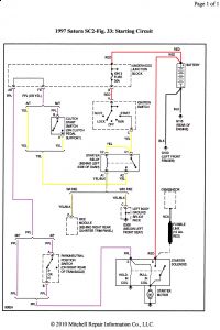

I've replaced battery, starter and starter relay. Car still wont turn. I believe it has to do with the passive alarm as the key fob won't unlock/lock the doors, had to use the manually.

https://www.2carpros.com/forum/automotive_pictures/416332_img018_1.jpg
do u have a test light?i take it ur starter doesnt engage from what u have replaced.have u checked all ur fuses like ur body fuse and chime fuse in ur inside fuse box.also ur ign 3 fuse in ur underhood fuse box make sure u check every fuse and make sure u have power to both sides of the fuse.let me know what u find and if u have a test light.

Are you trying to start the car when it is park? I had the same problem. Replaced the battery and relay. Try to start the car in neutral. If it starts, it's the parking switch. I replaced the parking switch on mine and it always starts.
