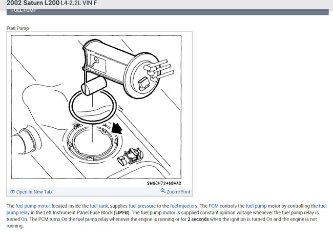

Car will not start. How would I check the wiring to fuel pump to see if that is the problem or if the fuel pump regulator is not working properly? Also, where is the fuel pump located?

The fuel pump is located in the fuel tank. Here is a guide to help you step by step with instructions in the diagrams below to show you how on your car:

Does this car have a fuel pump reset swtch and if not how do replace the fuel pump?
Monday, December 14th, 2020 AT 3:19 PM (Merged)

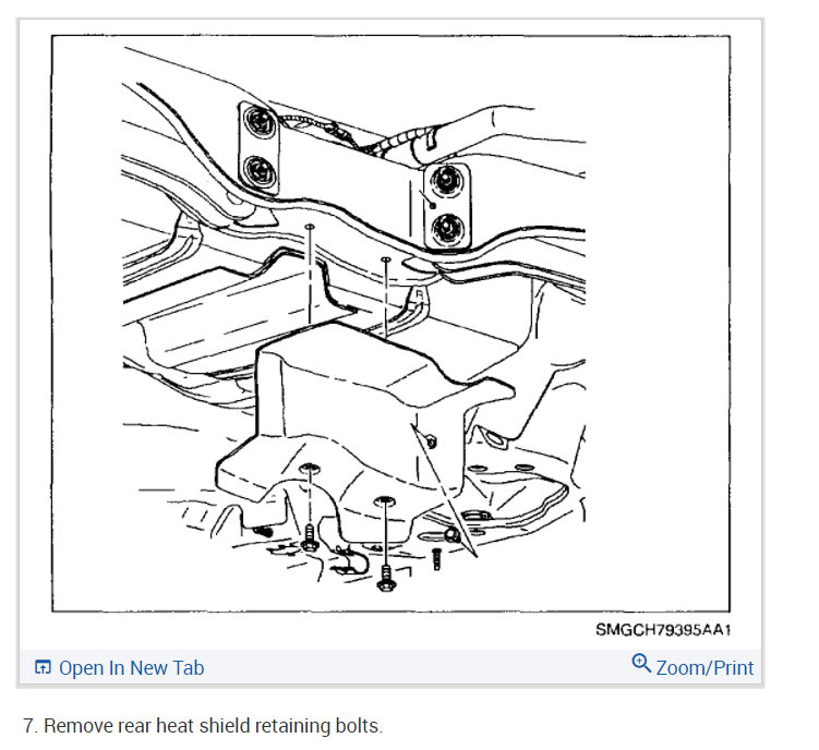

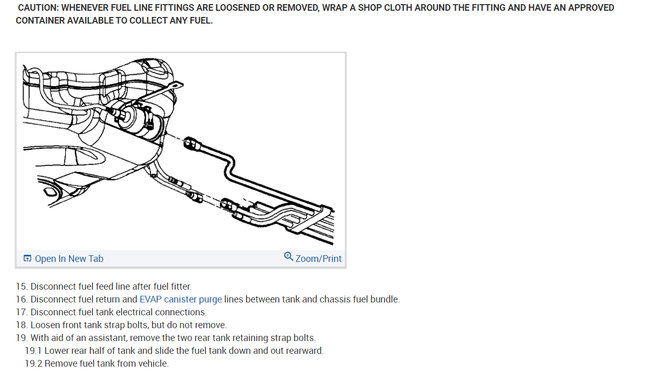

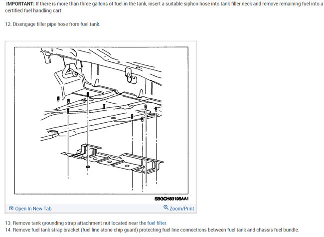

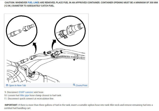

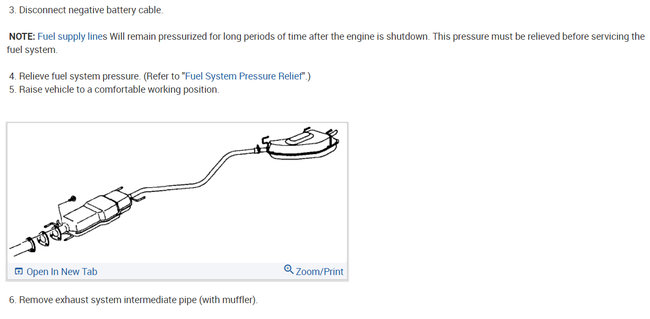

SATURNTECH9
  • 30,869 POSTS
https://www.2carpros.com/forum/automotive_pictures/416332_2002_L200_fuel_pump_removal_part_1_1.jpg
https://www.2carpros.com/forum/automotive_pictures/416332_2002_L200_fuel_pump_removal_part_2_1.jpg
https://www.2carpros.com/forum/automotive_pictures/416332_2002_L200_fuel_pump_removal_part_3_1.jpg
https://www.2carpros.com/forum/automotive_pictures/416332_2002_L200_fuel_pump_removal_part_4_1.jpg
https://www.2carpros.com/forum/automotive_pictures/416332_2002_L200_fuel_pump_removal_part_5_1.jpg
First of all thank you so much for your donation i posted how to replace the fuel pump.There is no fuel pump shut off reset on your car.So i take it your car has no fuel pressure?If that's the case then try this Have someone crank the car over to try to start it while you get a hammer and turn it side ways' then smack on the middle of the tank see if the car start's.Don't go crazy hitting it just enough to see if it start's.

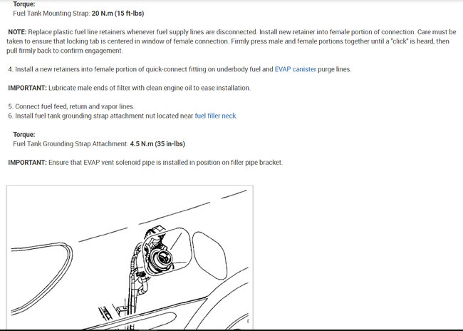

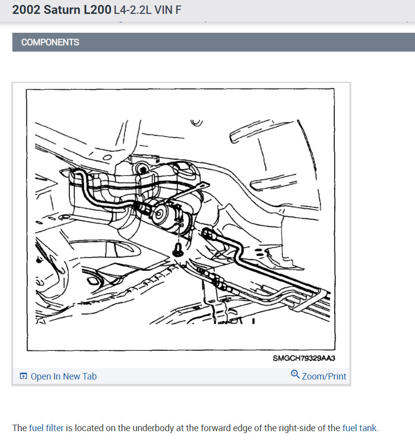

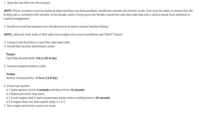

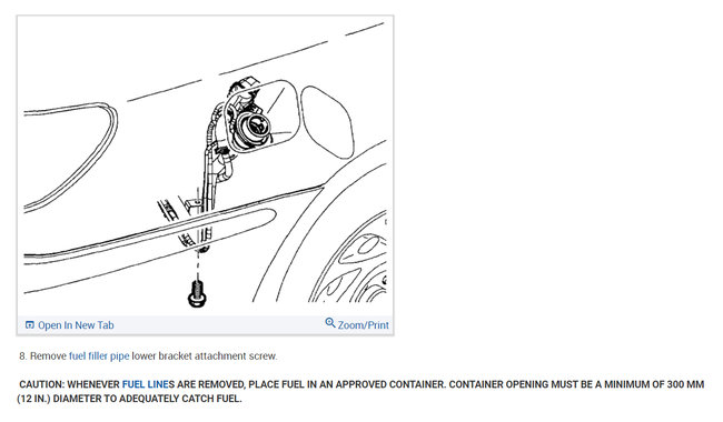

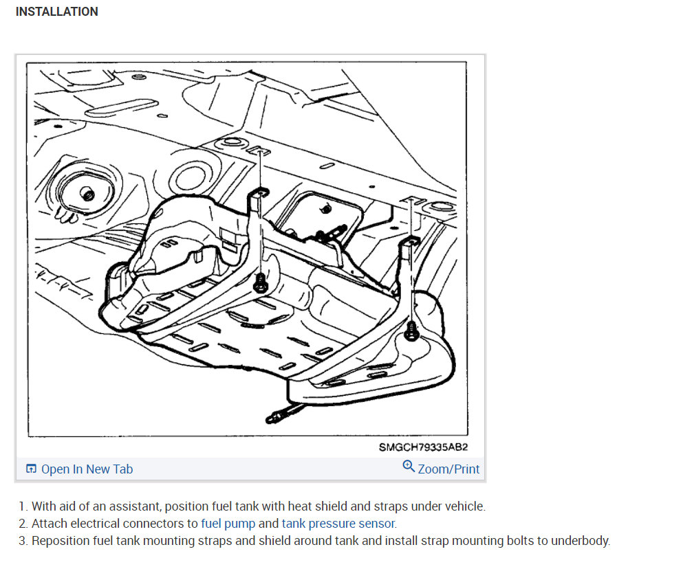

I was trying to drop the fuel tank in a 2002 Saturn L200, but the exhaust is in my way. Is there any other way to change the fuel filter without dropping the tank. I am having probelms with the tank leaking fuel, wondering if there were any recalls for that car reguarding the fuel system?
Monday, December 14th, 2020 AT 3:20 PM (Merged)
2CARPRO JACK
  • 11,533 POSTS
According to Mitchell, you unbolt the bracket holding the filter in to remove it. I dont see any recalls or bulletins on fuel leaks for your car either, sorry
