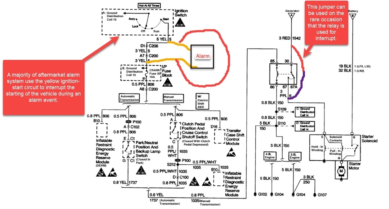

I have the vehicle listed above with factory security system that is not allowing the solenoid engage. Just clicks until messing with the wires on the box. What wires do I put together to eliminate the whole box and system?

A majority of alarm installers will use the yellow wire at the ignition switch for the starter interrupt circuit of the alarm system. On an extremely rare occasion they will use the starter relay. For both instances I have illustrated a way to bypass these methods.
+1
Monday, December 7th, 2020 AT 12:50 PM
CHEVYREDNECK123456
Okay, thank you. I thought so. My friends 2002 Malibu was similar I didn't want to just cut wires.
