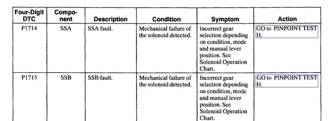

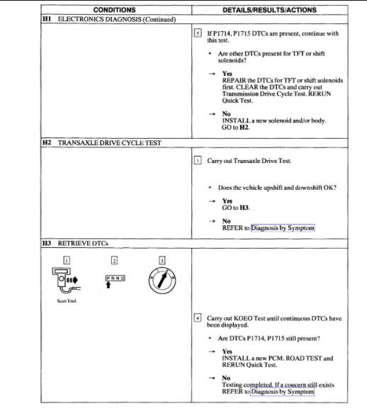

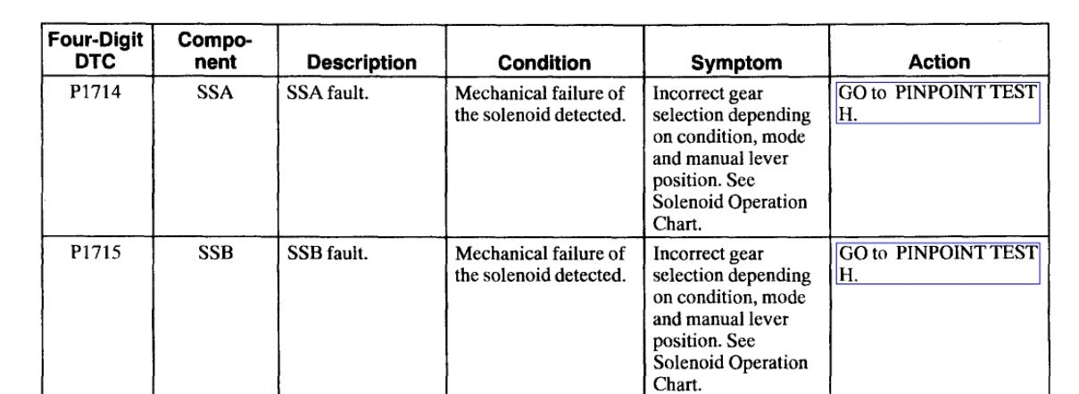

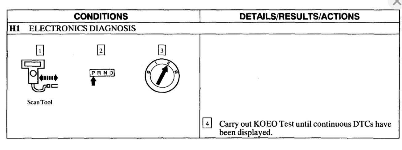

Now I’m getting a p1714 shift solenoid a inductive signature code.
Sunday, October 18th, 2020 AT 6:35 AM
Yes, it could be a shift solenoid but has no effect on the car not engaging the transmission.
I attached the flow chart for the code as it could be the solenoid or valve body but in your case, it will not help the transmission to engage into gear.
Sunday, October 18th, 2020 AT 6:50 AM

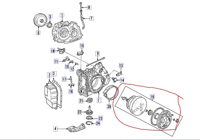

But it does engage it just disengages after a few minutes.
Sunday, October 18th, 2020 AT 7:50 AM
It sounds like you have a bad front pump in the transmission. It is not producing enough pressure.
I attached a picture of the front pump assembly for you.
