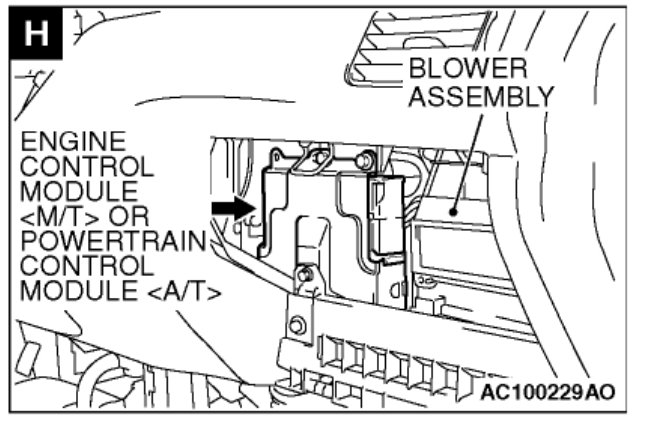

It runs okay when the MAP is disconnected? It sounds like the PCM is having an issue I would try a used one to see what happens. Here is the location.
Any codes?

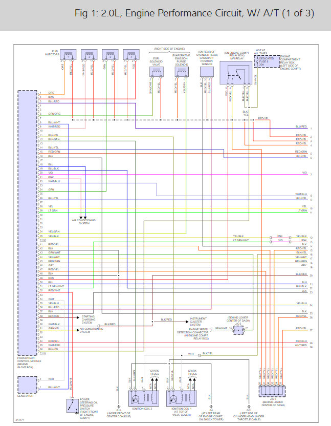

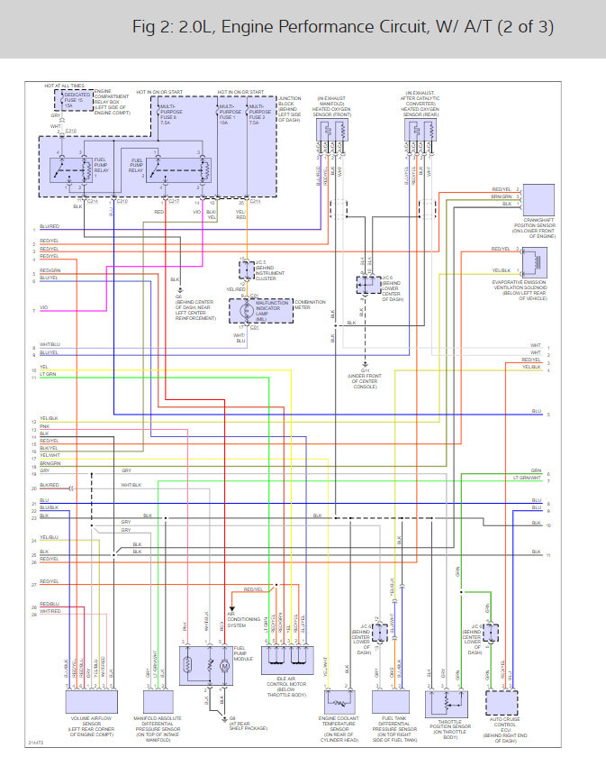

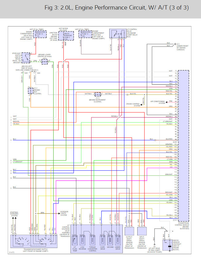

Okay, here is a guide and the engine wiring diagrams so you can go over the wiring to make sure you don't have a bad connection somewhere:

Okay, so I check the voltage to the map sensor and it is 4.70 volts and it should be five volts, If the map sensor should give a good value at five volts would 4.70 volts make the signal wire send incorrect voltage to the PCM.

Yes, it sounds be five volts. I believe you found the problem.

I have got another next problem. I have a four wire map sensor it got temperature and manifold pressure in one. I am not seeing any wiring diagrams for the four pin map sensor only three pin and MAF.

You say MAP in the first post, I see the map in the wiring diagram and you say you have a four wire map I have never seen that only three wire.

Which country is this car from? If it has the 1.5L 4G15 in it, that is a different engine control system than the 2.0 sold in the US.
The base engine is the same as sold in the earlier 2002 Mirage, but the US versions have to meet OBDII specs while the other countries do not so they use a slightly different control system depending on the country they are sold in. There still should be the same three wires (five volt, ground, signal) for the MAP but the five volts feeds both the MAP and the IAT.

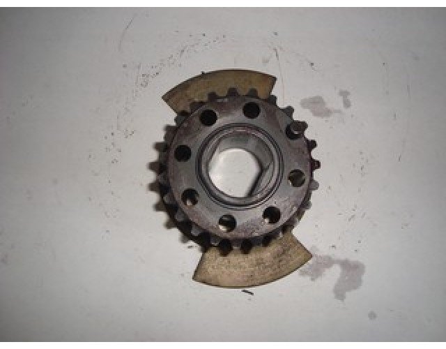

I will have to check my spark plugs and see, it looks like my timing is off by 3/8 of a teeth, the crankshaft sprocket has some play in it, fuel pressure is 40psi an it holds system pressure when I turn the engine off and leave it there.

I have seen where the lower drive sprocket ends up making a groove where the key way is allowing the timing belt to be retarded. This could be the problem with ours.

It has no key way sadly.

This is it, it is like the crankshaft has worn out in the side the sprocket has to hold into. I think my last chance is to buy a adjustable cam gear to get the timing correct.
