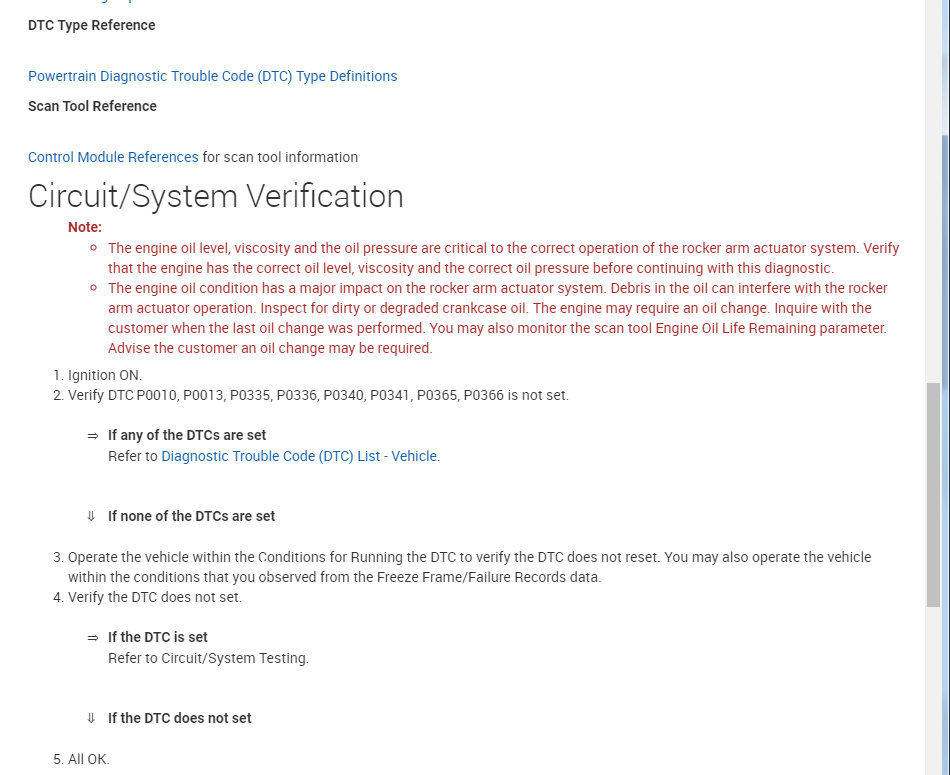

First things we need to make sure of is that that is the only code and that you have proper oil in good condition, at the proper level and that you have good oil pressure. The reason for this is that the solenoid controls oil flow to the actuator and if the pressure and oil isn't correct then it will set this code.

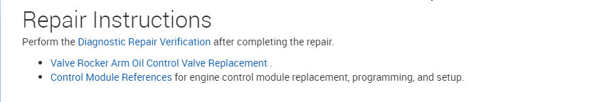

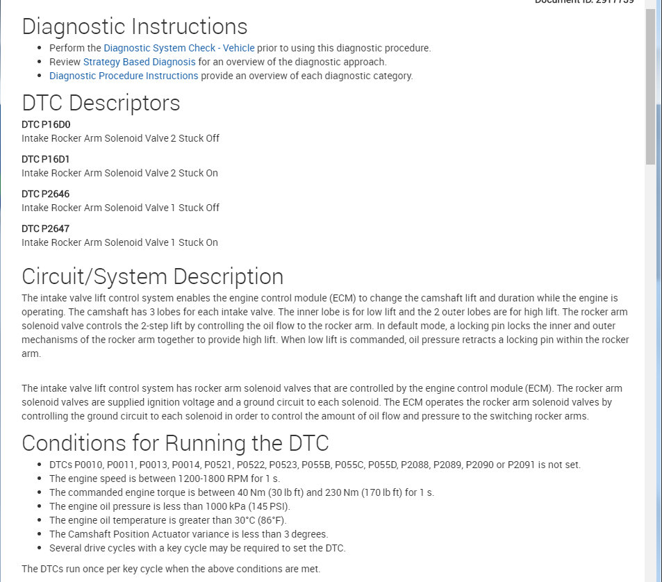

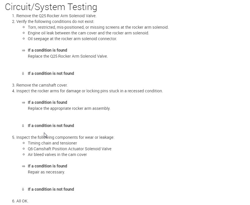

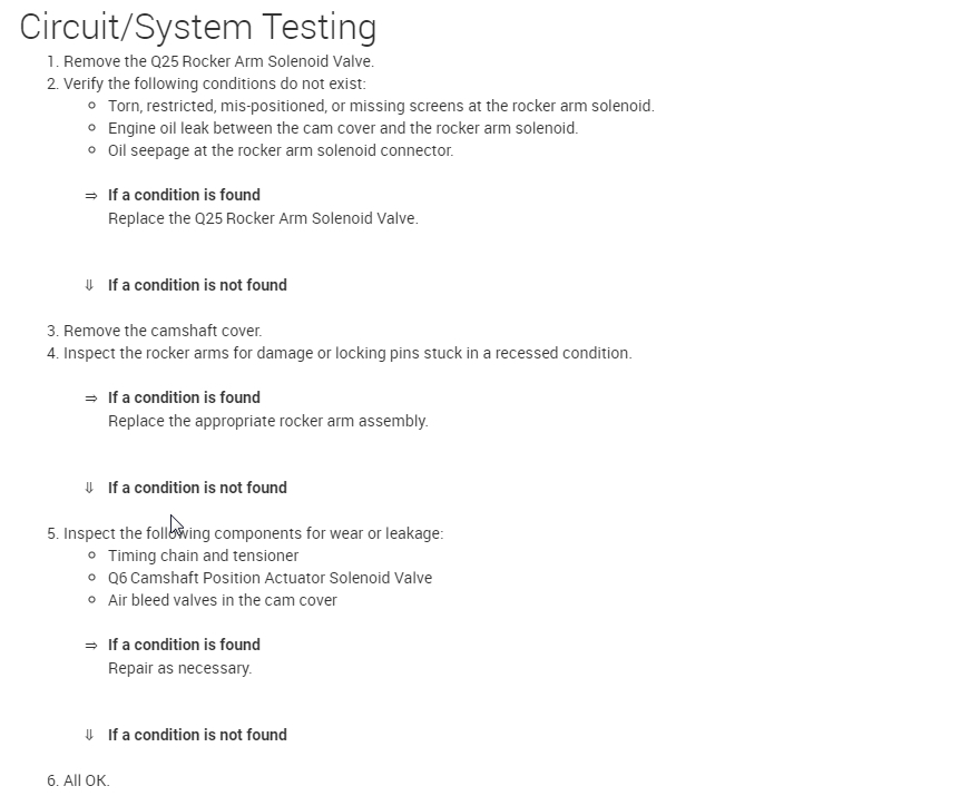

Just want to add an observation on this one. I had one not to long ago that the rocker was damaged so here is the testing to follow in case it does come back on. Pay particular attention to the Circuit/System Testing. Thanks
+1
Sunday, January 5th, 2020 AT 1:19 PM (Merged)

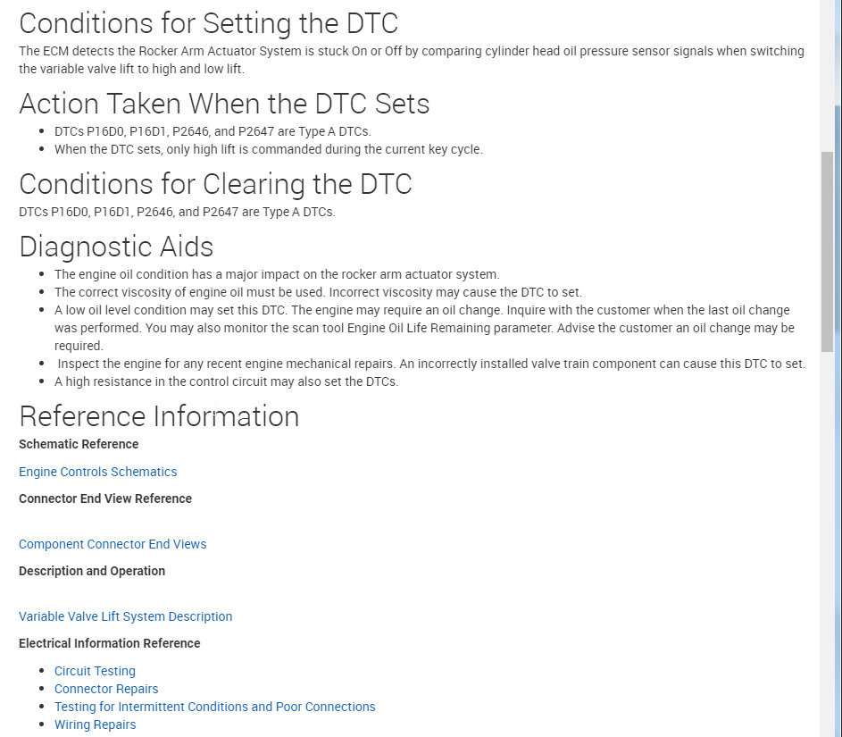

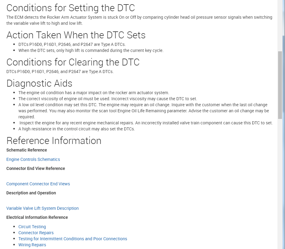

P2646 is a type A code. That means it takes one failure to set, it also means it will clear as soon as the system sees the fault is repaired. If you replaced the solenoid and it still shows the code you still have a problem. That code can be set by low oil or using the wrong oil as well as if sludge blocks the oil passage. Now that you have changed the solenoid I would probably do an oil and filter change and be sure to use the correct oil.
Beyond that you will want to remove the valve cover to verify that none of the rocker arms are stuck so the pins cannot extend as the code shows the system is locked in the off position.
