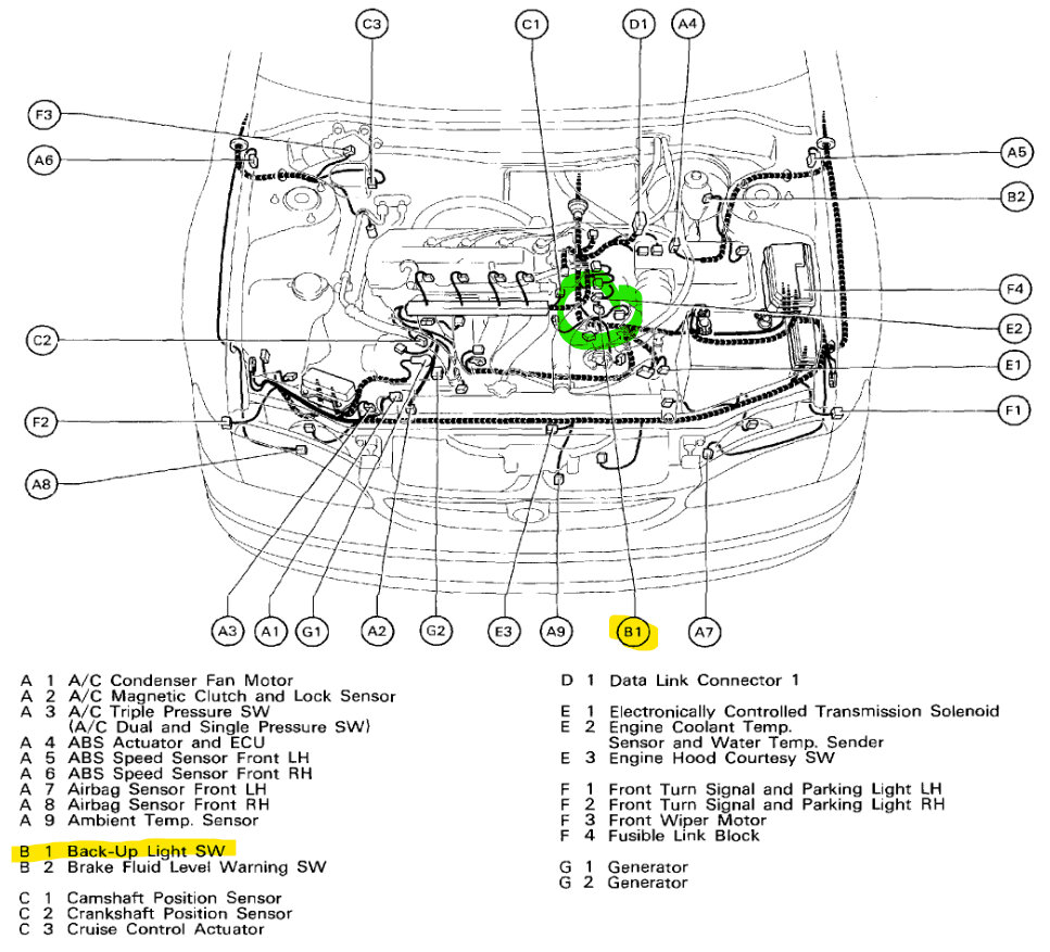

My reverse light suddenly stopped working troubleshooting done:
Gauge tested
Fuse tested
Bulb tested
Looking for the reverse knock switch.
The transmission is a 4AFE.
Wednesday, November 2nd, 2022 AT 12:11 PM
2 Replies
AL514
MECHANIC
5,590 POSTS

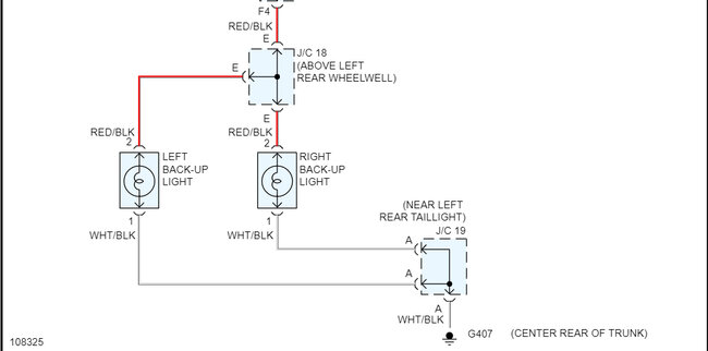

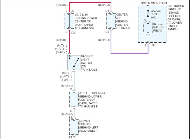

Hello, here is the location and wiring diagrams for the Back Up Light Switch. And a couple guides to help with testing.
