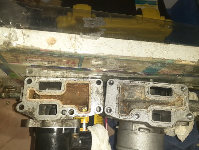

I just open my Idle Air Controller Valve saw how dirty inside. So guys do you think it the same thing that makes my car revving up and down?
Monday, January 27th, 2020 AT 1:49 AM
  • 110,194 POSTS
Any thing that can cause an air restriction can create an issue. I would also check the IAC itself and yes, make sure the gasket is new. Otherwise you risk having a vacuum leak.
Monday, January 27th, 2020 AT 8:29 PM

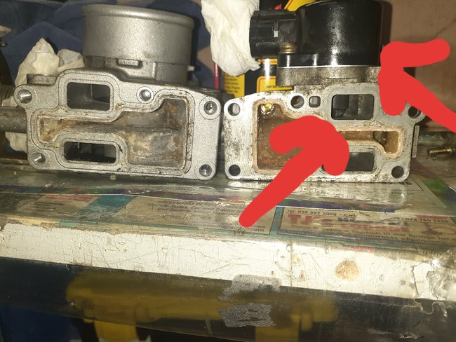

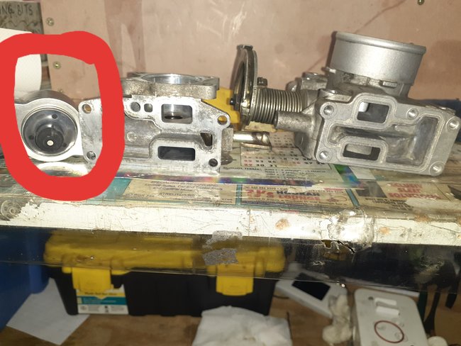

Guys, what do you call this black thing it where the air goes in throttle body, this one I put red mark?
Sunday, February 2nd, 2020 AT 11:56 PM
  • 110,194 POSTS
That is the idle air control (IAC). That is what changed position to allow air to enter at an idle.
Monday, February 3rd, 2020 AT 8:40 PM

Okay, because I take out and I clean it to it was dirty.
Monday, February 3rd, 2020 AT 9:59 PM
  • 110,194 POSTS
Be careful what you clean it with. Don't use something like brake fluid. Also, confirm it is working. Plug it in and have a helper turn the key on and off. You should see movement.
Let me know if it helps
Tuesday, February 4th, 2020 AT 7:01 PM
SANDILE04
  • 20 POSTS
Okay, to clean I was using Throttle body air cleaner or carburetor cleaner.
Tuesday, February 4th, 2020 AT 7:41 PM
  • 110,194 POSTS
That should be okay. Has it helped?
