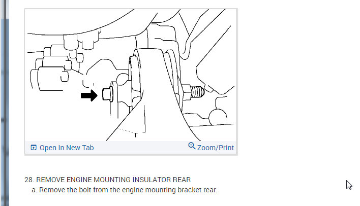

Need steps in order to make sure there wasn't anything going to be in the way. Wanted to double check before replacing the motor mount and being stuck.

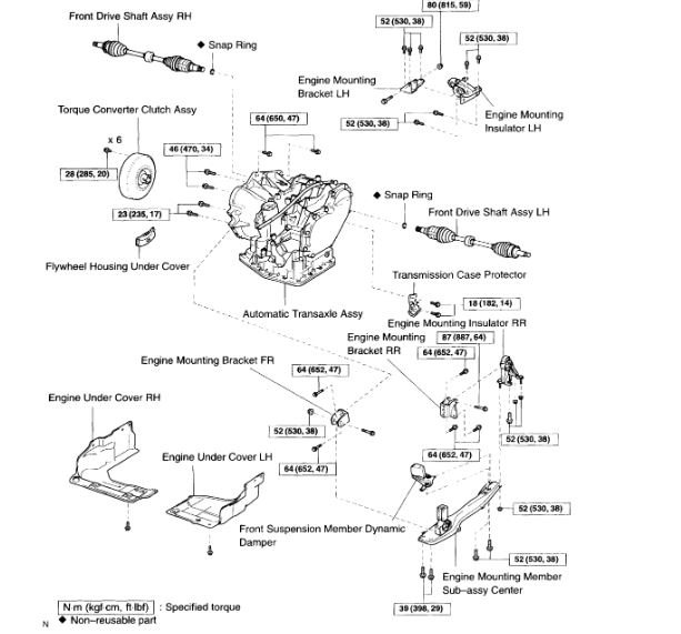

When you say the rear mount, do you mean the one pictured below?
Are you able to get a picture of the one you are looking for because there are transmission mounts that are also called the rear mounts. So getting a picture of the one you are looking for will be the best way to ensure we get you the correct info.
However, Toyota did not supply procedures just for the mounts so they are part of other processes but I am sure we can get you the info that you are looking for.

Hi, What are the torque specs for the upper motor mount? Thanks
Monday, June 28th, 2021 AT 10:58 AM (Merged)
MMPRINCE4000
  • 8,548 POSTS
Here are all of the engine mounts torque specs
Engine mounting insulator RH x Transverse engine engine mounting bracket 52 Nm (530 kgf-cm, 38 ft. Lbs.)
Engine mounting insulator RH x Body 52 Nm (530 kgf-cm, 38 ft. Lbs.)
Engine mounting member sub-assy center x Body 39 Nm (398 kgf-cm, 29 ft. Lbs.)
Engine mounting insulator RR x Engine mounting bracket RR 87 Nm (887 kgf-cm, 64 ft. Lbs.)
Engine mounting insulator RR x Suspension member 52 Nm (530 kgf-cm, 38 ft. Lbs.)
Engine mounting insulator FR x Engine mounting bracket FR 52 Nm (530 kgf-cm, 38 ft. Lbs.)
Engine mounting bracket LH x Transaxle 52 Nm (530 kgf-cm, 38 ft. Lbs.)
Engine mounting insulator LH x Body Bolt A 52 Nm (530 kgf-cm, 38 ft. Lbs.)
Engine mounting insulator LH x Engine mounting bracket LH Nut B 80 Nm (815 kgf-cm, 59 ft. Lbs.)
Engine mounting bracket FR x Transaxle 64 Nm (652 kgf-cm, 47 ft. Lbs.)

My daughter run over a rock on the highway in the dark. It bent the motor mount(s) and there is a noticeable vibration when idling at a stop light. Not so bad when in park or neutral with the engine running. Mechanic said motor mount(s) were bent. How do I change the rear mount? I hear you have to drop the subframe, whatever that is.
Monday, June 28th, 2021 AT 10:59 AM (Merged)
MMPRINCE4000
  • 8,548 POSTS
Yes you must drop the subframe. It is held in place with about 6-8 bolts, and you must disconnect the lower ball joints ( just remove the 3 bolts that hold the BJ to the control arm), and the center and front motor mount bolts.
This is a heavy item, so use a floor jack. The rear mount is the hardest one to remove as compared to the rest.
