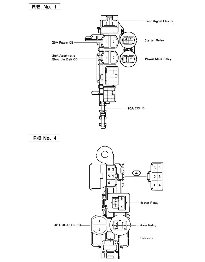

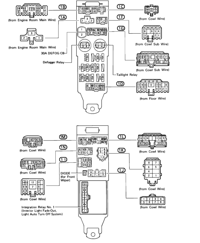

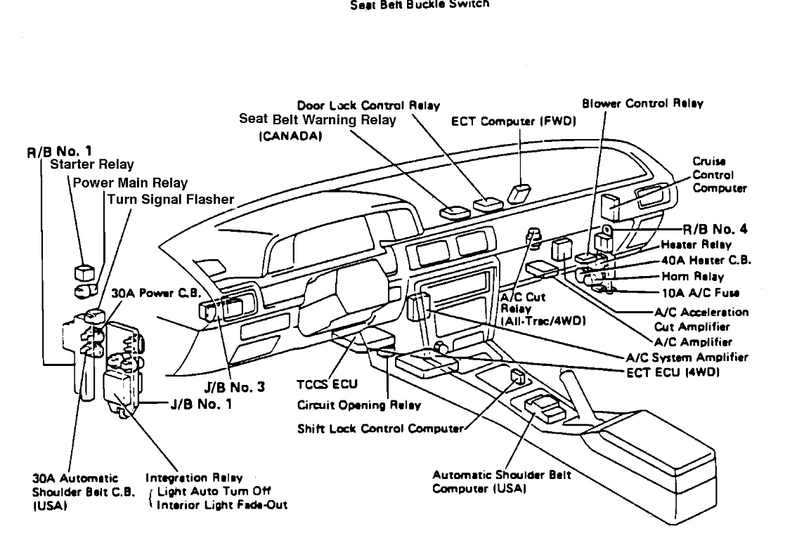

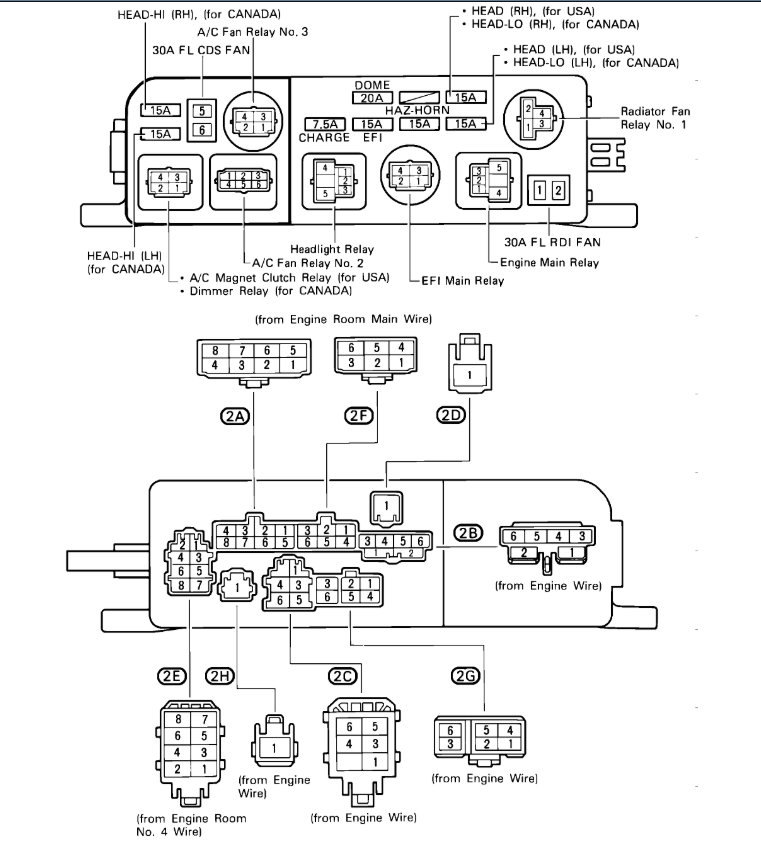

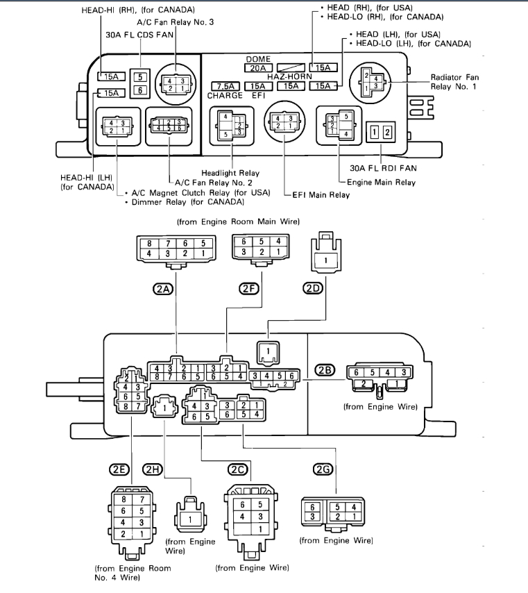

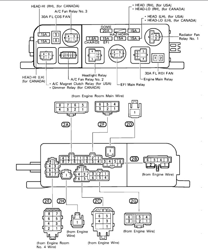

Where is the fuel pump relay location?
Mar 1, 2020 at 10:44 PM
MOTOR MASTER
  • CAR REPAIR CONTRIBUTOR
  • 279 POSTS
Hello my name is Dave.
Your car has what they refer to as a circuit opening relay which is located on the ECU. however, I am interested to find out exactly what symptoms your car has as I have never had one of these go bad. Have you checked the ECU relay? I have attached a illustration showing the location of both of these relays. If you could let us know what symptoms you have we will be glad to help you further.
Mar 2, 2020 at 4:42 AM
JOHNBEARBOY
I just need a picture of the location of the fuse box all fuses that is related to the fuel pump that is all I need . Thanks
Mar 3, 2020 at 9:57 AM
  • 54,406 POSTS
Here is a guide to help you test the fuse and relays with the relay and fuse locations in the diagrams below:
and
Check out the diagrams (below). Please let us know what you find.
