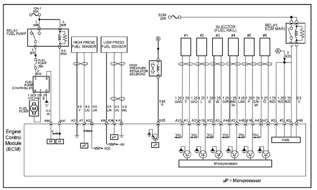

Where is that location?
Friday, January 8th, 2021 AT 9:25 AM (Merged)
WRENCHTECH
MECHANIC
20,761 POSTS
Location of what? The circuit is a system not a thing.
Here is the wiring diagram.
