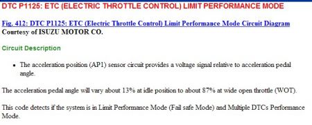

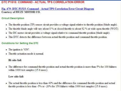

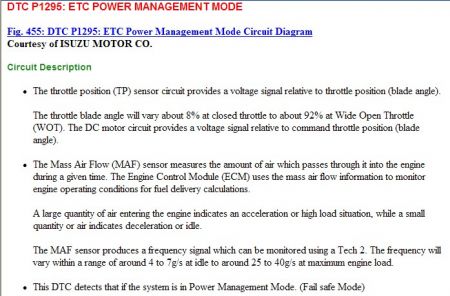

Both check engine and reduced power light constantly coming on, I lose power while driving and can only go about 35mph. Have had both catalytic converters checked, MAF replaced and put back, both TPS' replaced and still have the same problem. At first the same three codes would show up p1515, p1125, and p1295. Then the other day while running the car it began to shut off by itself every once and a while. Then all of a sudden it went from the same three codes to 12 codes. Disconnected battery and when lights came on 15 codes appeared, then when we did the same thing 20 codes appeared. If given a day the car will run fine for about thirty minutes then check engine light and reduced power again. What could the problem be? Could it be the wiring? Or could it be that I need a new computer? Can I get the computer checked out somewhere?

I googled the three codes for you and this is what came up. I recently had the same problem with my wifes car and we replaced the TPS and it runs just fiine. The TPS is a dealer only part which costed us 150 bucks. Hope this helps.
https://www.2carpros.com/forum/automotive_pictures/482394_1295_1.jpg
https://www.2carpros.com/forum/automotive_pictures/482394_1515_1.jpg
https://www.2carpros.com/forum/automotive_pictures/482394_1125_1.jpg

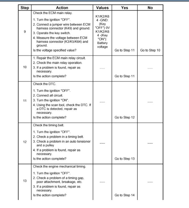

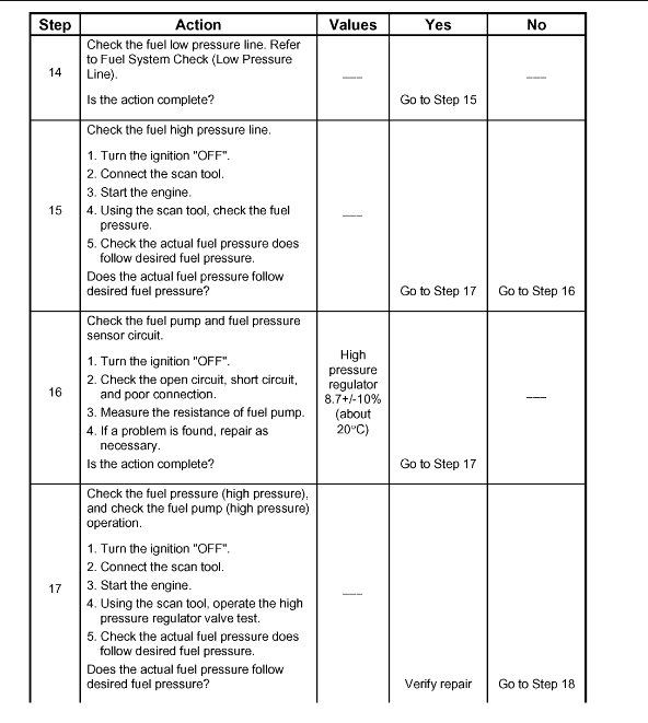

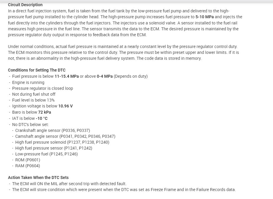

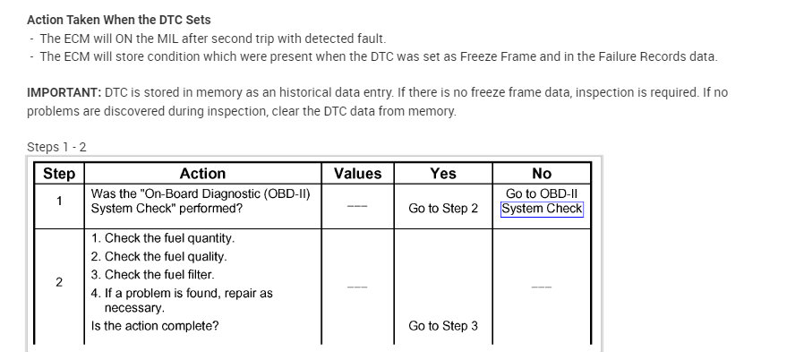

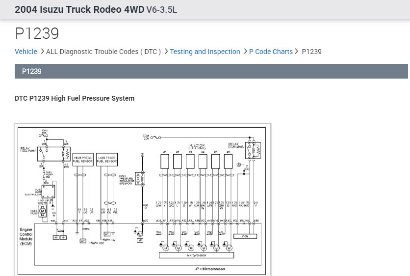

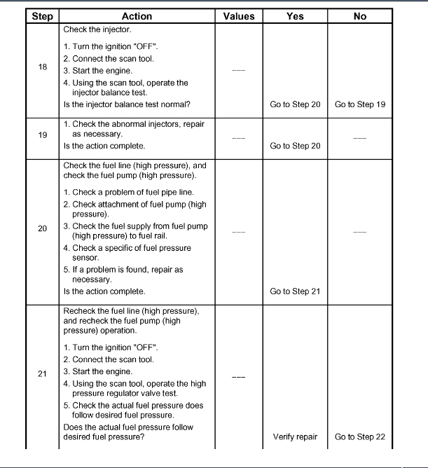

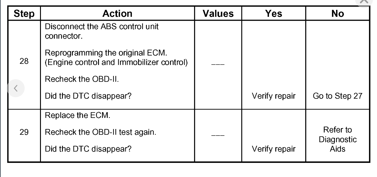

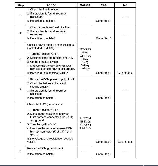

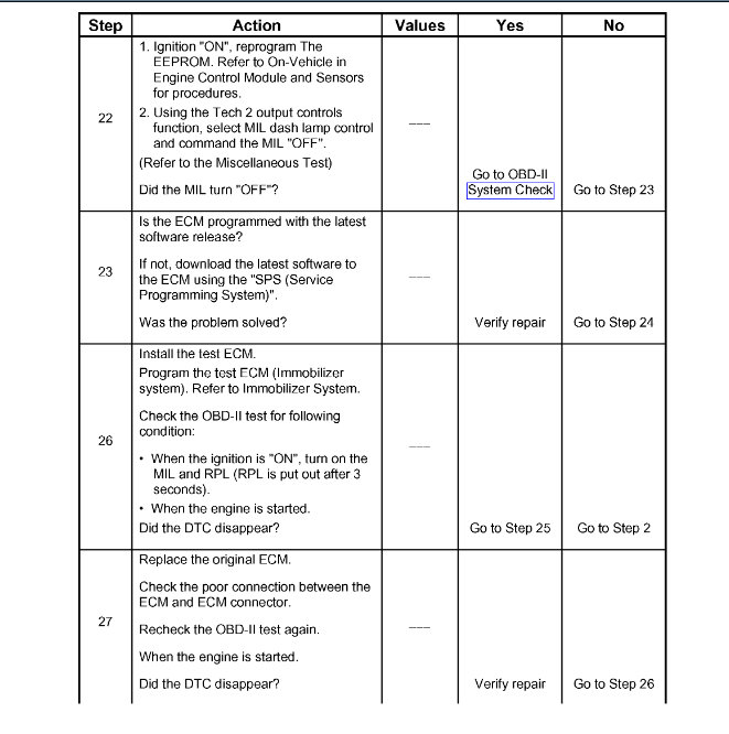

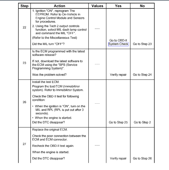

DEJUAN LYONS
  • 2004 ISUZU RODEO
  • 3.5L
  • 6 CYL
  • 4WD
  • 165,000 MILES
One day I was driving my vehicle taking a friend to work. It began to jerk all of a sudden and the Reduced Power light illuminated on the dash. I began to lose power. I went to my local mechanic that I trust and they stated that it was the fuel pump. Not knowing that I have 2 fuel pressure pumps in my vehicle, I got the one in the tank done. I was told later on that it was the High Fuel Pressure Pump. Could this be the cause of my Reduce power light staying illuminated? And what could the other causes of code p1239 mean for my vehicle listed above?
Friday, January 8th, 2021 AT 9:24 AM (Merged)
SCGRANTURISMO
  • 4,897 POSTS
I have included for you the factory diagnostic troubleshooting flowchart for Direct Trouble Code(DTC) P1239 for your vehicle. Please go through this flowchart and get back to us with what you find out.
Thanks,
Alex
2CarPros

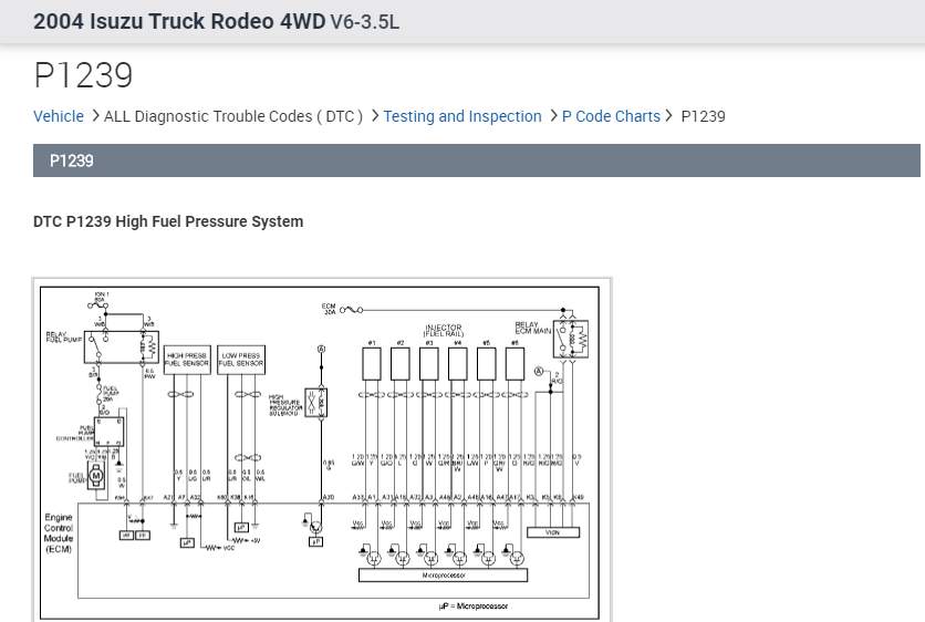

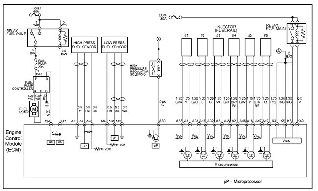

MIKEANDIKE
  • 2004 ISUZU RODEO
  • 3.5L
  • 6 CYL
  • 4WD
  • 7,900 MILES
When I clear the code it will accelerate but not running well. The code is not in my book can you tell me what the means? This is the code P1239.
Friday, January 8th, 2021 AT 9:25 AM (Merged)
WRENCHTECH
  • 20,761 POSTS
Your car has both a high pressure and low pressure fuel supply systems. The low pressure supply pump in the tank and a high pressure pump on the engine that brings the pressure up over 1500PSI. The code indicates the pressure on the high side is incorrect. This is a very dangerous system to work on and I suggest you have a competent local mechanic look at it.
MIKEANDIKE
I replaced that pump and no I am not a mechanic. I am an auto body mechanic and I work on the lighter side of mechanical.
WRENCHTECH
  • 20,761 POSTS
That kind of pressure can really hurt you if you do not know how to unload it.
You could have an electrical issue associated with the pump solenoid circuit.
