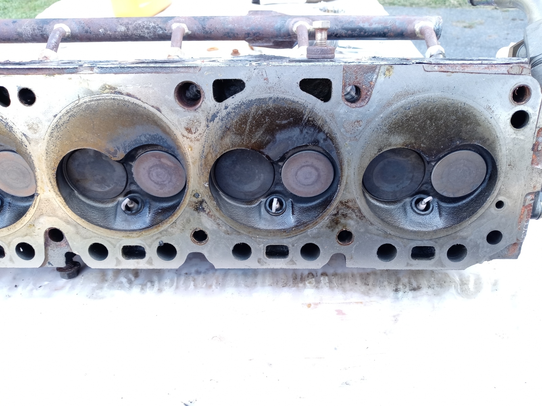

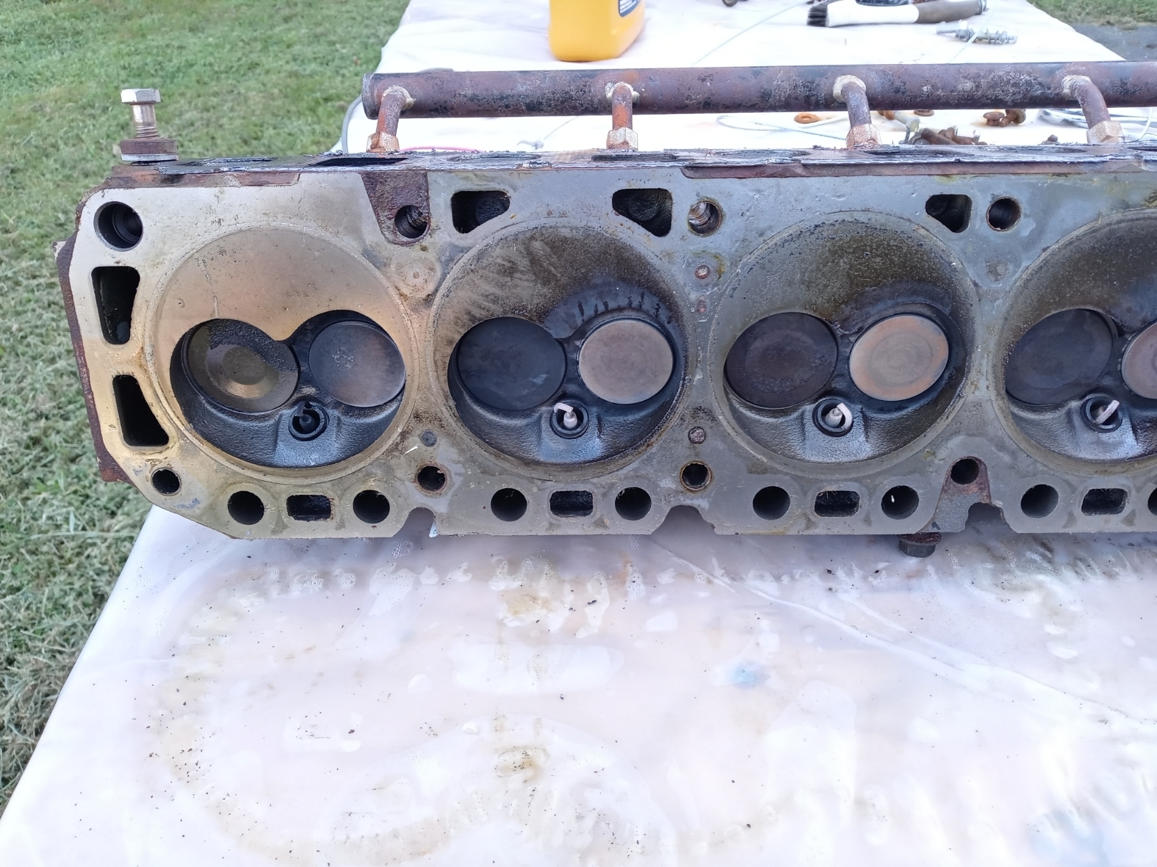

Hello, I am back on this. I took the head off to inspect for valve damage since I overheated the engine exhaust, a few times. I don't see any damage but I don't have a trained eye. How can I verify that all the valves are seating correctly?
Sunday, September 5th, 2021 AT 2:46 PM
  • 110,192 POSTS
Since the engine didn't overheat, it should be fine. Take a bright flashlight and shine it on each valve in the head. See if there is any light going through. You will see it if there is an issue. You will be able to see it in the inlet/exhaust ports on the head.
Let me know what you find.

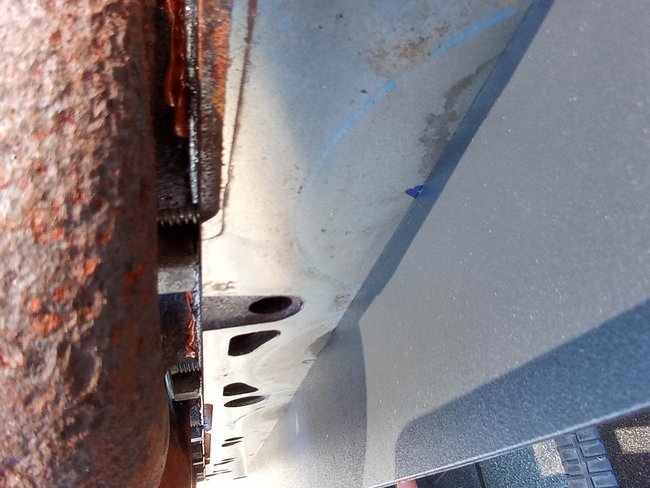

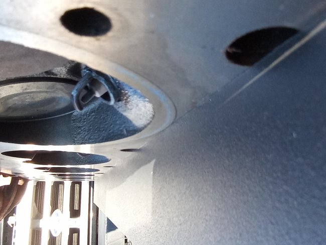

Okay, so, I got a new head gasket, reinstalled the cylinder head, and torqued it down. I am still having the same problem. I cannot build pressure in the #1 cylinder. Initially, I thought it was leaking thru the gauge, so I took it out and installed the spark plug; still, same.
It must be leaking through the valve.

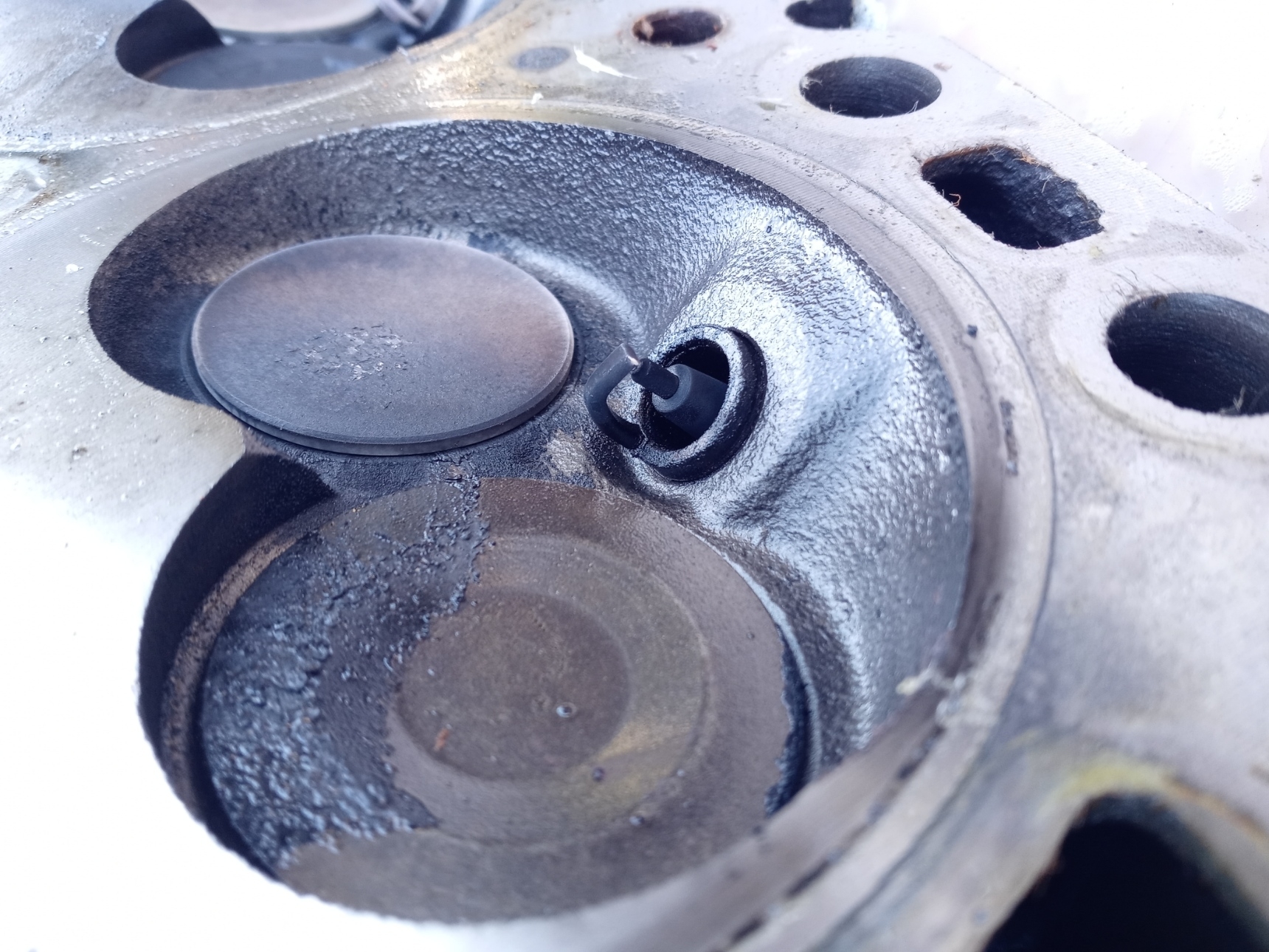

I am not getting compression on the number one cylinder after reinstalling the cylinder head with a new head gasket and spark plug fully installed. When I manually turn the crankshaft, I hear air escaping from somewhere.
That last picture is of the number one cylinder before I reinstalled the cylinder head.

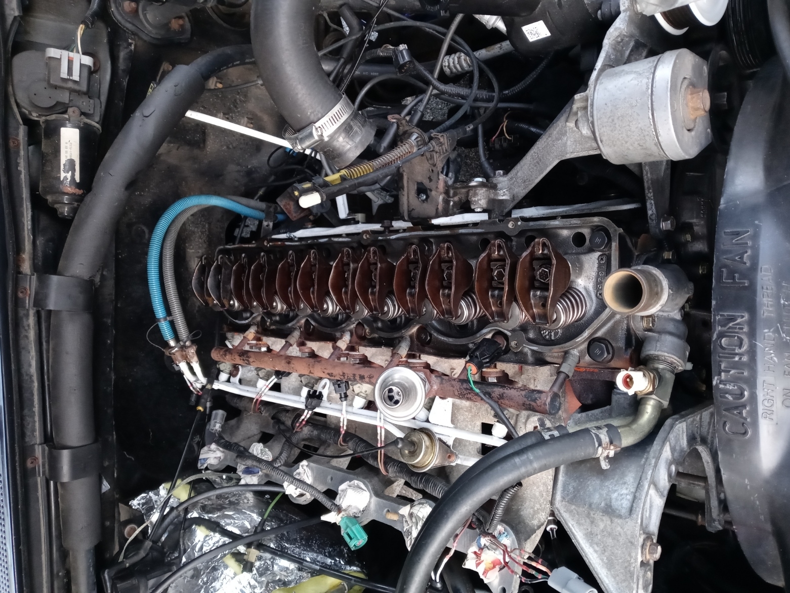

This is how the engine sits right now in my driveway.
Wednesday, November 3rd, 2021 AT 2:37 PM
  • 110,192 POSTS
It looks new. Does the cylinder create any compression? If you test it by placing about a tablespoon of oil in it, does the compression increase?
It's hard to tell looking at a pic, but are any of the valves even open in the pic?
Wednesday, November 3rd, 2021 AT 5:14 PM
