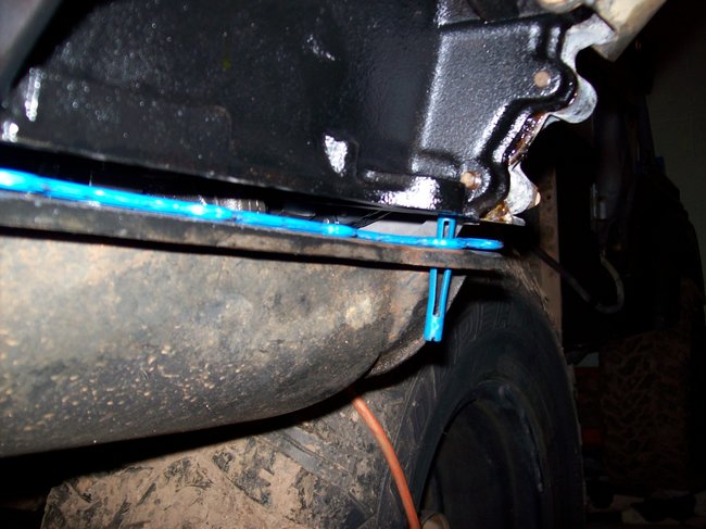

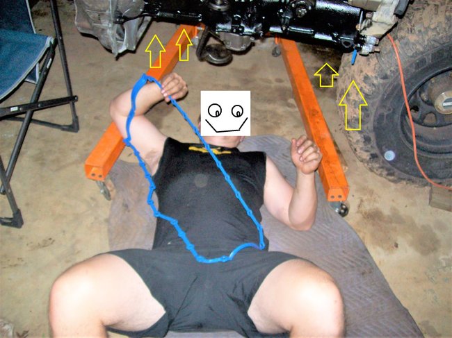

Since that post, I was able to get a couple of pics of this new type gasket!
It's so neat! It's all one piece, unlike the original 4 piece (2 rubber ends and 2 cork strips)
It goes on so much faster and neater.
Four studs temporarily replace the four larger pan bolts.
The gasket "pops" over these 4 studs, then the pan itself pops over them.
Everything is held perfectly in place while the smaller pan bolts are installed.
Then the 4 plastic studs are removed and the 4 larger bolts are re-installed.
You are done!
Two new pics below.
Like I said, the whole post I linked you to is very informative, but I have steered you more towards what you originally asked for.

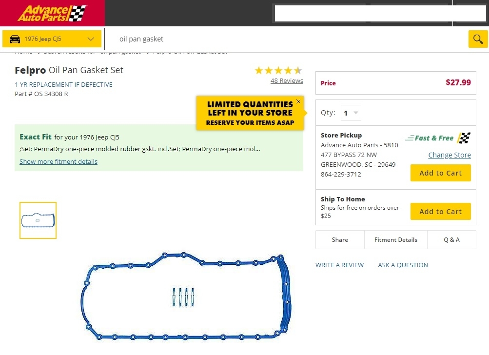

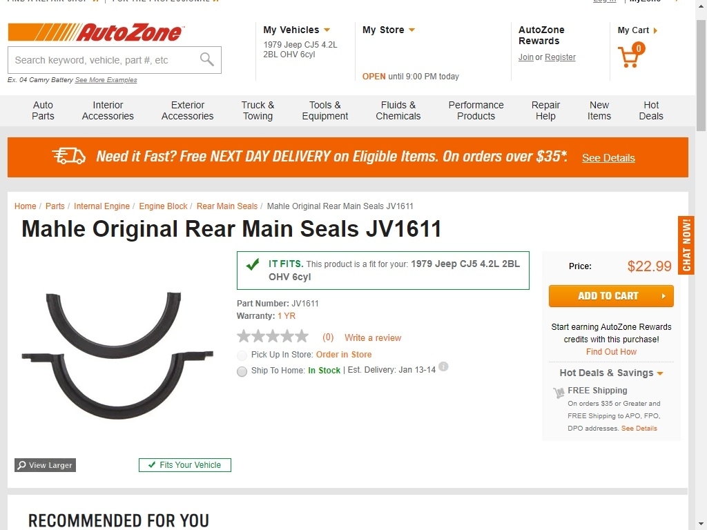

Okay, so all of that reading aside which was informative but long. I got the part number for the oil pan gasket but I did not see one for the rear main seal or the oil pump. I have found a few on my own but I want to be sure to get the best. I do not want junk installed on my jeep. And a lot of these box stores sell junk. Not to mention I know the rear main is a 2 piece and advanced has a one piece listed.

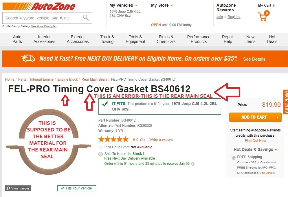

Here's 2 rear mains from AutoZone.
Typing is wrong on the 2nd one (this same one is also available at "Amazon") This one is praised more than black rubber one.
I thought I had posted this last one already- seems you have seen it.
The oil pump will come with a gasket.

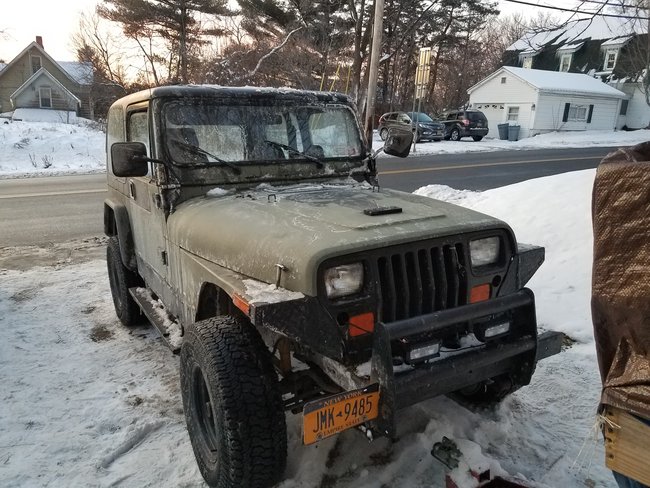

Yes, I am considering a high volume oil pump. This is my daily driver now so it needs to last. Picture for viewing pleasure and for those that will eventually read this and look at the photo and say this is not an 85 cj7 it is a yj well you are only half right. The body is the only yj about this Jeep.

Glad to help!
Thanks for the pic, you have done a super job making it look good!
