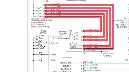

MIKEM61
  • CHRYSLER TOWN AND COUNTRY
Last week the blower motor quit working on all speeds except high. Any suggestions?
Saturday, February 27th, 2021 AT 10:14 AM (Merged)
KHAOS
  • 5 POSTS
Replace the blower motor resistor approx $25.00 it's located behind the glove box ( open the glove box and push on the thin plastic sides and it'll fall wide open and then un clips) you need a 1/4 inch bold driver and you'll see a rectangled shaped plastice piece and two harnesses connected to it remove it and replace
if the motor is bad the new resistor will go again right away but it's the easiest and cheapest starting point
