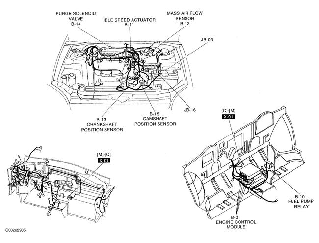

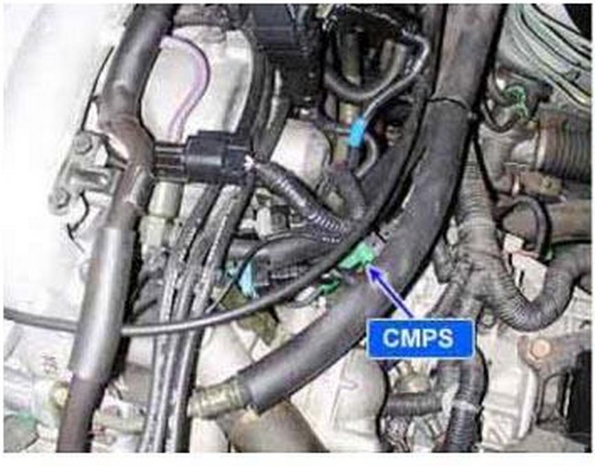

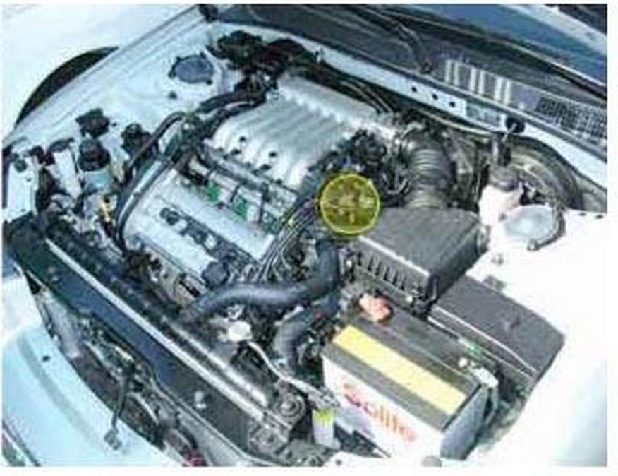

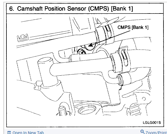

Rear bank of plugs do not fire. Engine tester said rear cam sensor failure. I have not been able to find the location of the sensor.
Jan 23, 2018 at 6:58 AM
MHPAUTOS
  • 31,937 POSTS
Not a great pic but i hope this helps, Check out the diagrams (Below). Please let us know if you need anything else to get the problem fixed.

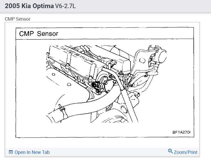

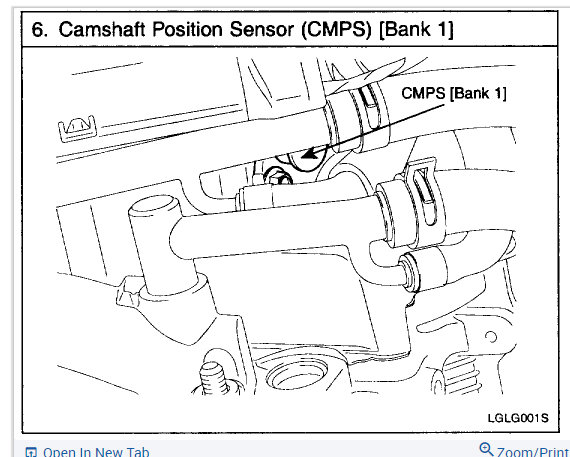

Where is the camshaft position sensor located on my engine? I cannot seem to find anything that looks like the camshaft part
Jan 8, 2021 at 3:59 AM (Merged)
CJ MEDEVAC
  • 11,004 POSTS
It is mounted on the rear of the cylinder head
See the guide below, it will help. Not vehicle specific but it will give you a good idea of what you are in for
https://www.2carpros.com/articles/camshaft-angle-sensor-replacement
See diagrams below for location

It is mounted at the rear of the cylinder head.

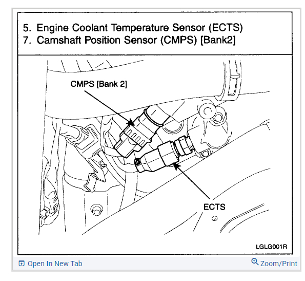

ISAAC HARMON

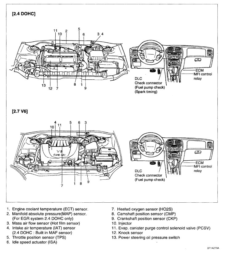

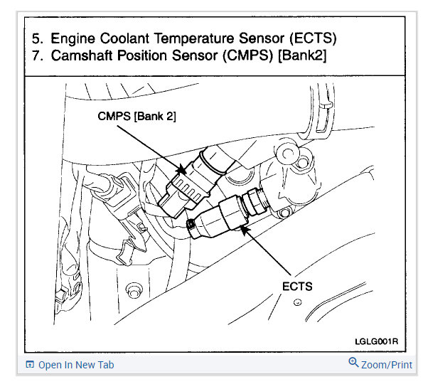

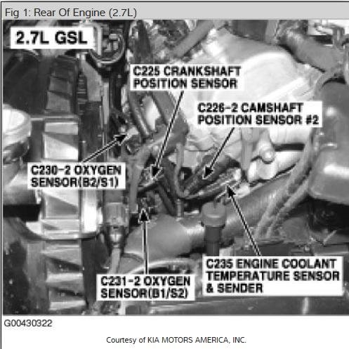

I am not sure if there is more than one sensor because they had a left and a right one so I bought both. I could use some help with the locations for both or if there is only actually one I will return the one I don’t need. Thanks for any advice or help in advance.
That is correct. You have one for each bank of cylinders. Attached is the location views for both sensors. Let us know if you need more info. Check out the diagrams (Below). Please let us know if you need anything else to get the problem fixed. Thanks

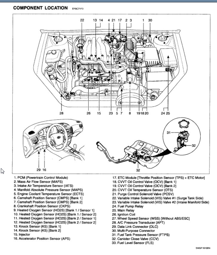

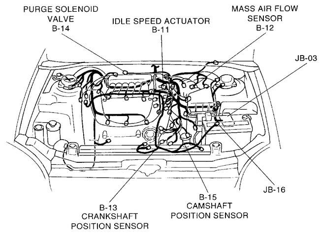

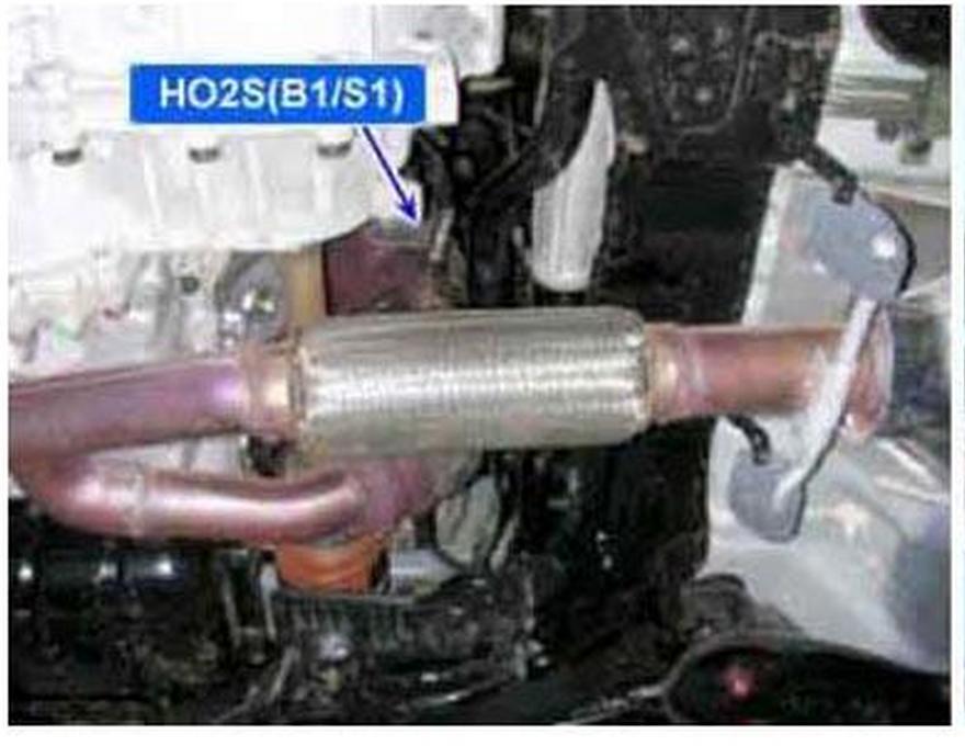

MACKBOLAN357

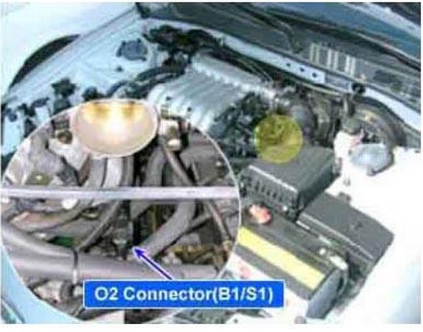

Went to AutoZone because CEL came on scanned for codes (P0340-Camshaft Sensor), and P01360 Heated 02 Sensor Bank 1 Sensor 1).
I know I can replace the 02 sensor, have the tools, just looking for confirmation on location of items.
02 sensor Bank 1 sensor 1 location is passenger side near firewall on exhaust manifold pipe. Correct?
Camshaft position sensor on this engine is hard to find. Can someone provide illustrastions/or pics as to where exactly it is?

KHLOW2008
  • 41,814 POSTS
Here is a guide to help you step by step to change it out with diagrams below to show the location of the sensor for your car.

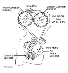

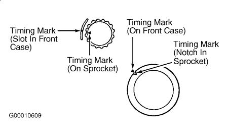

LWARCOX
how do i ensure the blades on the exhaust cam are located in the proper position for the camshsft positioner is timed correct?
DAVE H
  • 13,384 POSTS
Removal CAUTION:To prevent engine damage, DO NOT rotate crankshaft counterclockwise (as viewed from timing belt end of engine). Disconnect negative battery cable. Remove drive belts and drive pulleys from crankshaft and water pump. Remove timing belt covers. To align timing marks, rotate engine clockwise so No. 1 cylinder is at TDC of compression stroke. Ensure camshaft sprocket timing marks align with upper surface of rocker cover. Dowel pin of camshaft sprocket should be pointing upward. See Fig. 1 . Remove timing belt auto tensioner. If reusing timing belt, place mark on timing belt to indicate direction of belt rotation. Remove timing belt. Remove camshaft sprockets. Remove plug at left side of block, and insert a screwdriver to hold left counterbalance shaft in position. Screwdriver will have to be inserted at least 2.36" (60 mm). Remove oil pump sprocket nut and sprocket. See Fig. 2 . Loosen right counterbalance shaft sprocket mounting bolt. Remove tensioner "B" and timing belt "B". See Fig. 2 . Remove crankshaft sprocket "B" from crankshaft. Fig. 1: Identifying Timing Belt Alignment Marks

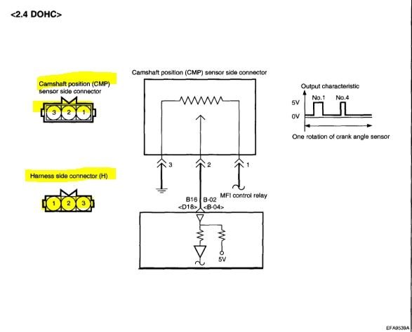

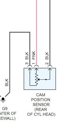

I've replaced the crank sensor, IAC, IFS, camshaft sensor, fuel pump relay, fuel pump, EVAP canister. Car was running fine then cut off on me a couple of times. Check engine light came on code P0340. got another cam sensor OE and the connector because it fell apart. Now car starts run about 3 to 5 seconds and cuts off. turn the key restarts and does the same thing. Still shows code P0340. New connector had all white wires I have pink wire on top, black ground in the middle, and signal wire on the bottom when plugged into sensor. I need help. Did I wire it up wrong?
  • 110,211 POSTS
Welcome to 2CarPros.
Interestingly, there are two black wires and one pink. Why they would use black two times in the same plug is beyond me.
With that, take a look at picture 1. It shows the plug and indicates what each pin is for. Pin 3 is ground. Check for continuity to confirm.
Pin 2 is for the pink wire. Pin 3 is for the FI relay.
