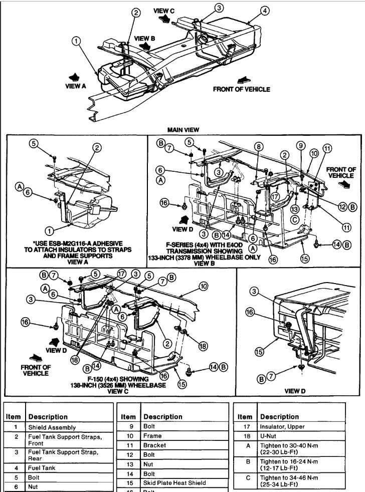

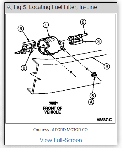

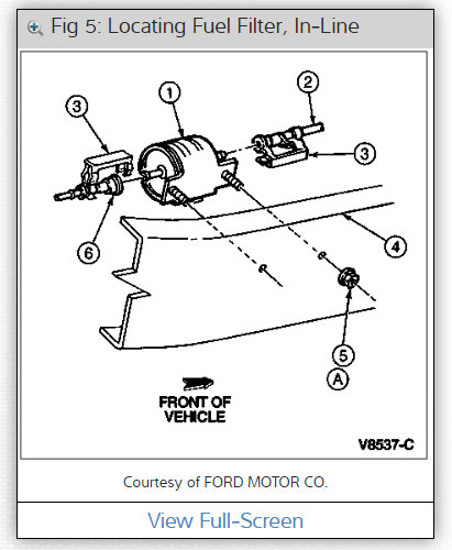

I have seen this problem on these trucks the switching valve for the tanks going bad causing the engine to stall I would change the fuel filter fist though. Here is a diagram to show you what you are in for when changing the filter out. If you are short on funds you can bypass the valve and just use the one tank should be okay.
https://www.2carpros.com/articles/how-to-change-a-fuel-filter
Check out the diagrams (below). Please let us know what you find.
