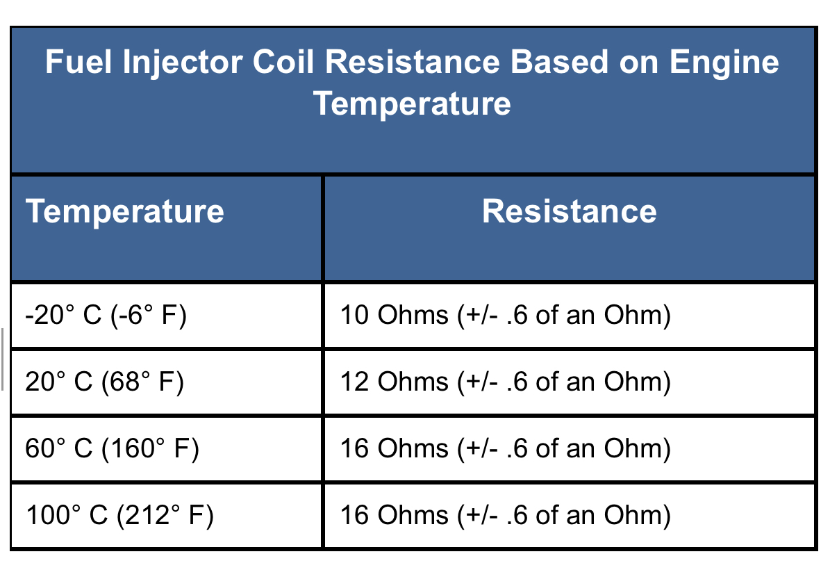

How can I tell if the injector has gone bad?
Monday, November 4th, 2019 AT 8:51 AM
MASTERWRENCH
  • 258 POSTS
The best way to test an injector is by measuring its resistance. Attached is a chart from the service information indicating what the resistance value should be at varying temperatures. You should be looking at a value somewhere around 12 ohms.
Take a look at the article below for a more detailed procedure for how to test a fuel injector.
https://www.2carpros.com/articles/how-to-test-a-fuel-injector
+1
Monday, November 4th, 2019 AT 10:18 AM
