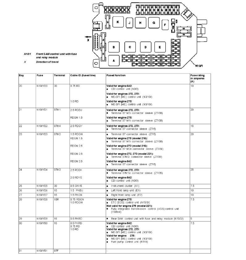

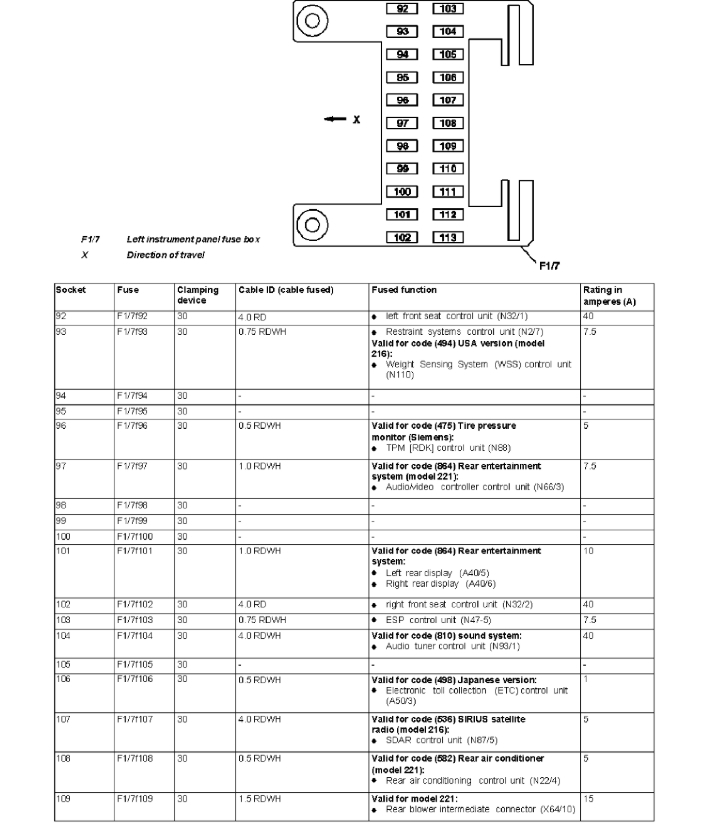

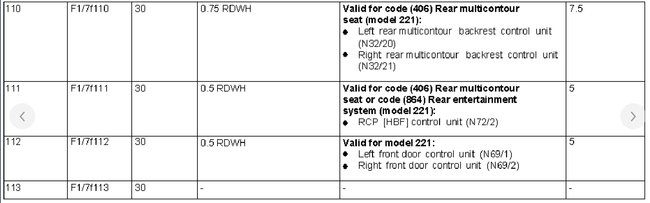

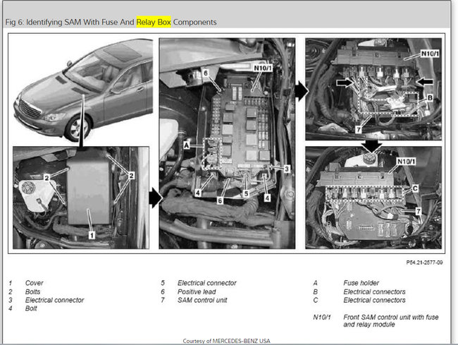

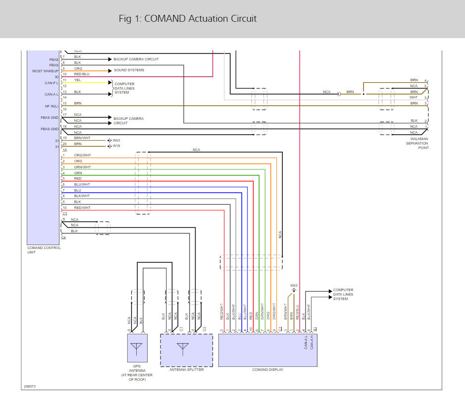

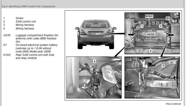

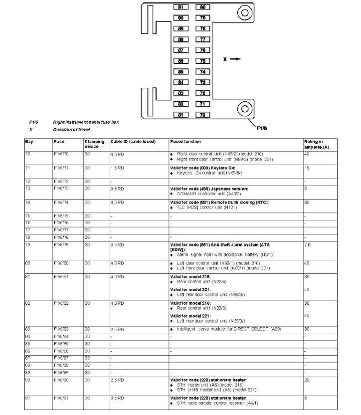

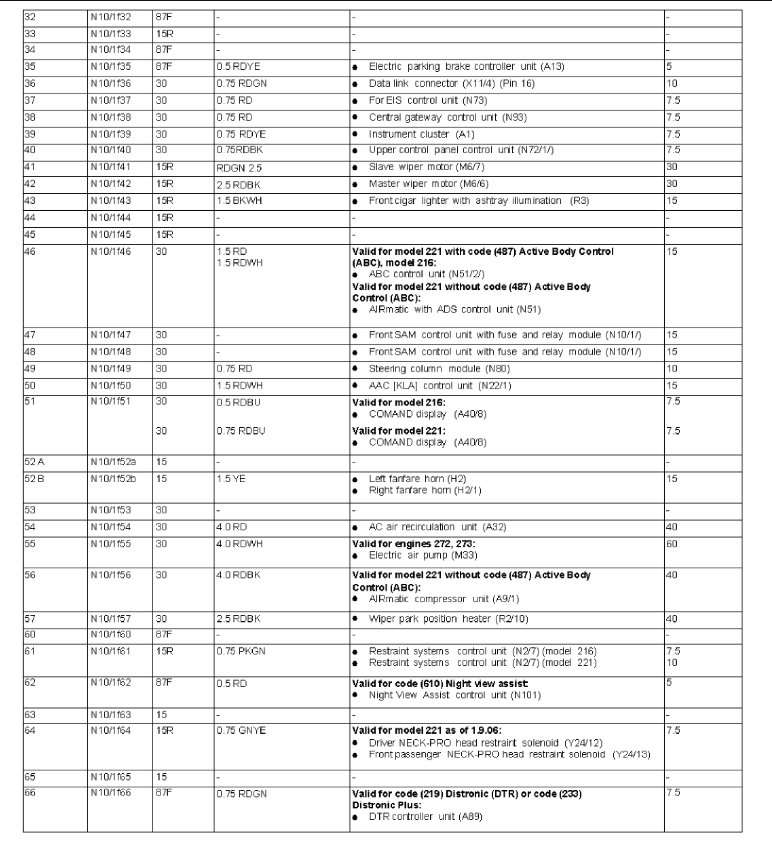

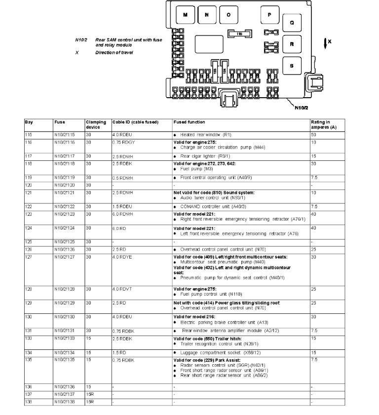

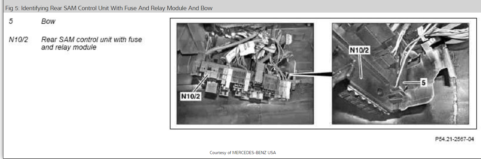

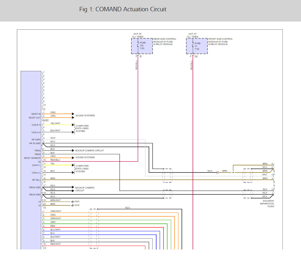

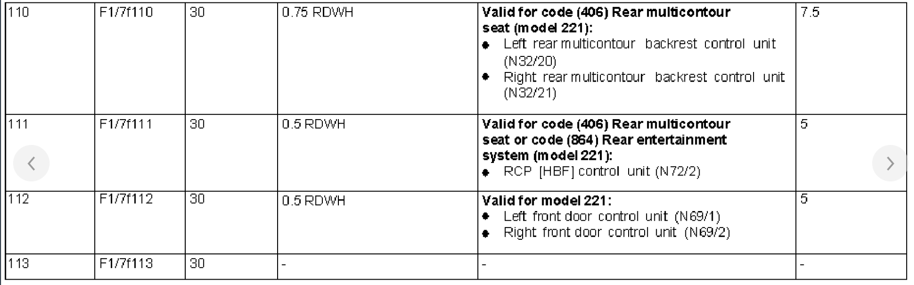

It sounds like you have a command controller that is out or fuse # 122 in the rear SAM or #51 in the front SAM. Here is a guide to help you check and the fuse box locations as well as the wiring diagrams so you can see how the command system works:
