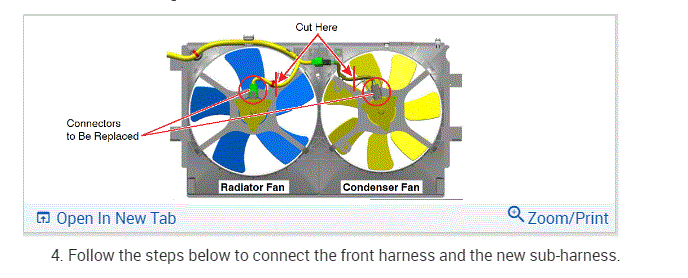

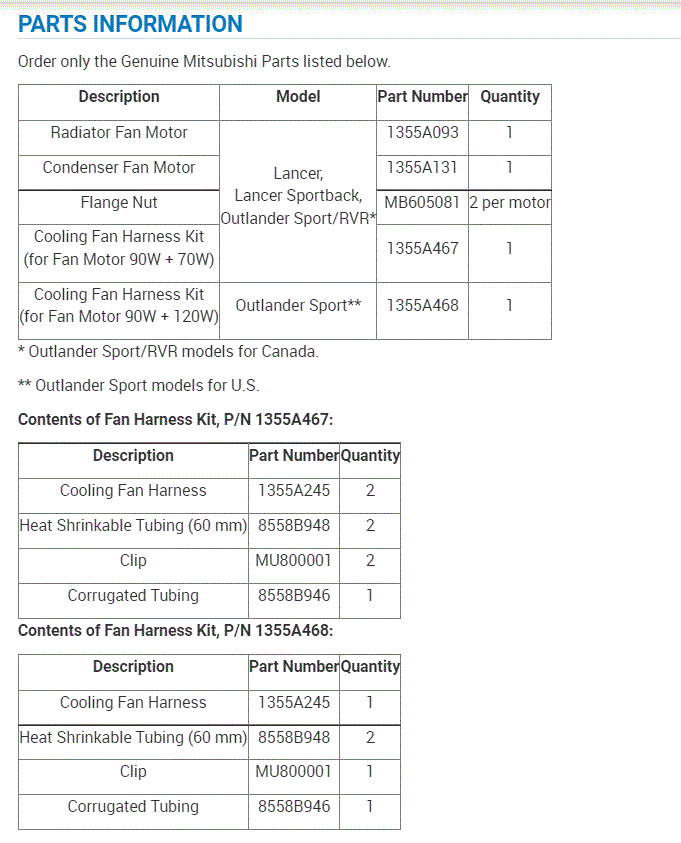

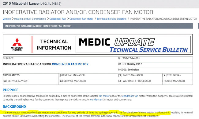

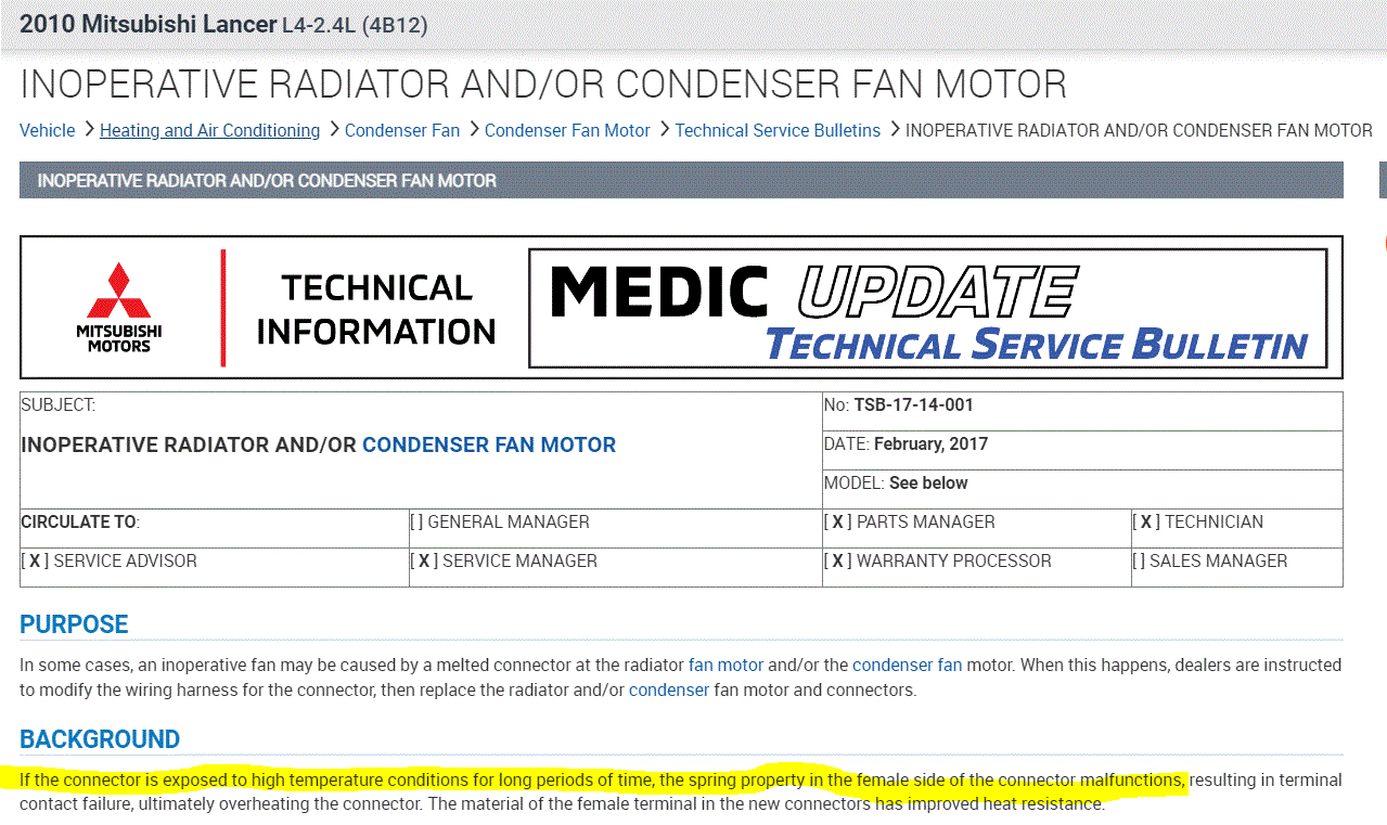

Sorry, I should’ve been clearer. The wiring is not frying, the plastic on the pigtail is melting because the area is getting so hot.
Okay, that makes sense. Jake, I was a bit concerned and didn't want you to have something like a fire resulting from an electrical issue. Make sure to keep an eye on the connector.

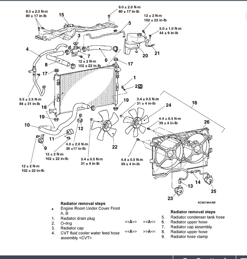

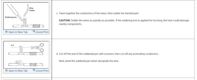

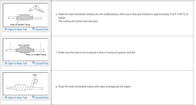

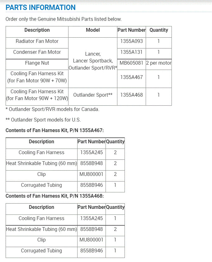

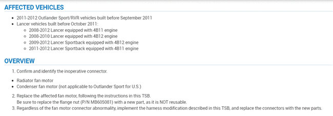

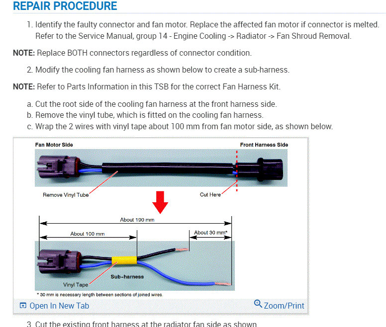

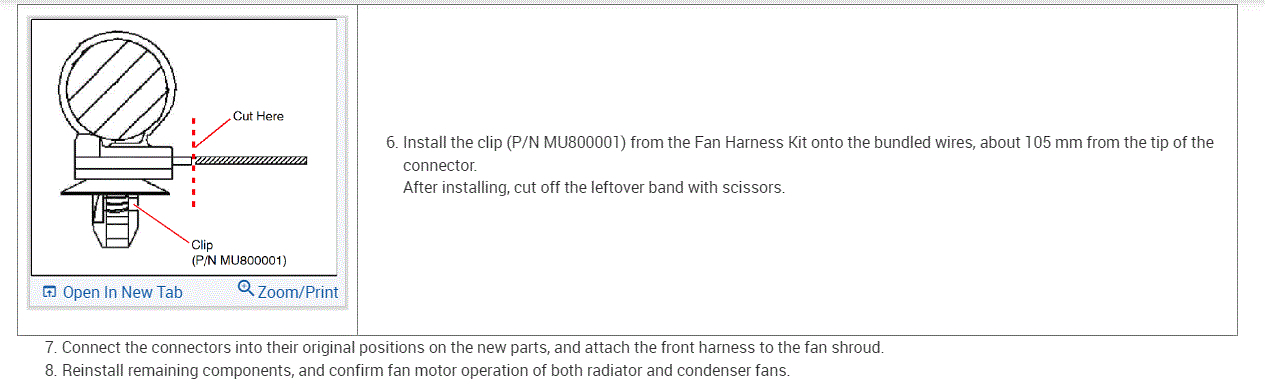

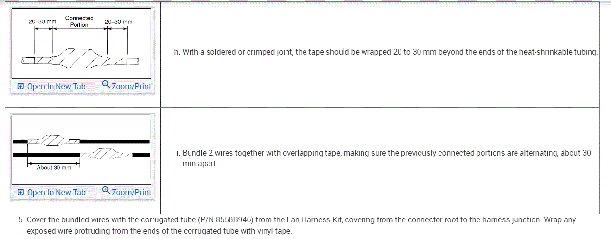

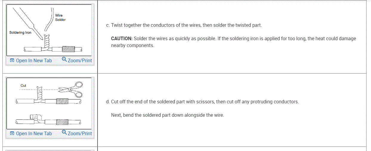

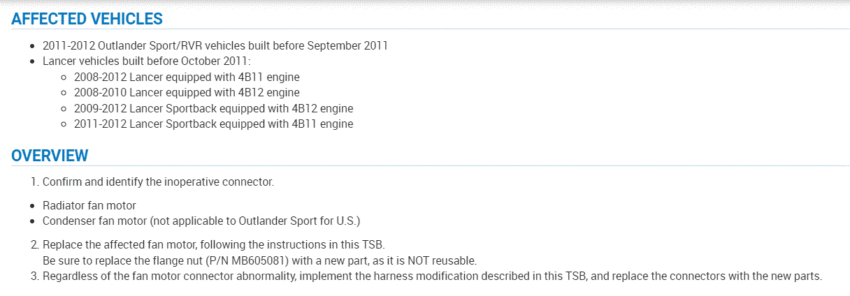

I did research on the topic of inoperative cooling fans. I found something of interest. in 2017 there was a technical service bulletin sent out specific to the harness you are having issues with.
Do me a favor. Read through the TSB that I attached below. If I'm understanding it properly, the harness connector melting causes an internal problem in the connector itself. I think that is what you are dealing with.
Let me know your thoughts.

Jake,
Was the wiring harness from eBay replaced? According to the TSB I sent, that is where the problem comes from.
If it were, we would need to go back and start tracing where power is being lost. Also, the engine coolant temperature sensor could be faulty. If you have a live data scanner, see if the signal from the sensor is bad.

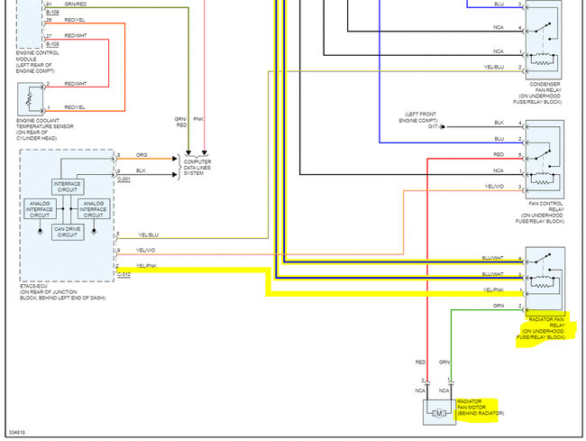

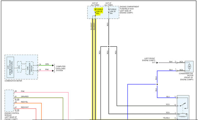

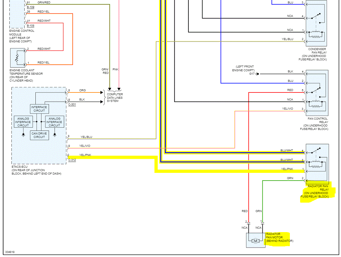

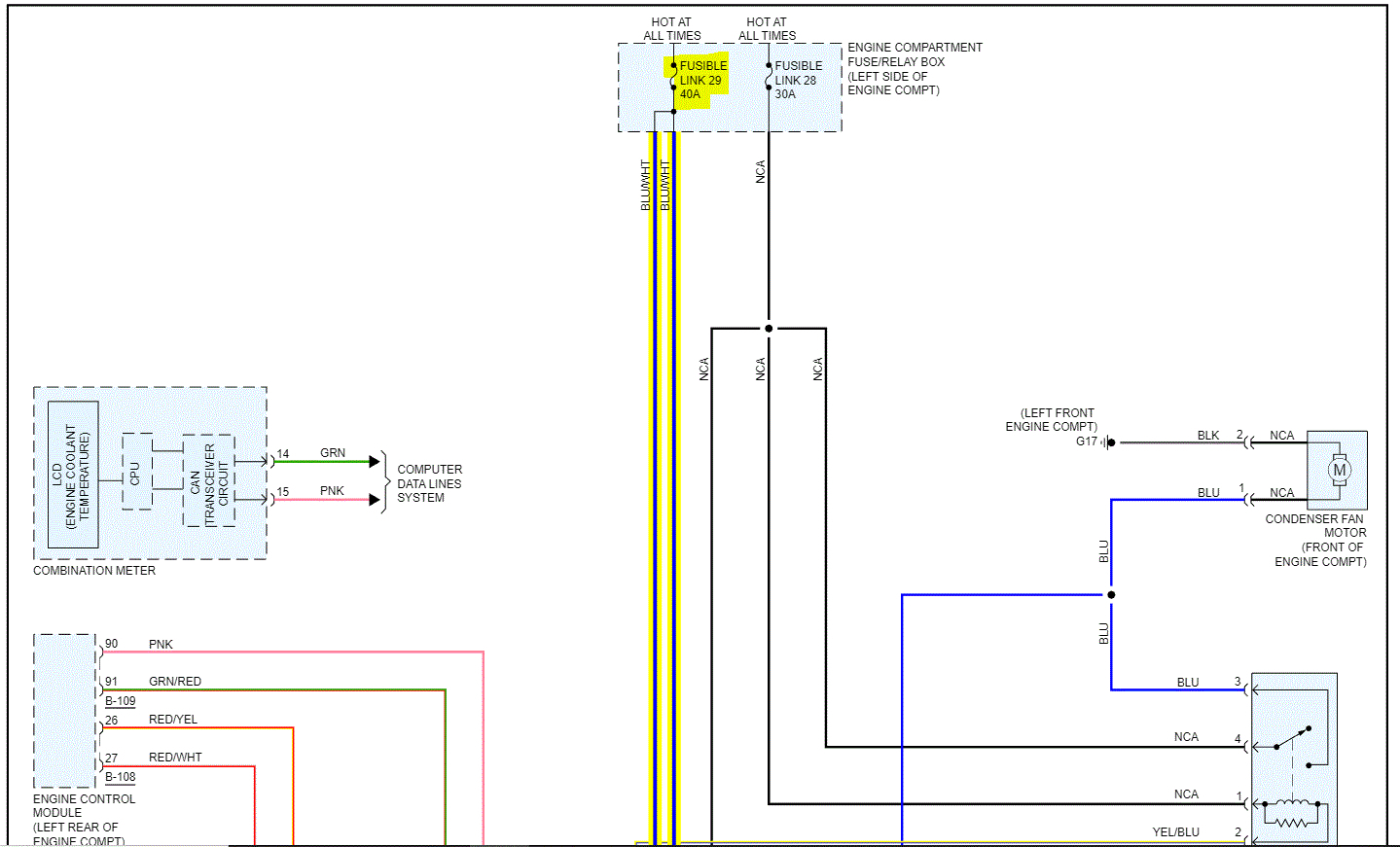

Do me a favor. Check fusible link 29 has power on both sides.
I attached the wiring schematic below and highlighted the wiring and fuse.
Here is a link that you may find helpful:

I just noticed something, when I jumped the relays, I dont think I turned the car all the way on, just the battery. thus if the engine is not on, the one working fan has not come on, so the other wouldn’t either. Hopefully that makes sense.
Jul 12, 2022 at 5:08 PM
Yes, that makes sense. The key needs to be in the "run" position with the engine not running. If you jump the relay, it should turn the fan on. If it doesn't, we have a wiring issue between the two components because I remember you replaced the fan motors.
Let me know what you find.
