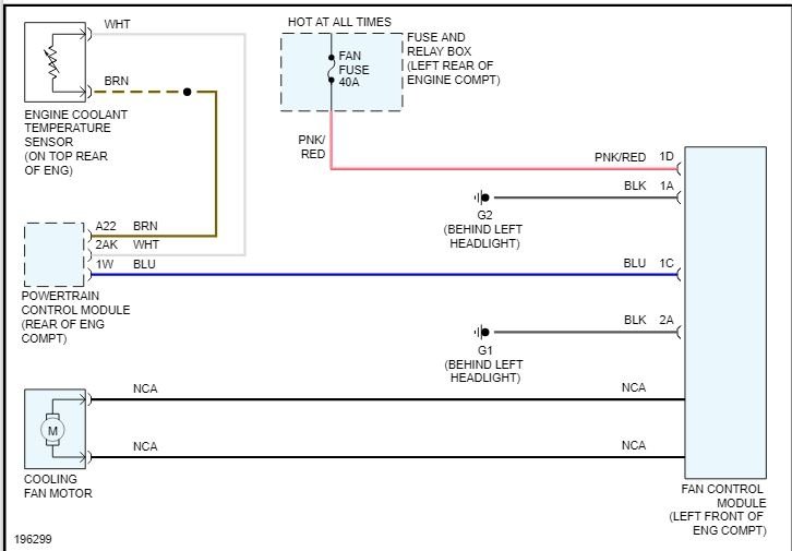

Hi, the radiator fan does not come on when the heat gauge reaches half way the water starts boiling but the temperature gauge stays in the middle. I was told that it was a faulty temperature sensor which I replaced. The fan still inst working, however if I unplug the temperature sensor the fan works from start up. The fan also works when the A/C is on. What could be the problem?

Fan will default to on with no signal from the sensor, the only other item would be the fan control module. I only have a location as being at the left front of engine compartment. The PCM is also involved in this circuit, but I would suspect the control module, a dealer scan will show if this module is faulty.

Hi Guys, I had the entire fan replaced and it still did not work(dealer diagnosis), I took it to a after market dealer who investigated further as the dealer replaced all components and it still did not work (temp sensor, thermostat, water bottle and cap and then finally the fan ). The diagnosis was that the PCM module on the computer box is not working, so it does not send the signal to the fan to kick in(dealer could not pick this up), I was told to either change the computer box or by pass it by fitting an after market sensor.

Well no control signal from the PCM would definitely cause that. However I'm not sure it's the PCM that is the problem, That is because the fan still turns on when you disconnect the ECT plug, and works with the A/C. Both of those use the same circuitry inside the PCM to turn on the fan. I suppose it could be something on the board between the ECT input and the fan output that is causing that problem.
I would do some testing though just to be sure. It is a simple system as cooling fans go. The ECT sensor tell the PCM the temperature, at 209 degrees the PCM sends a pulsed power signal to the fan control module. That signal keeps getting faster as the temperature rises. The control module gets that signal and uses larger power transistors to pass the pulsed signal to the fan.
I would verify both of the Black ground wires are good.
As the fan does work when the A/C is on the power feed should be OK That leaves just the ECT and the PCM signal.
I would check the wiring to the temperature sensor very close for any issues. It operates using a thermistor which converts a temperature into a resistance. Any added resistance from corrosion or a loose pin can cause a problem.
You say you changed the sensor, how about an odd test. Unplug the sensor wiring and plug in the old sensor. Now just turn on the key and use a small torch or even a candle to heat the old sensor on the area that was inside the engine. What does the fan do?
