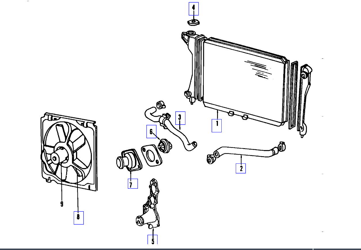

Okay, you are having to add water so that leads me to believe that it is a cooling system leak.I have included an exploded view of your vehicle's cooling system in the diagrams down below. I have also included a couple of links below for you to go to.
https://www.2carpros.com/articles/radiator-pressure-test
https://www.2carpros.com/articles/car-is-leaking-coolant
Please go through these guides and get back to us with what you are able to find out.
