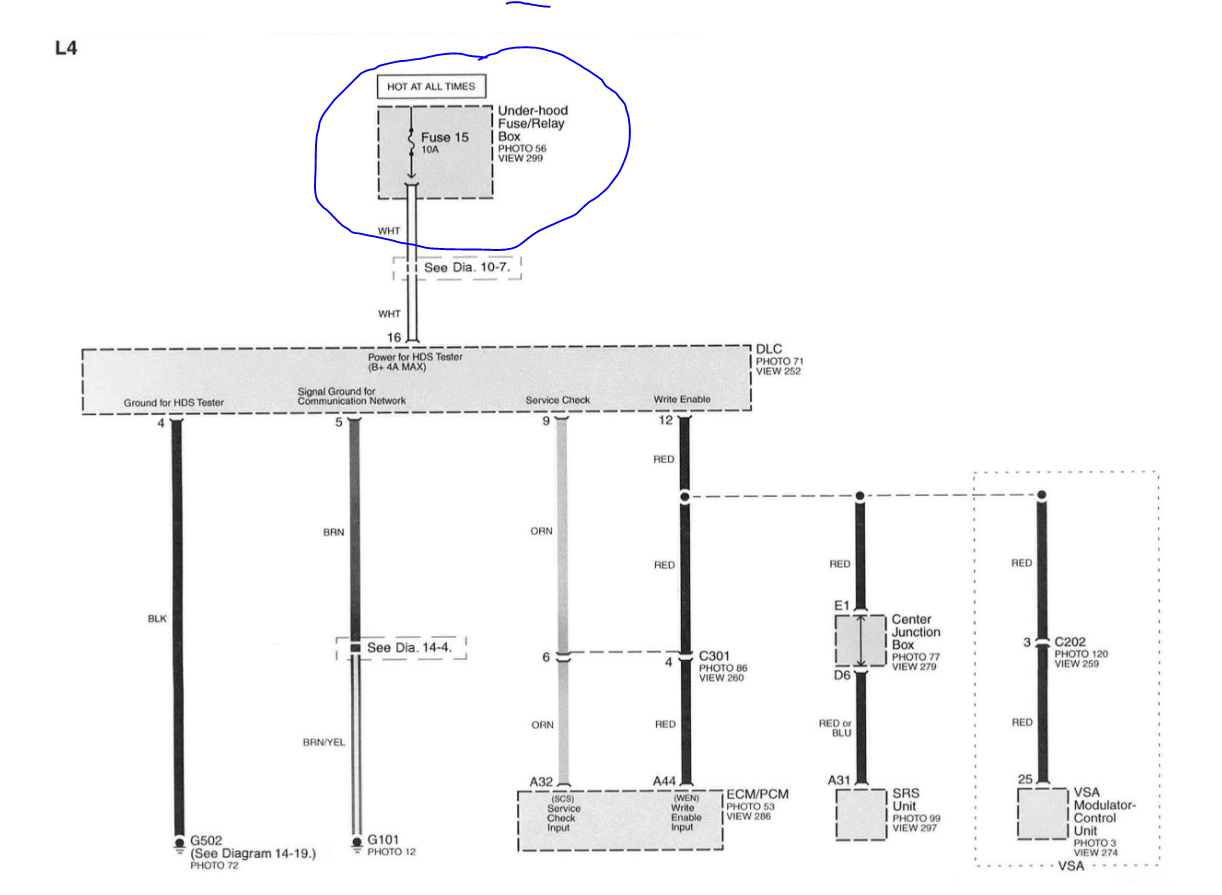

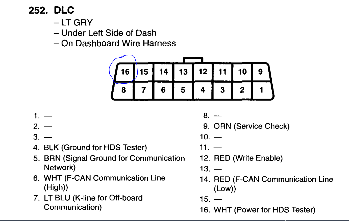

Which fuse works this?
Sunday, December 19th, 2021 AT 7:14 AM
MECHANIC
52,796 POSTS
Good morning,
I attached the connector diagram and a wiring diagram of the data link connector for you to view.
Pin 16 is the power for the scan tools.
Let me know if you have any other questions.
