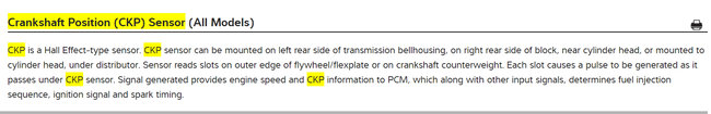

SCGRANTURISMO
  • 4,897 POSTS

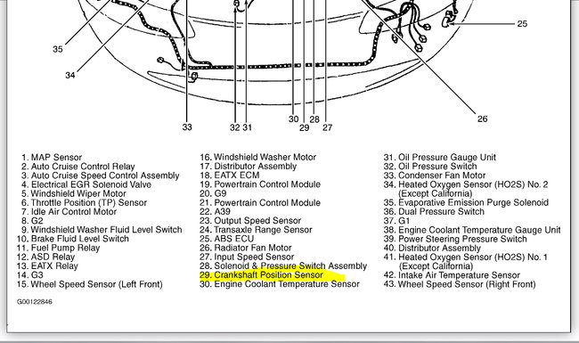

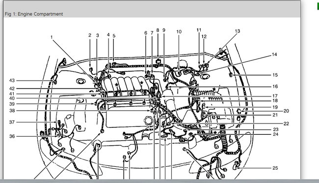

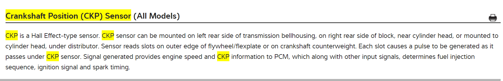

Hello again,
Okay, this is probably going to be a problem with your vehicle's Crankshaft Position Sensor (CKP). In the diagrams down below I have included a description of the CKP and where it is located on your vehicle. Please go through these guides and get back to us with what you are able to find out.
Thanks,
Alex
2CarPros

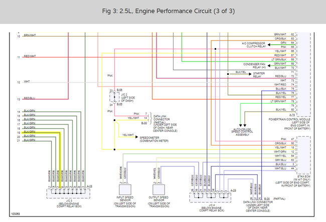

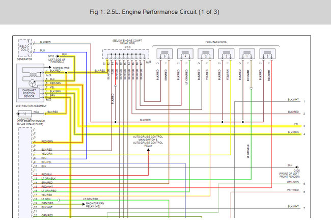

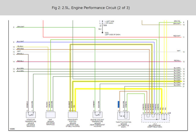

SCGRANTURISMO
  • 4,897 POSTS

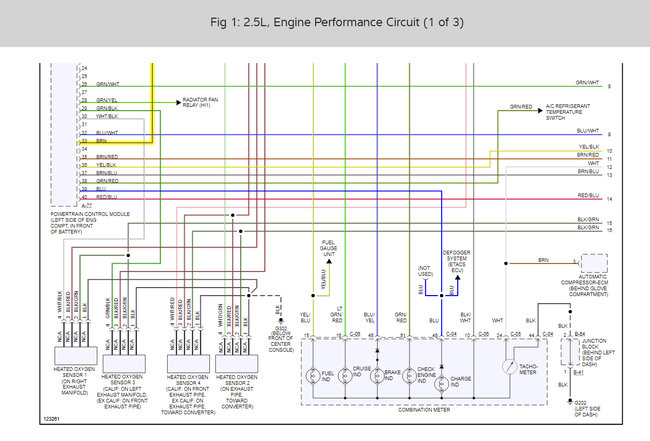

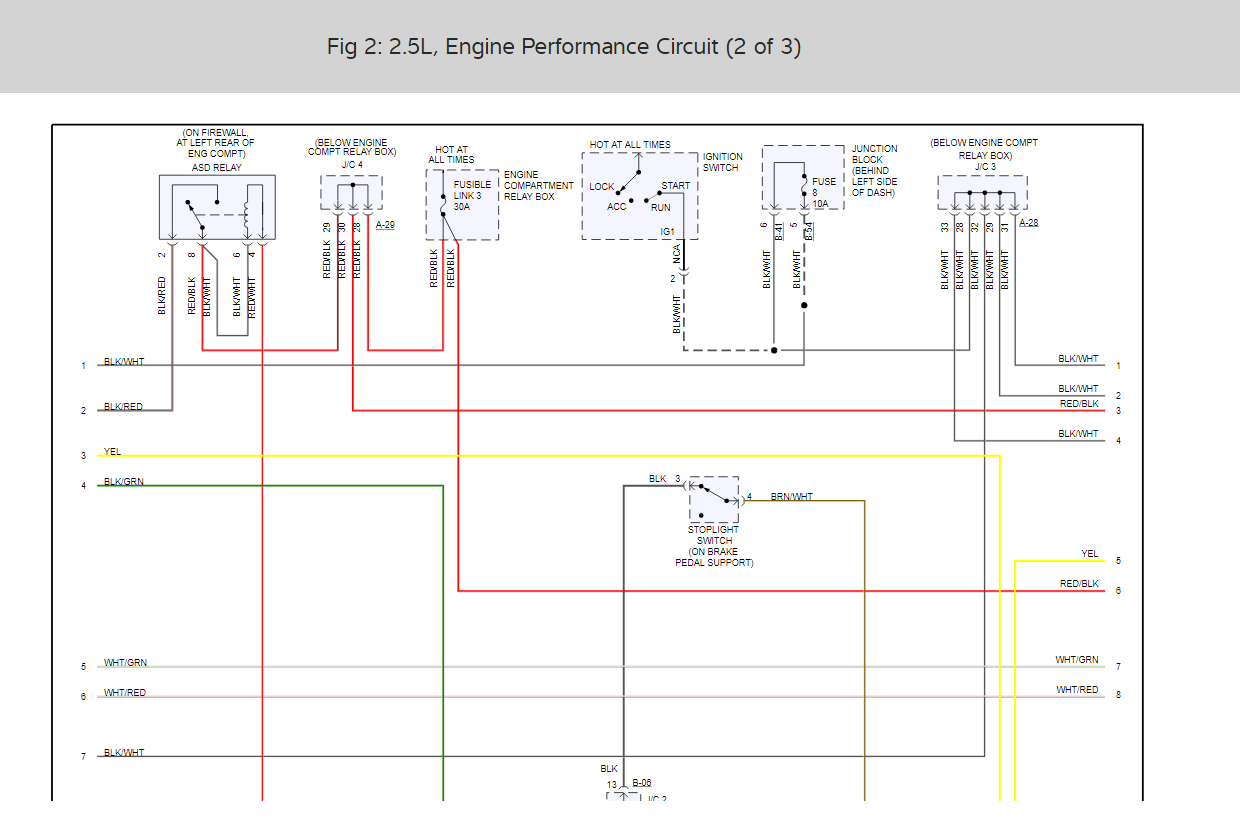

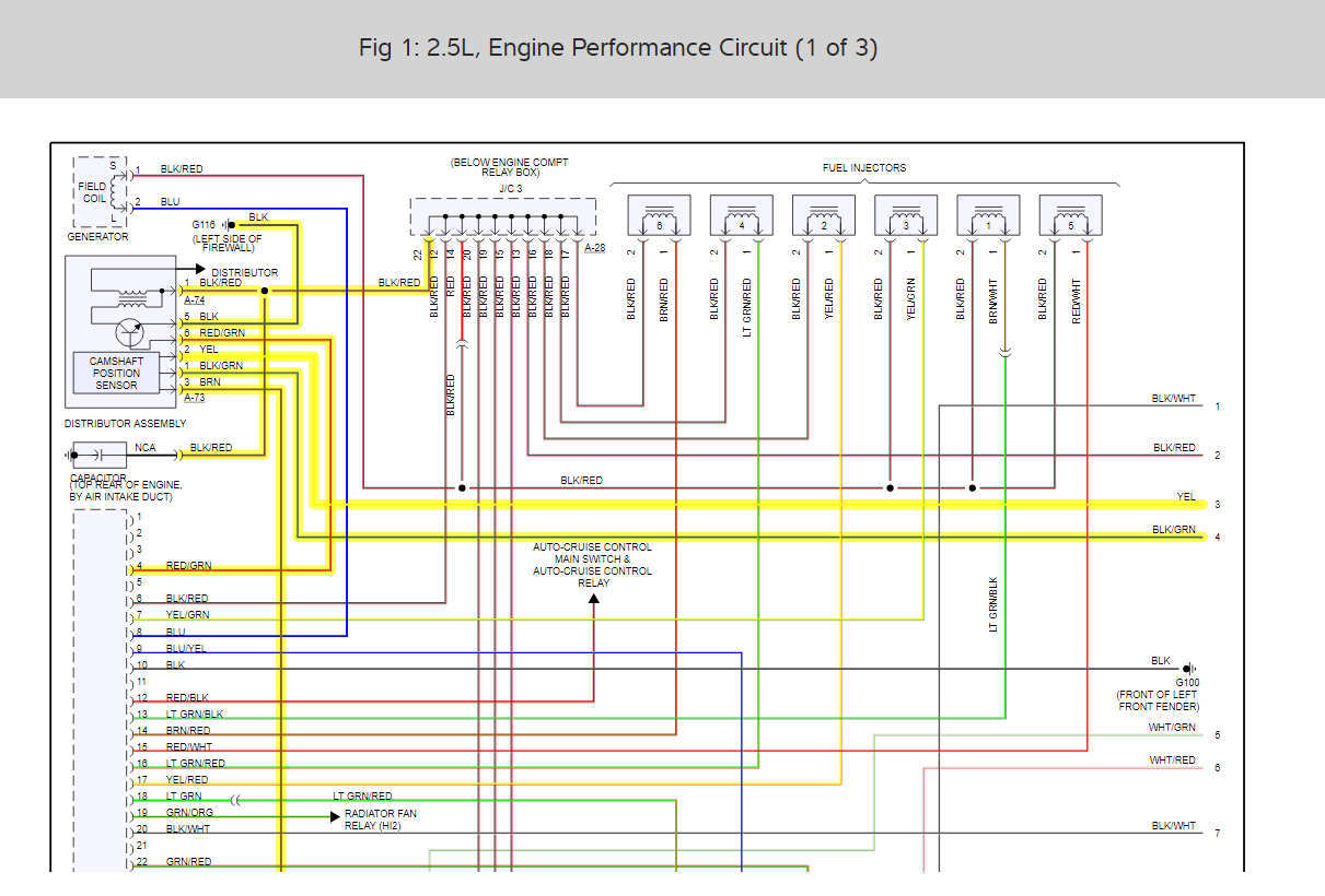

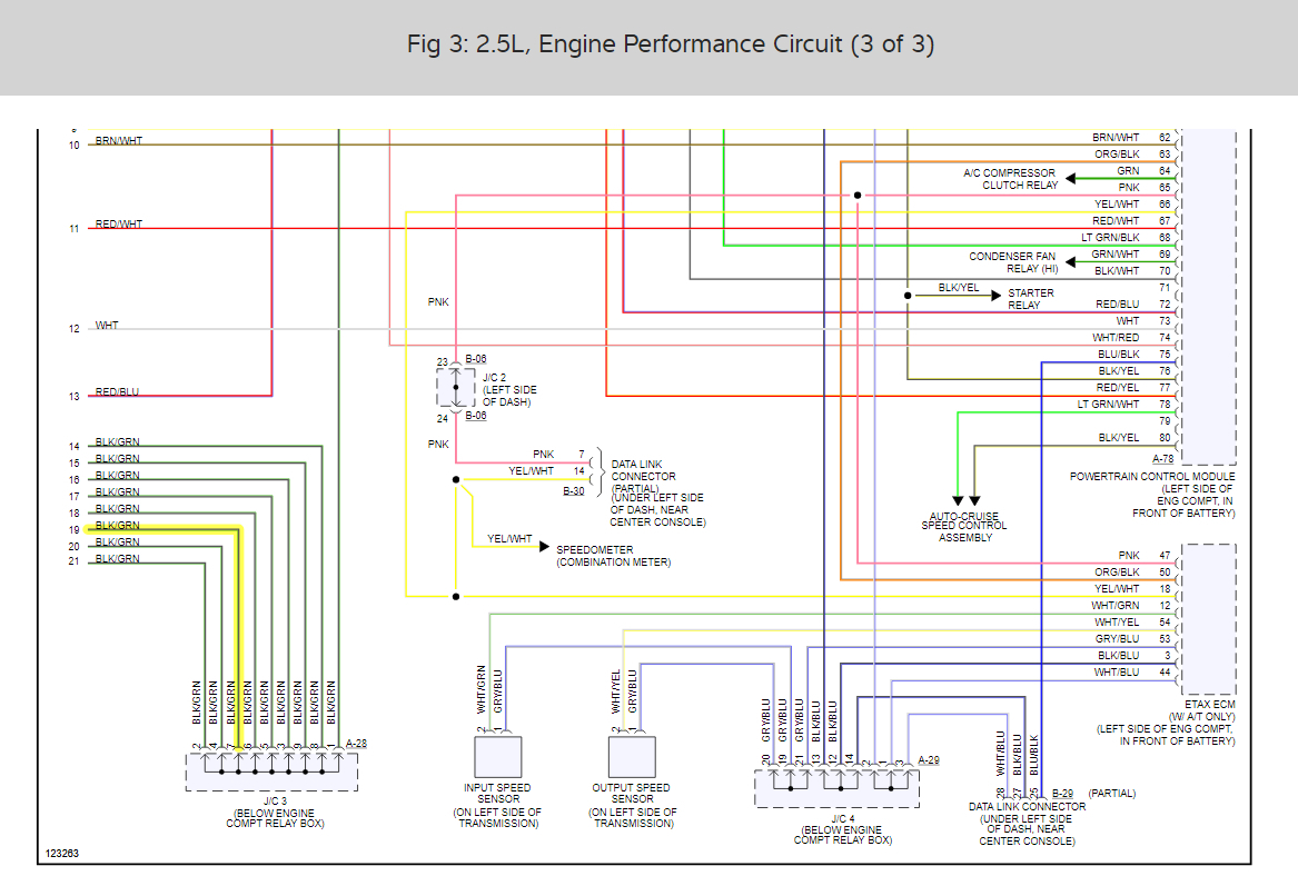

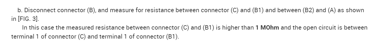

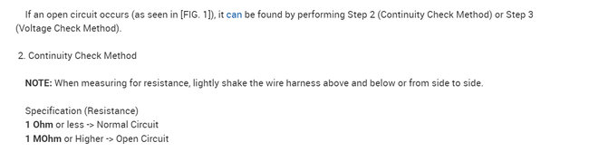

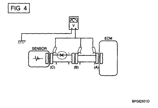

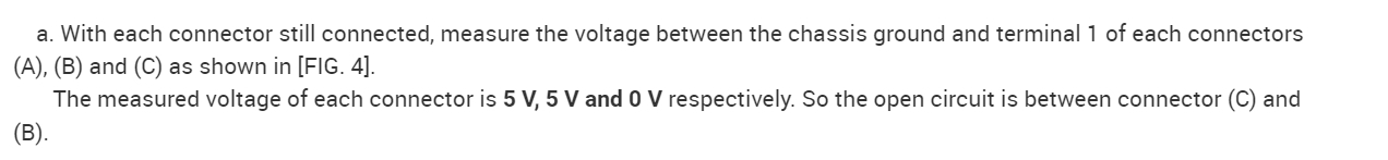

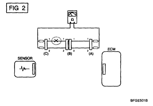

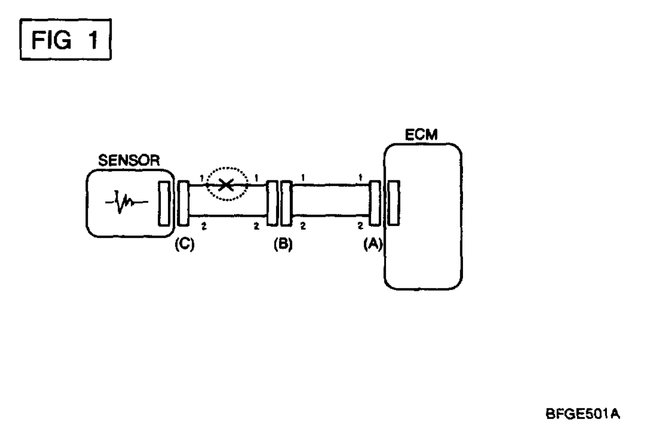

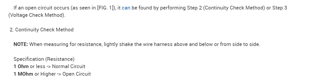

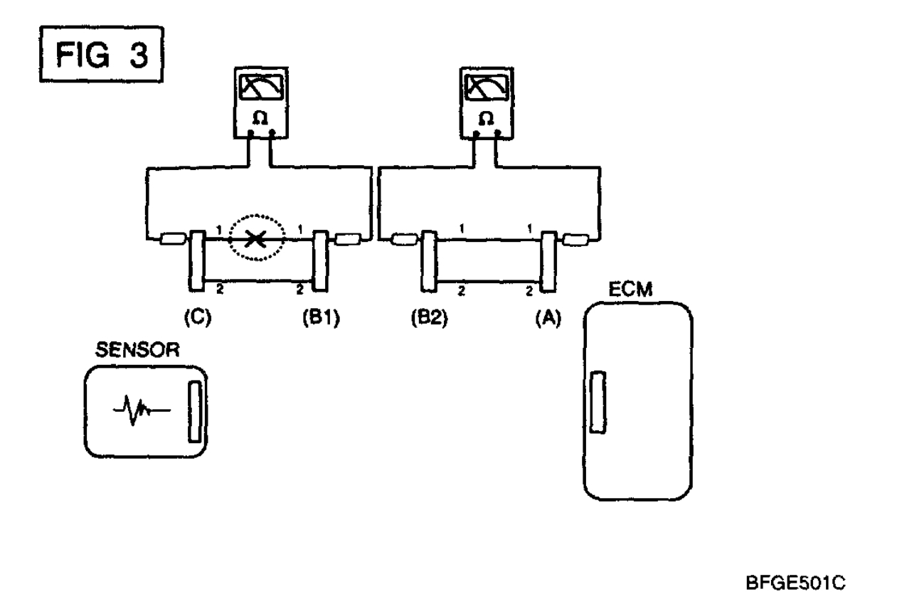

Hello again,
Okay, then you probably have an open or unwanted resistance somewhere in the CKP circuit or the Camshaft Position Sensor (CMP) circuit. In the diagrams down below I have included the CKP and CMP circuit's wiring diagram as well as instructions for finding an open in an electrical circuit. Please go through these guides and get back to us with what you are able to find out. You will need to use a multi-meter, so I have included this link for you below as well if you are unfamiliar with how to use one.
Thanks,
Alex
2CarPros
