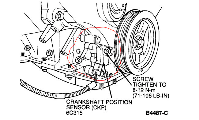

Check to make sure the crankshaft position sensor isn't disconnected or damaged. You could have hit something when removing the radiator.
I attached a pic of it below.

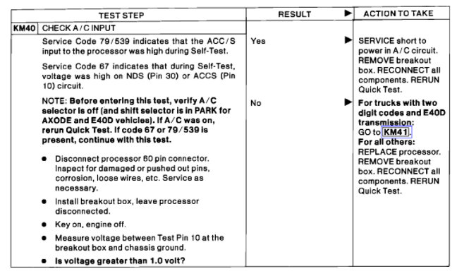

Did the self test for codes today. Getting back these codes. 72,73,74.6,7\
Sep 11, 2020 at 5:13 PM
  • CAR REPAIR CONTRIBUTOR
72 - Failed Dynamic response test MAP sensor
73 - Check TP sensor due to no movement during dynamic response test
74 - Brake on off did not cycle during engine running self test

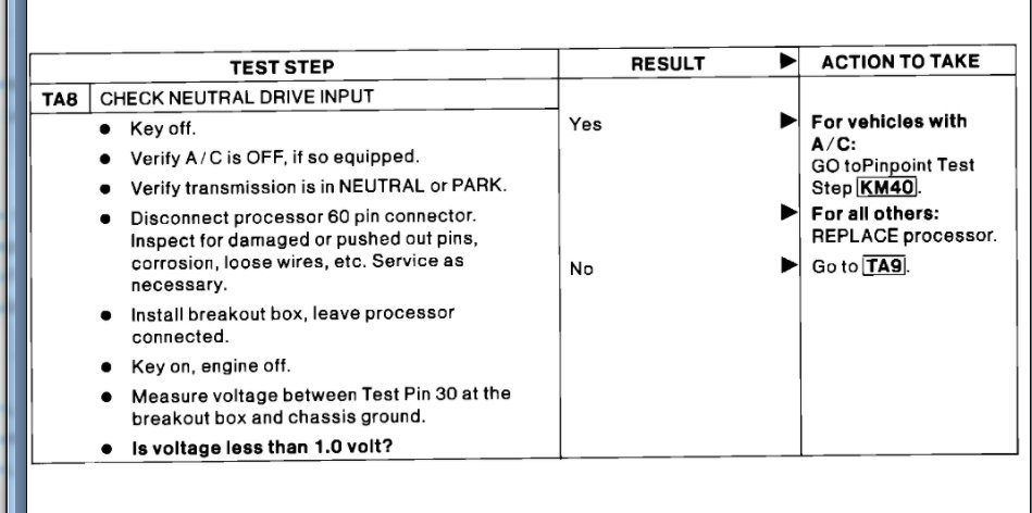

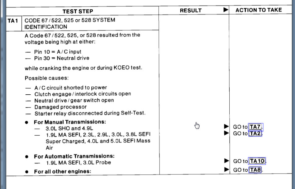

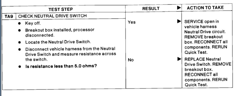

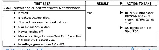

67 - High voltage at Pin 10 AC input or Pin 30 Neutral Drive while cranking or KOEO test.
Let's tackle the 67. I attached the testing for it but if these are all new codes, I suspect you do have something left unhooked or we damaged a wire.

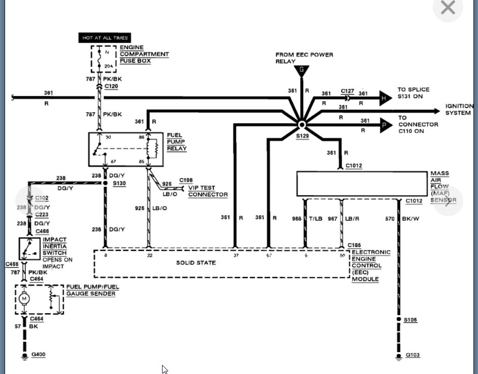

However, we should go to the pump and check power at key on. Clearly I am trying to tie this the repair you made but maybe we have a coincidence. I attached the wiring diagram but you only have one wire and a ground wire so we need 12 volts at the pump when key is on.

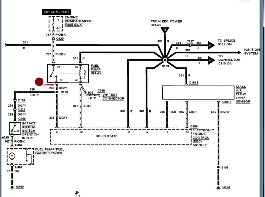

Okay, so I didn't really understand some of that so let just say, i got to the pump there were 4 wires and going from the schematics I've seen dg/y is the hot wire but i may be wrong. Regardless , none of the 4 wires are getting power with the key on or off. i went back and traced my steps and what i did. Even traced the dg/y all the way back to the relay. i'm lost. i did run a wire strait from the battery to the pump and it kicked on.

Okay. Let's go to the relay and remove it. Jump pin 30 to 87. Does the pump come on when the key is on? Then jump 86 to 87, does the pump come on?
Next, let's put the red lead of you meter on the battery positive and then the black lead of the meter on pin 85. Then turn the key on and see if your meter reads 12 volts. This is testing the EEC's ability to ground this relay in order to close it.

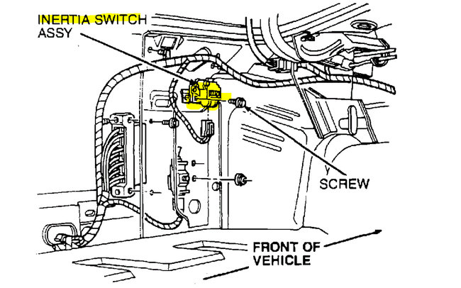

The biggest concern is that you have an accident, there is a fire, and you are unable to cut power to the pump. It's a scary thought, but all cars have a safety default to shut fuel down. This eliminates that safety feature.

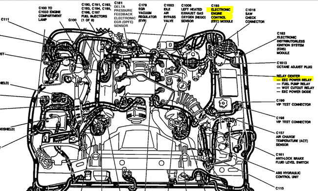

I have to refresh. Did you check the EEC relay, EEC power relay, and the inertia switch in the trunk? See attached pics.

That is great. The reason the relay is not working is either you are not getting power on the other side of the relay (pin 86) or the PCM is not grounding it (pin 85). Take a look at the wiring diagram and you will see that pin 85 is connected to the PCM.
The way to test this is to remove the relay and put your red meter lead the positive battery terminal. The black lead of your meter on the terminal 85 of the relay. Then turn the key on. If the PCM grounds this circuit, your meter will show 12 volts.
Then check for power on pin 86. Simply put the red lead on pin 86 and the black lead of your meter on ground and turn the key on. You should have 12 volts.
