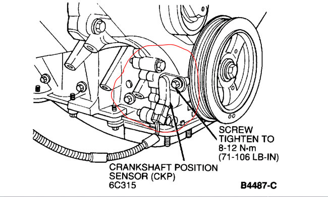

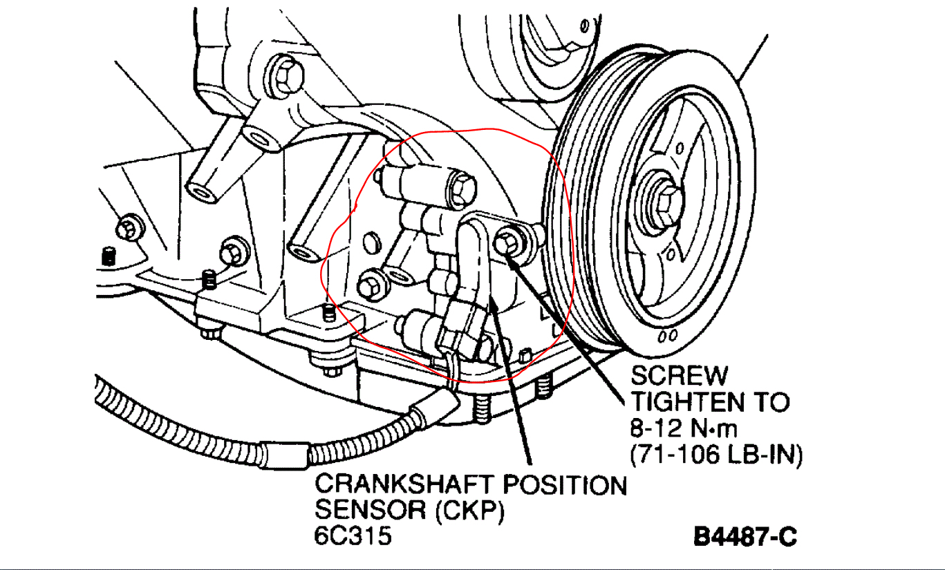

Check to make sure the crankshaft position sensor isn't disconnected or damaged. You could have hit something when removing the radiator.
I attached a pic of it below.

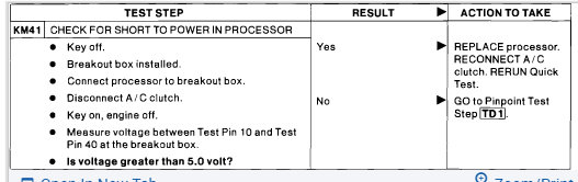

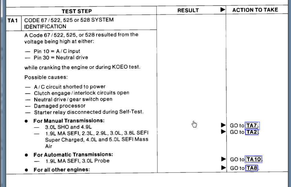

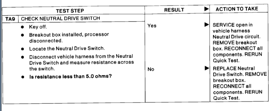

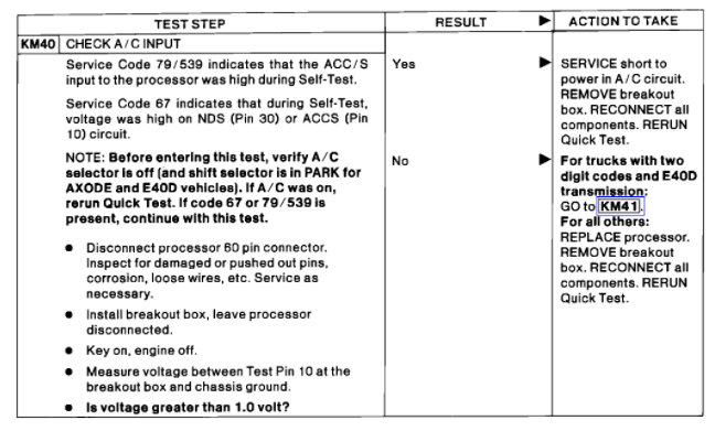

67 - High voltage at Pin 10 AC input or Pin 30 Neutral Drive while cranking or KOEO test.

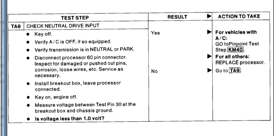

Let's tackle the 67. I attached the testing for it but if these are all new codes, I suspect you do have something left unhooked or we damaged a wire.

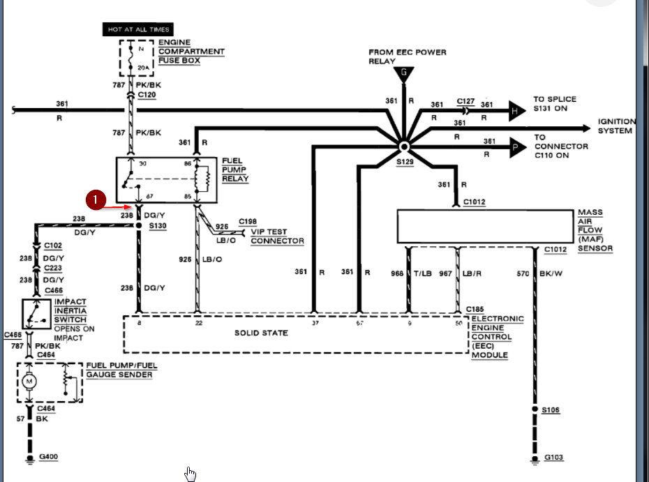

However, we should go to the pump and check power at key on. Clearly I am trying to tie this the repair you made but maybe we have a coincidence. I attached the wiring diagram but you only have one wire and a ground wire so we need 12 volts at the pump when key is on.
Let's run through this and go from there.

Okay, so I didn't really understand some of that so let just say, I got to the pump there were 4 wires and going from the schematics I've seen dg/y is the hot wire but I may be wrong. Regardless, none of the 4 wires are getting power with the key on or off. I went back and traced my steps and what I did. Even traced the dg/y all the way back to the relay. I'm lost. I did run a wire strait from the battery to the pump and it kicked on.

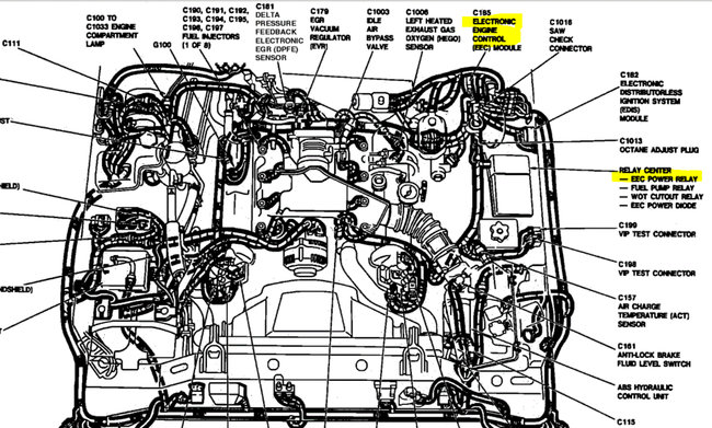

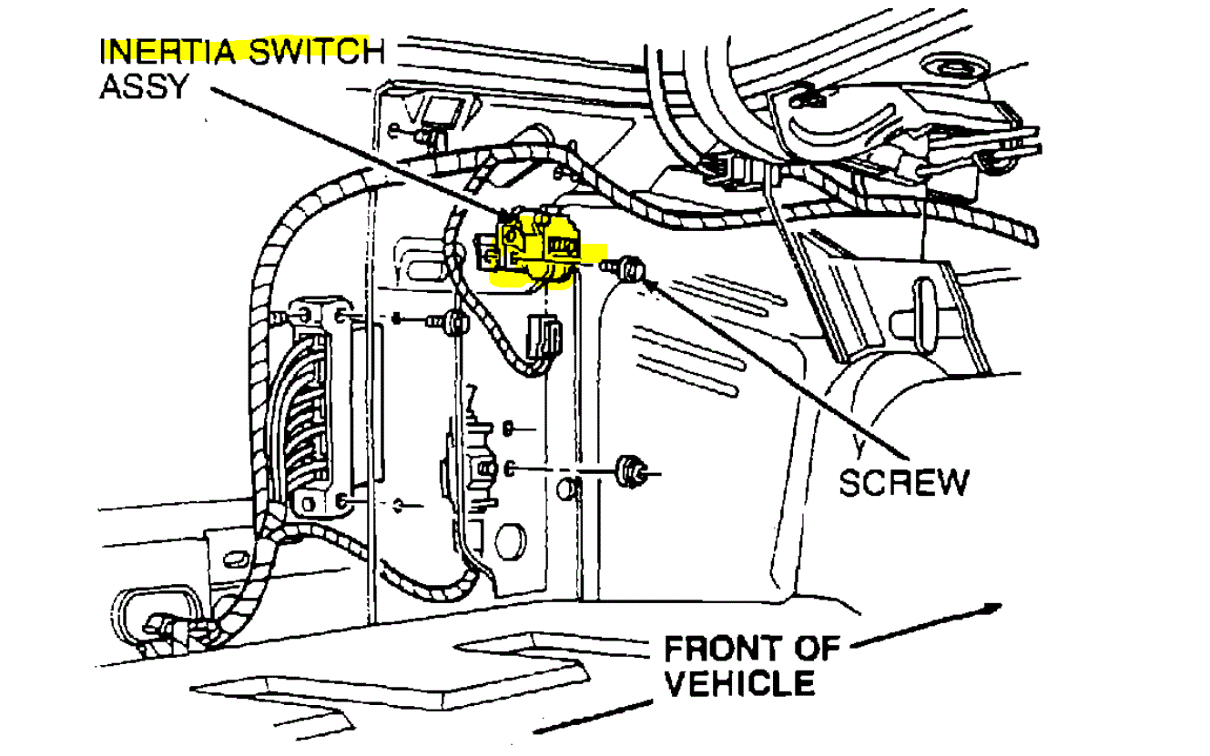

I have to refresh. Did you check the EEC relay, EEC power relay, and the inertia switch in the trunk? See attached pics.

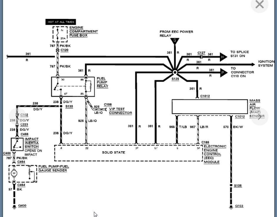

That is great. The reason the relay is not working is either you are not getting power on the other side of the relay (pin 86) or the PCM is not grounding it (pin 85). Take a look at the wiring diagram and you will see that pin 85 is connected to the PCM.
The way to test this is to remove the relay and put your red meter lead the positive battery terminal. The black lead of your meter on the terminal 85 of the relay. Then turn the key on. If the PCM grounds this circuit, your meter will show 12 volts.
Then check for power on pin 86. Simply put the red lead on pin 86 and the black lead of your meter on ground and turn the key on. You should have 12 volts.
You can leave the toggle switch if you want. The relay is only there as a control. So basically the fuel pump will only turn on when the PCM grounds the relay and closes the contact in the relay to send power to the fuel pump. The way you have it the fuel pump will not shut off until you flip the switch which could be a bit of an issue in some cases.
