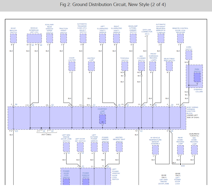

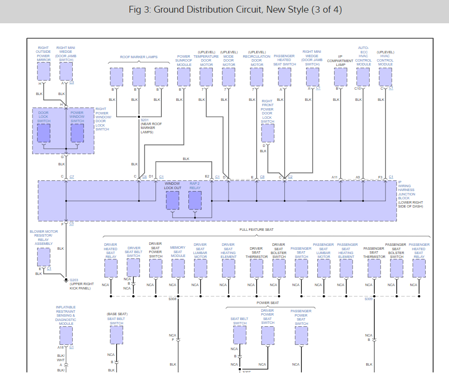

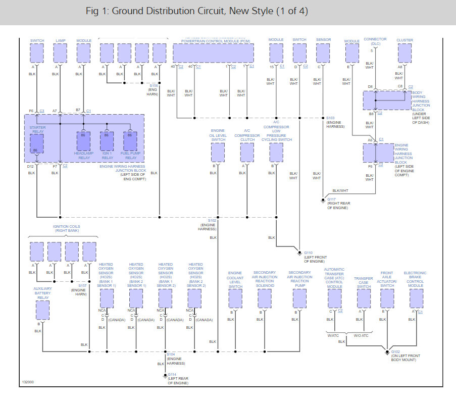

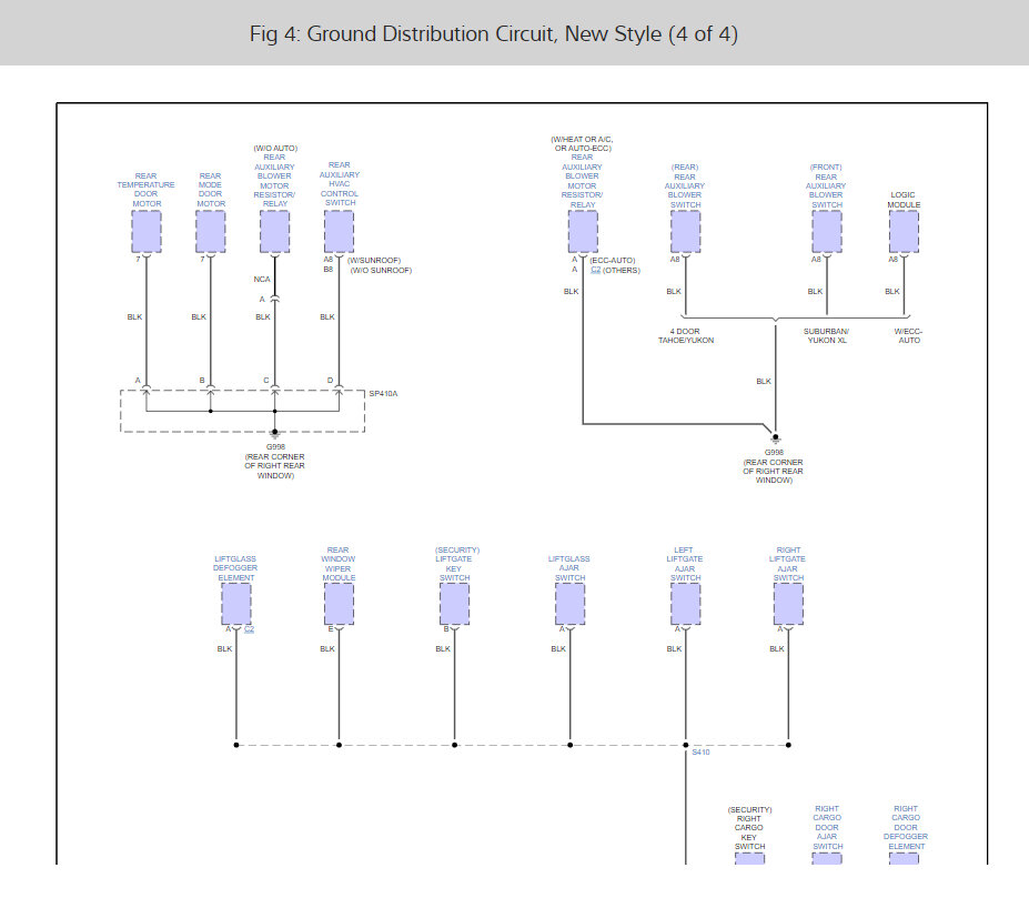

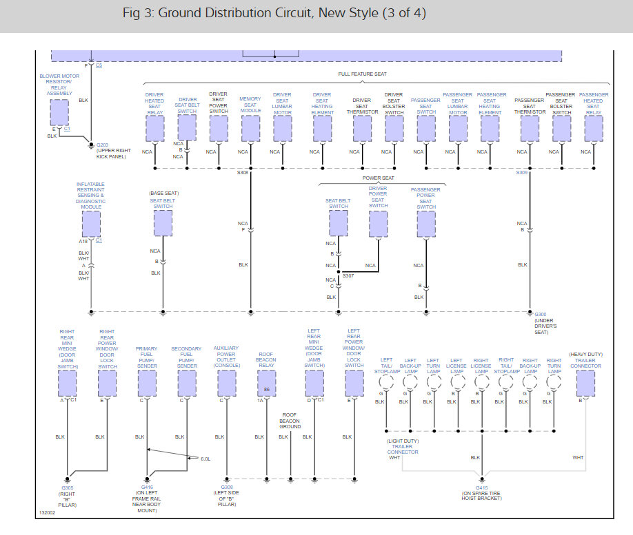

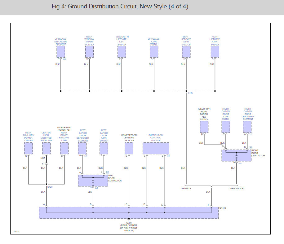

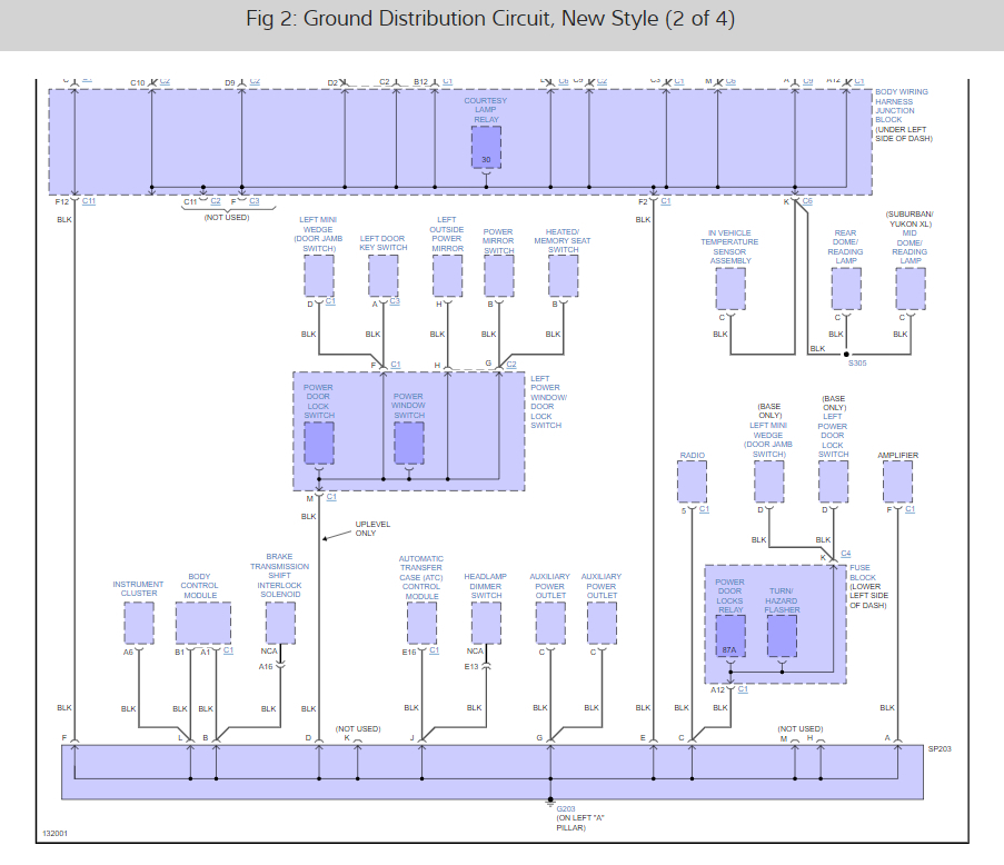

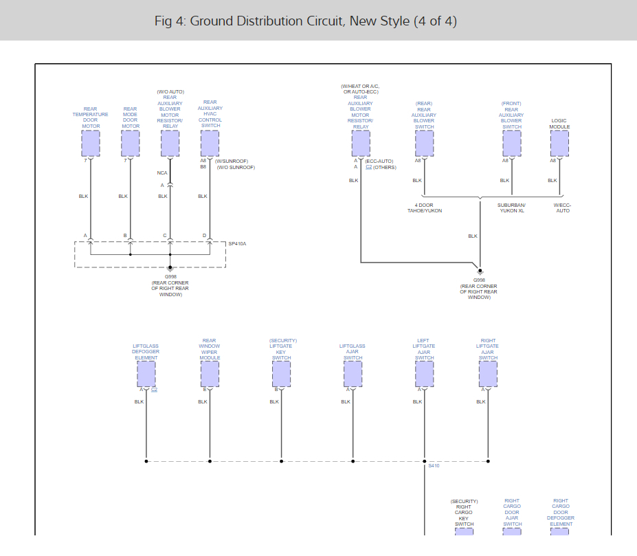

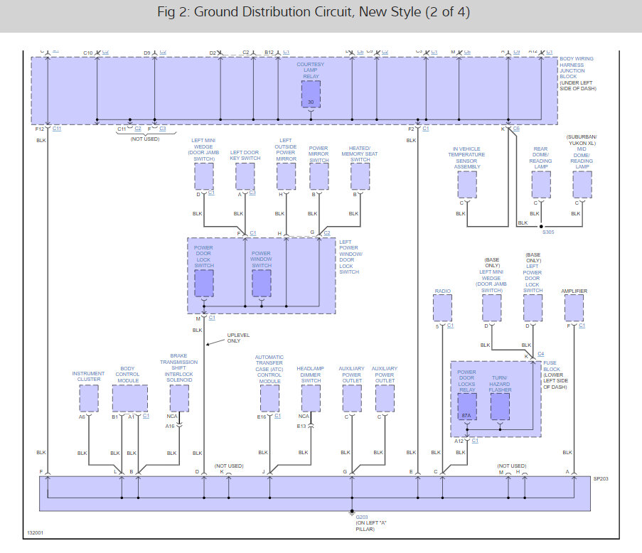

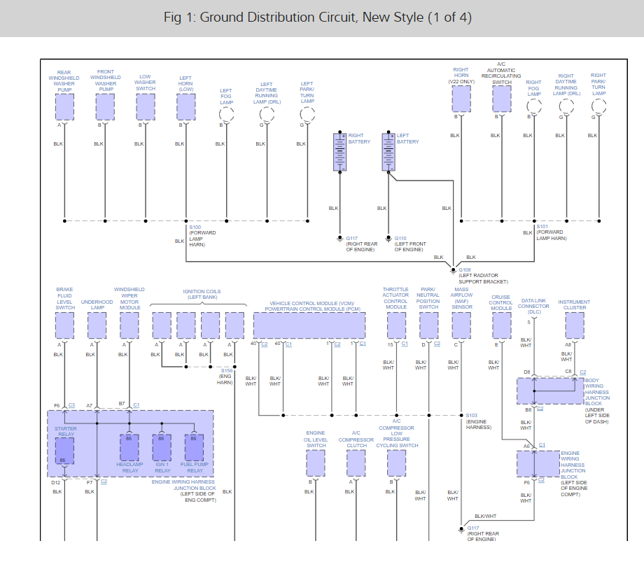

My 2000 Chevy Tahoe. Just put new crate motor in. It's throwing a p0336 and p0339 code. How can I fix. Also need a ground wire pdf. I think that may be the cause. Or to much voltage.
Tuesday, January 24th, 2023 AT 11:05 AM (Merged)
KEN L
  • MASTER CERTIFIED MECHANIC
  • 55,185 POSTS
Sure, here are the ground wiring diagrams and locations, did you look into the reluctor wheel? Also check the electrical connector at the sensor.
Tuesday, January 24th, 2023 AT 11:41 AM
