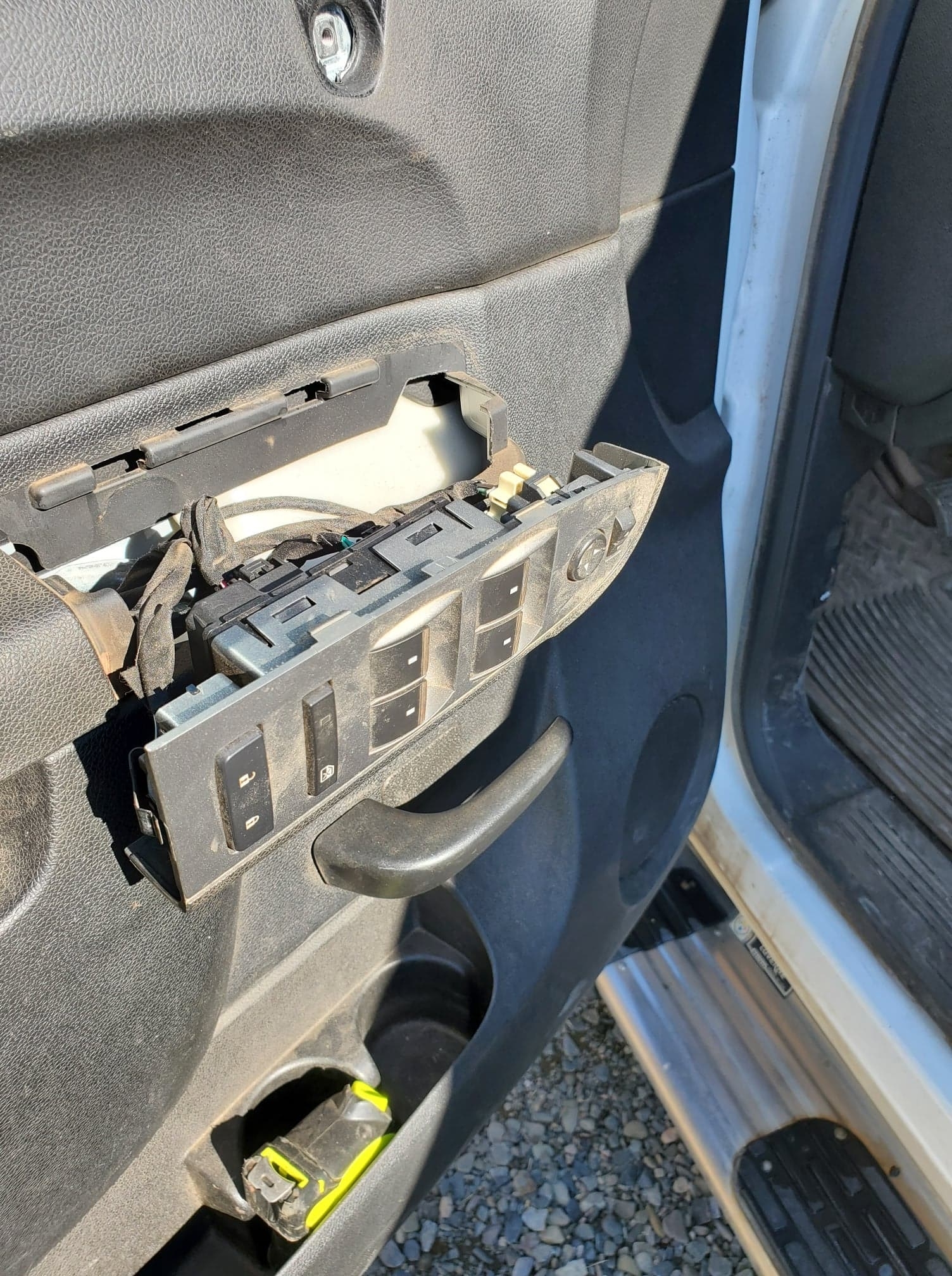

Driver's side switch (Master) drives driver window up and down.
Rt Front switch drives RF window up and down. M drives it up only.
LR switch drives LR window down only. M drives it up only.
RR switch drives RR window down only. M drives it up only.
This is mostly consistent but not always.

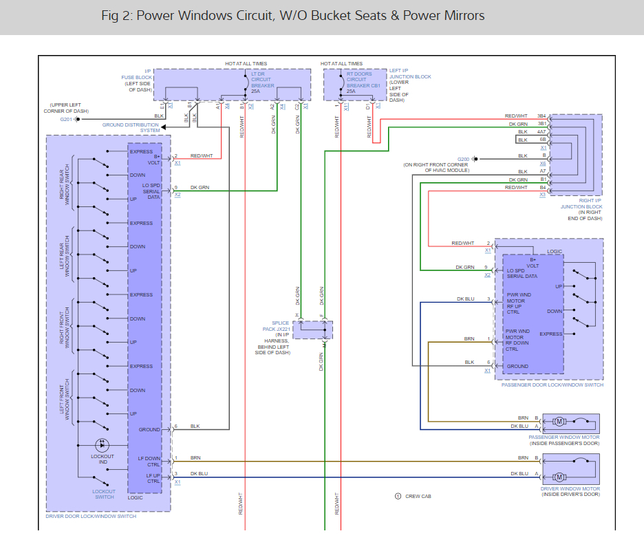

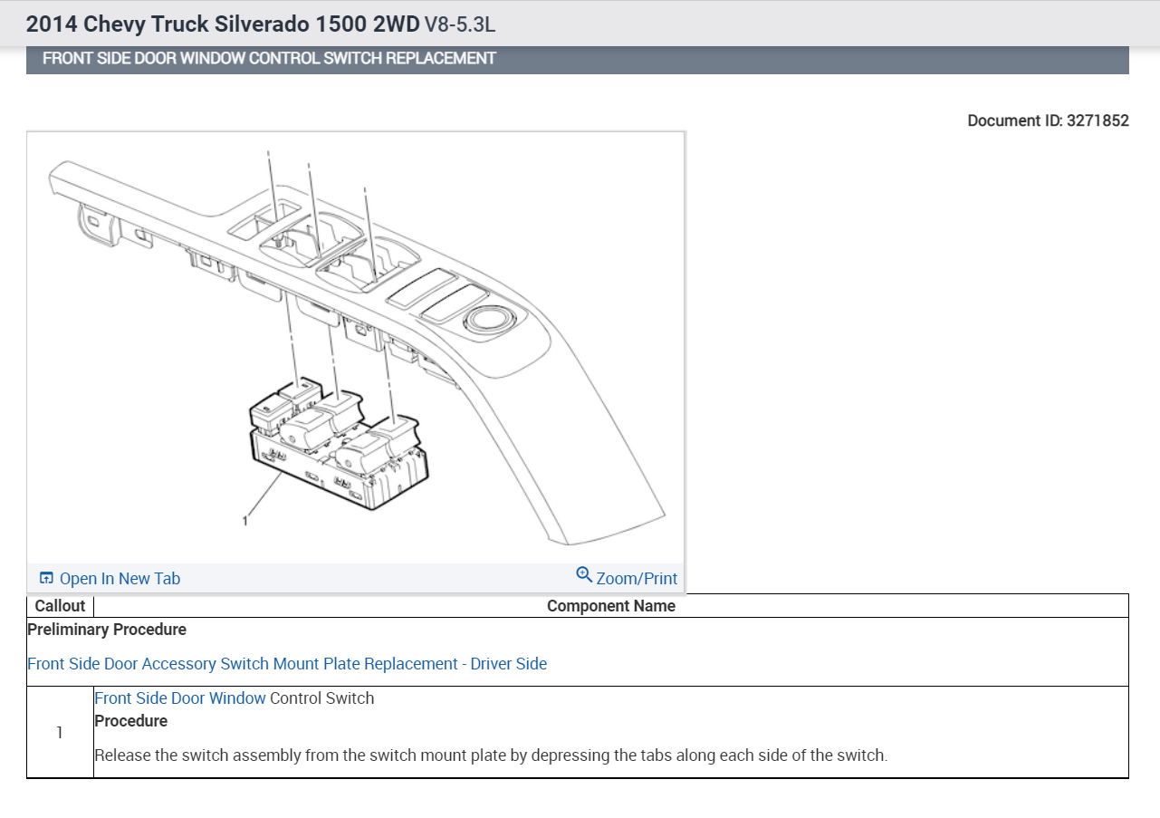

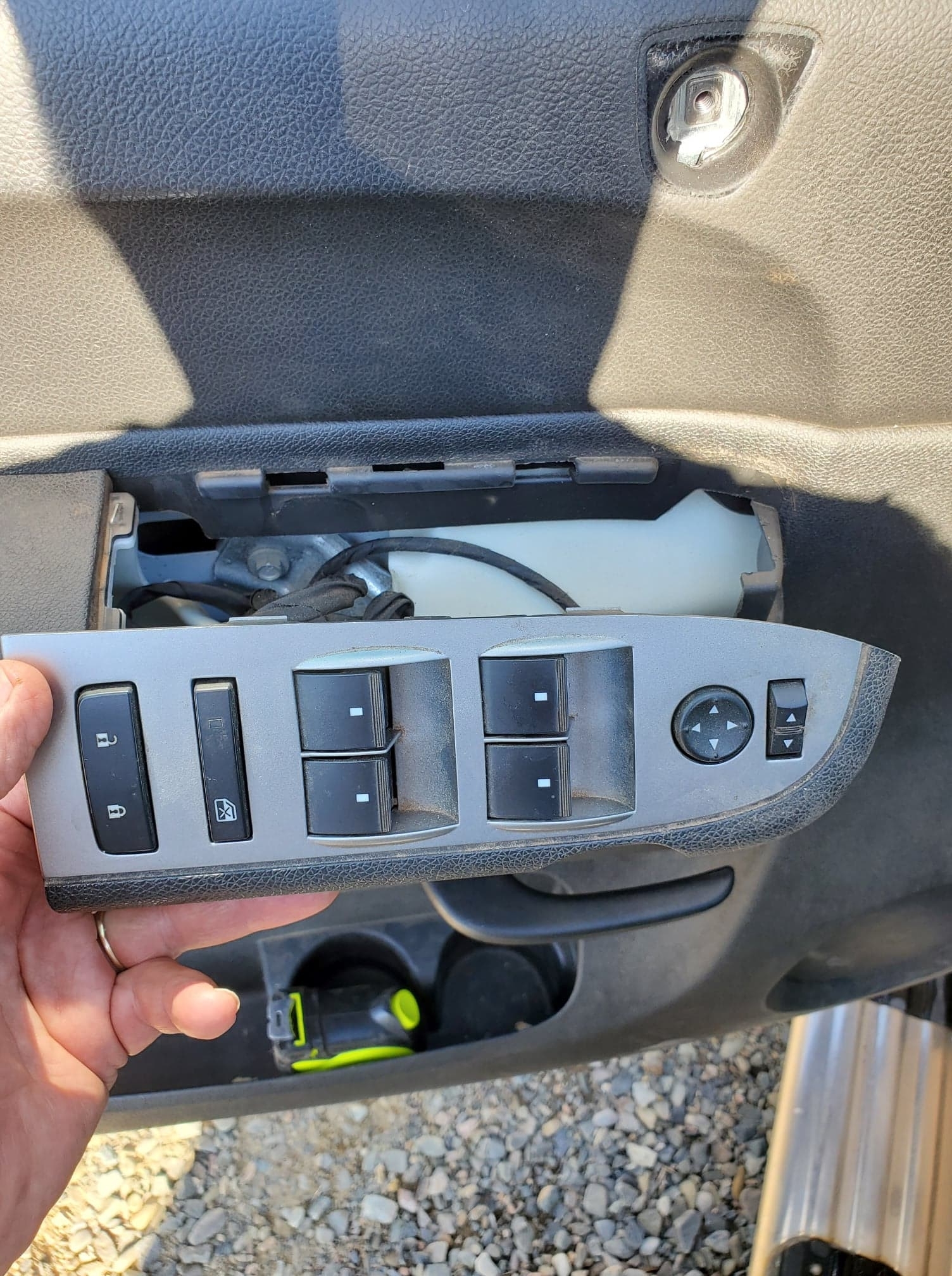

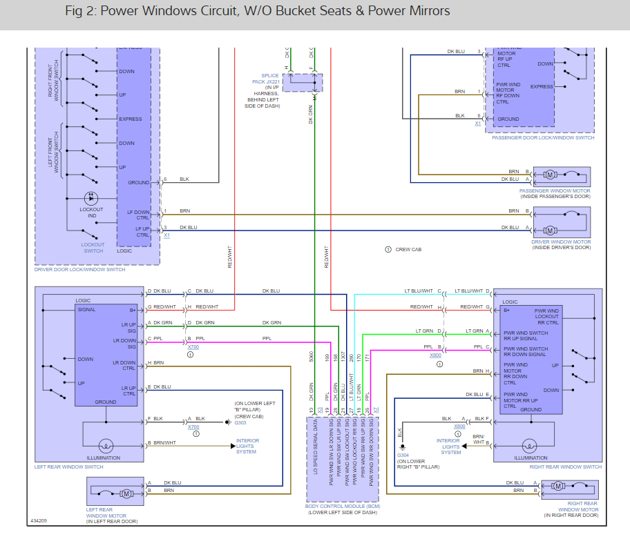

It sounds like the logic module has gone out in the master window switch, but to be sure here is a guide to help you check for power and the window wiring diagrams so you can see how the system works and which wires to test. Check out the images below to see how on your truck.
and
https://www.2carpros.com/articles/electric-window-repair

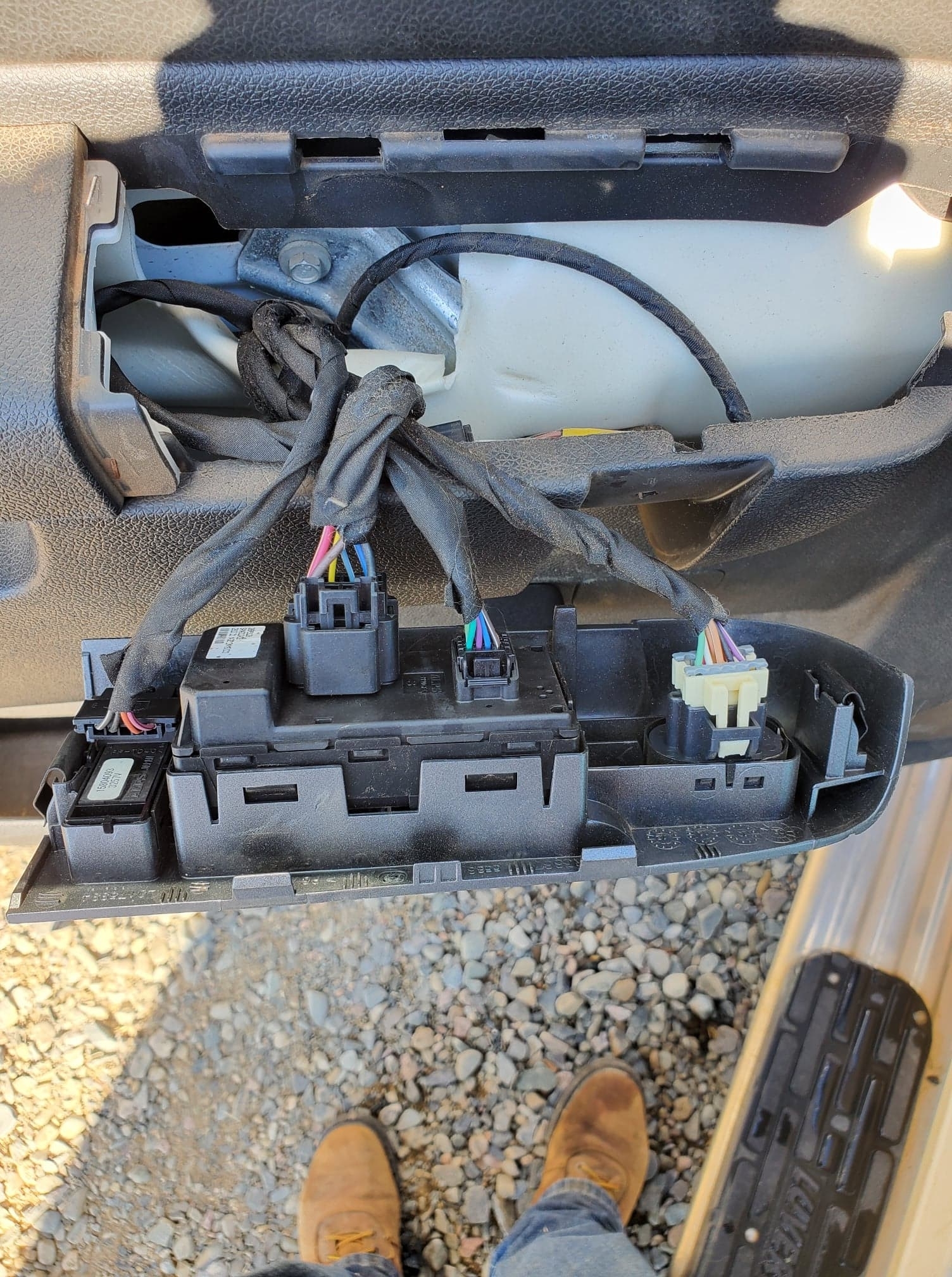

I have included how to change the switch out in case you need it as well. The switch bezel pops off and the switch screws in from underneath. Check out the images (below). Please let us know what happens.

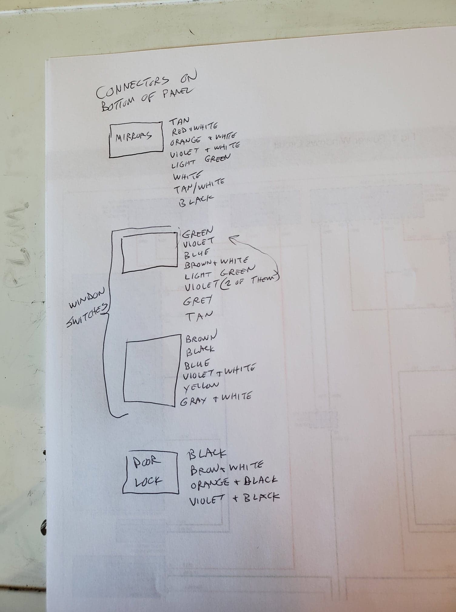

Thanks, Ken, unfortunately, the switch panel, number and colors of the wires don't match up with the diagrams you sent - perhaps because mine is a 4WD 2500 HD?

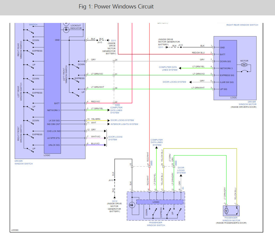

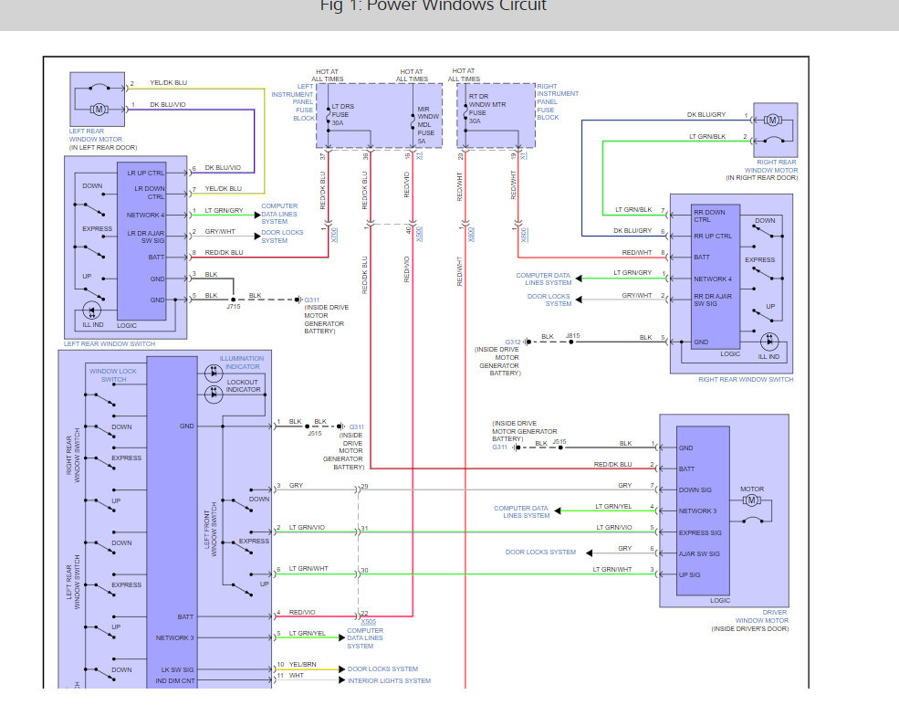

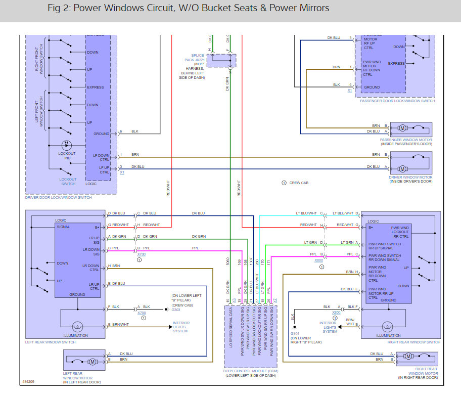

Okay, here is the other option for window switch controls, let me know at you find.
Friday, October 7th, 2022 AT 4:39 PM
SCOFOJO
  • 8 POSTS
No, it doesn't match up. I was looking around on YouTube before I found you guys and one dude said the diagrams are all messed up for this vehicle, apparently. I appreciate your efforts but I sort of gave up and just ordered a new switch, only $20.00 so not too much of a loss if it doesn't fix it. Again, thanks for your help!

Switch fixed it. It's been malfunctioning for years. I never fixed it because the dealer said it could take literally thousands of dollars in guesswork and swapping out parts to find the problem. When I finally looked into a new switch last week and found they could be had for under $20.00 it was a no brainer to just try it. Unbelievable. Thank you for your help.
