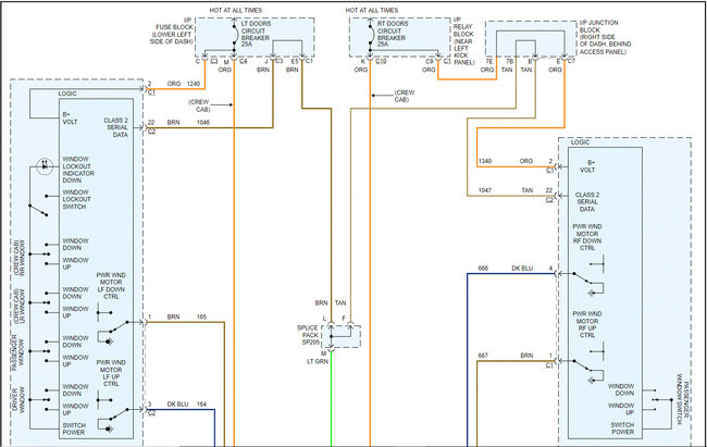

I'm having problems with my window control panel I'm using a Yukon window control wires for my GMC Sierra window original and I can't figure it out with color and wire goes with what.

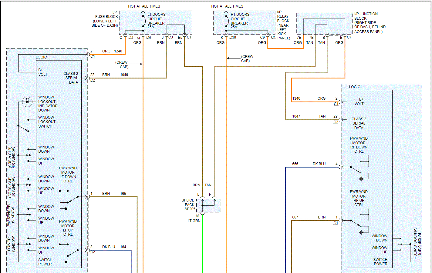

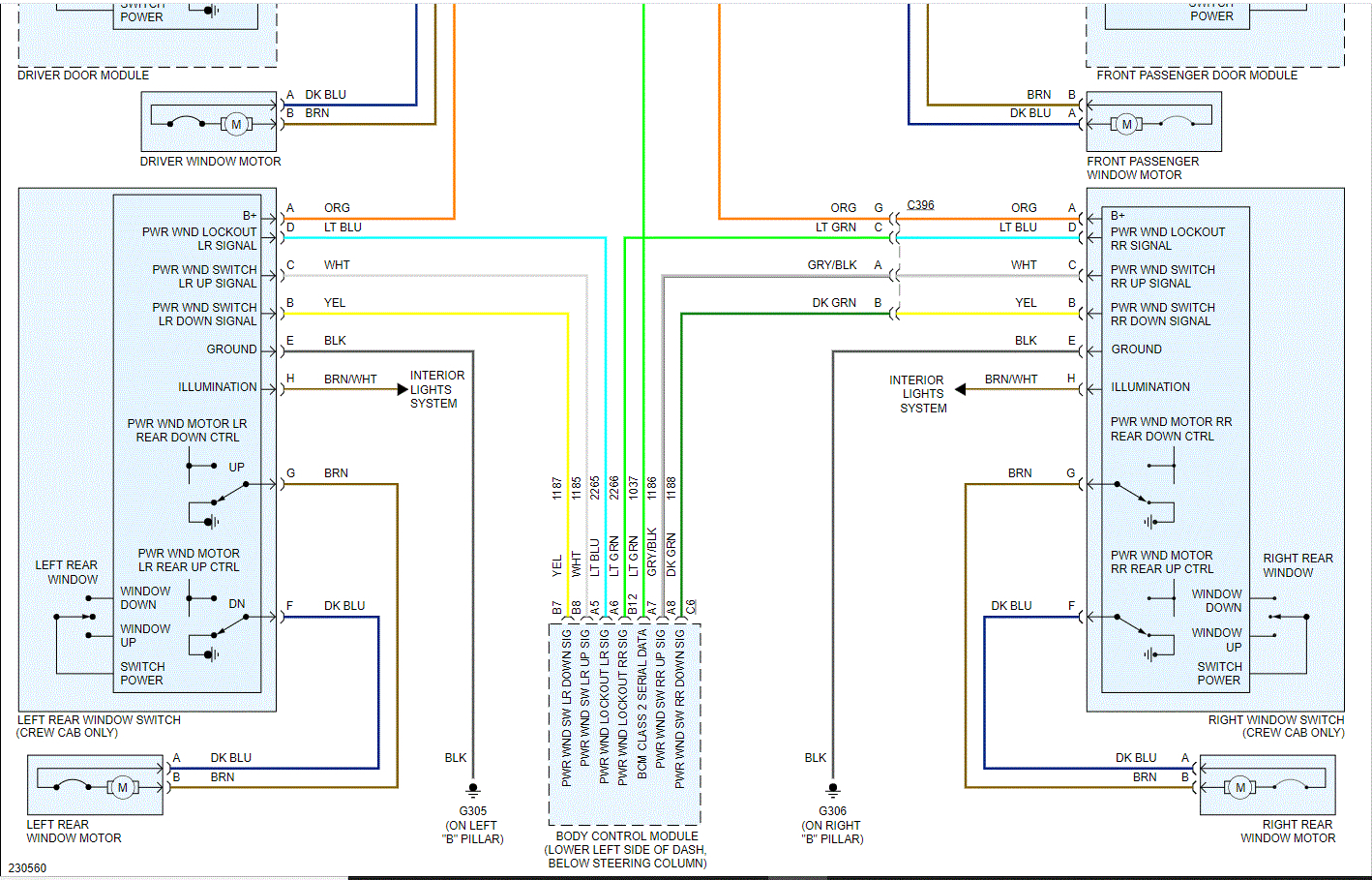

Let's see what we can figure out together. Below, I attached the wiring schematic for the power window circuit specific to your vehicle. If you can provide the year of the Yukon that you got the part from, I will provide those as well Then, we can figure out if it is even possible.
See pics below Note: I had to cut the pic in half to make it readable for you. I did overlap them so you can follow from one to the next.

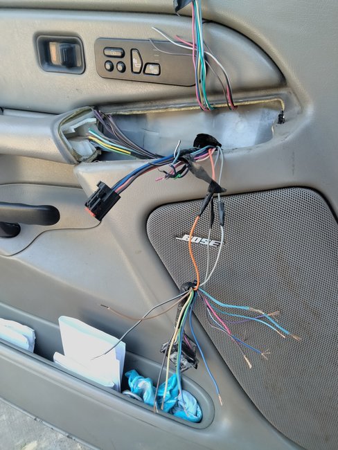

It's the same as my truck 2007. I'm kind of new to the wire diagram, so I don't know that much of electrical stuff. The picture I uploaded it's from the Yukon GMC.

What I going to try is connect the ones that matches the ones from my truck too the GMC Yukon. I just want to know what color goes 2 what after I match them. Probably have some wire loose.

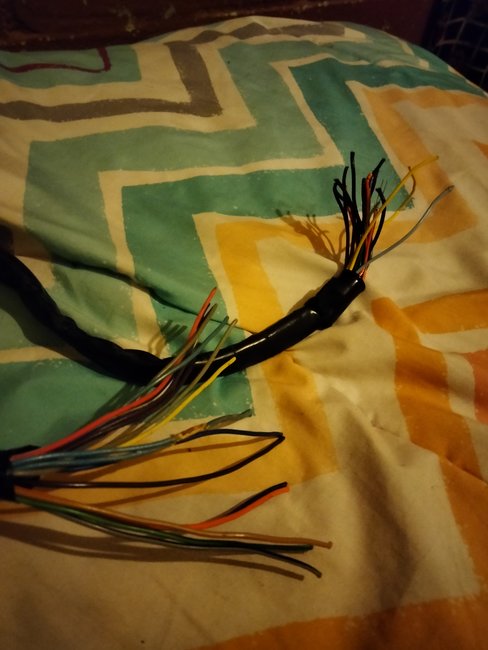

I know that's why I want video of people doing things like that so I can see on my own put. I'll try adding a picture of my GMC wires.
