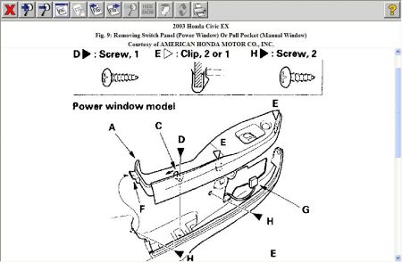

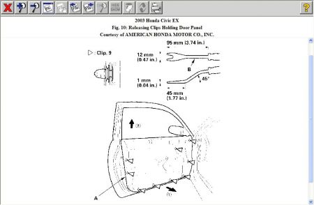

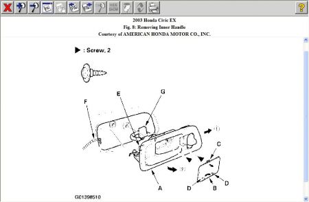

when I use the remote to lock the doors, just the lock of right door works, left not, so I want to fix it, but firstly I have to know how to disemble the left door, then I can check what ' problem with the lock. Thanks a lot.
Thursday, January 21st, 2021 AT 12:44 PM (Merged)
KHLOW2008
  • 41,815 POSTS
Hi yongtao,
https://www.2carpros.com/forum/automotive_pictures/192750_InnerHandle03Civic_1.jpg
https://www.2carpros.com/forum/automotive_pictures/192750_SwitchPanel03Civic_1.jpg
https://www.2carpros.com/forum/automotive_pictures/192750_PanelClipsDoor03Civic_1.jpg
