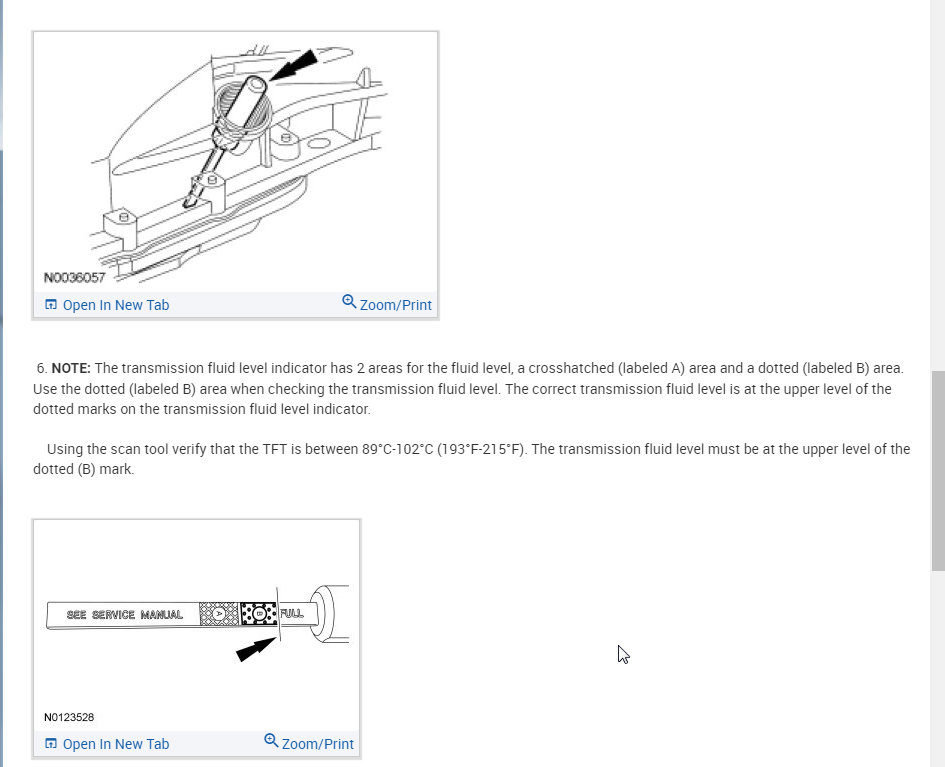

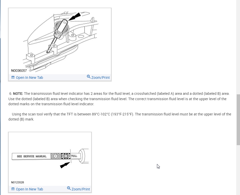

Well, it's taking forever for the transmission to get up to temperature. Should the fluid level be in the A or B area?
Saturday, March 21st, 2020 AT 4:41 PM
Here it is from the manual. Figured it may be easier to see it as well.
Just make sure you do your final check when its to operating temperature.

Well the temperature gauge is close to the middle, but not exact. I'm at 7 quarts adding and I'm at the top of section A. This is weird considering I measured 6.
Saturday, March 21st, 2020 AT 5:10 PM
It is never 1 for 1 meaning you put in just what came out. If someone did this before and didn't follow the process I attached before then they under filled it. Stick to the process and it will take whatever it takes.
Saturday, March 21st, 2020 AT 5:15 PM

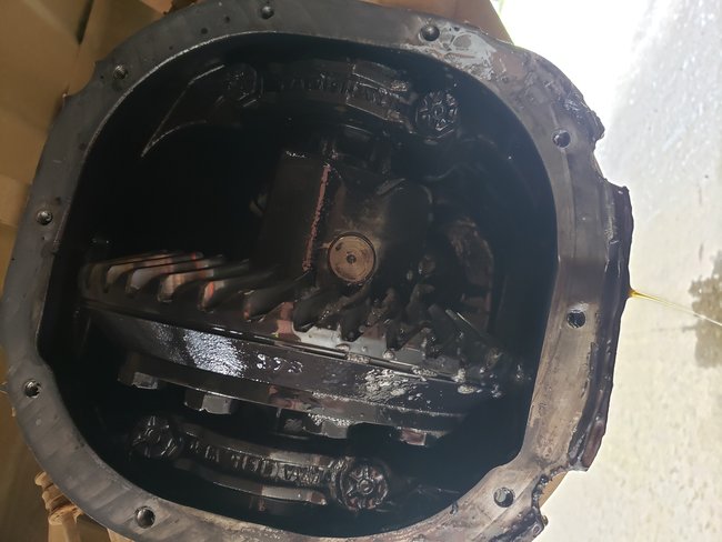

CANNON1349
  • 913 POSTS
How about this differential? It's a bit bubbly. I just drove it 15 miles before removing the cover. The fluid was a dark gray with yellow tint with light behind it. Kinda sludgy too. But no movement of the pinion.
