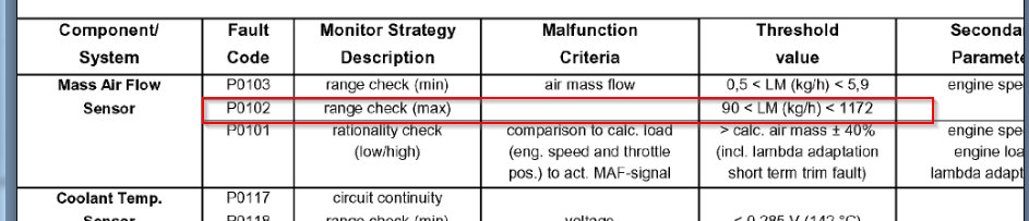

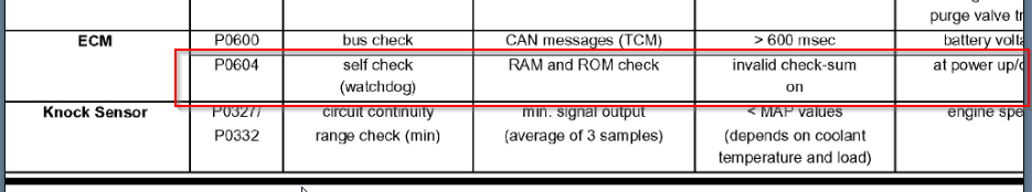

I replaced the CCV. That was really difficult with the intake manifold still in place. I'll sell that car before I ever do that again! I would've never known that system was there had I not seen the cracked hose from under the car last week. Who came up with that idea of 4 hoses and a crazy cyclone system instead of the normal simple elbow? Anyway, it started up! Blows white smoke everywhere and can hear a tick in engine. Getting p0604 code now but I'm gonna check my ECM fuse box tomorrow. It got dark on me and I'm exhausted. My only guess is possible blown fuse? Can't find much online but that 604 code only came up after I removed dme relay while doing wet compression tests last week. Also still getting p0102 MAF A Circuit Low. Only two codes I'm getting. Still afraid to drive it or even rev engine with that 604 code. I think I can take it from here but I want to sincerely thank you for all your input! You've been a wonderful asset to my 5 week endeavor! I'd be happy to send a Starbucks card or something brother I'd have given up weeks ago if not for your input. Thank you so much. And let me know how I can get ya that gift card!

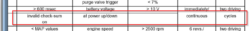

Monday, May 4th, 2020 AT 7:27 PM
Awesome! That is progress. Excellent work.
As for this code.
P0604 - Internal Control module Random Access memory error.
It is most likely an internal issue with the ECM. However, I suspect that will clear once you give it a couple drive cycles if it is not a failed ECM. I would just let it idle for a little while and see if the tick and smoke resolve themselves. The smoke may just be water, oil, burning out and the lifters may be tapping a little and could pump up. We want smooth idle and no knocking. You hear this, shut it down.
P0102 - MAF circuit low
Again, I would see if this comes back after a couple drive cycles.
Based on these codes I don't see anything that would give me pause of running the engine. Clearly we want to see the smoke and tic noise to clear up but again, I would just take it a few short drives with easy driving and see what happens.
