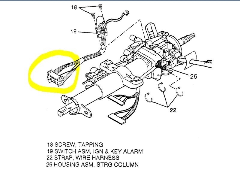

Truck cranks then starts for a brief second and shuts off. I have had problem lately when I hit a large pothole or bump and the blower motor and radio go out and the anti-lock and airbag light come. Move the key a little and the lights go off. It seems that the ignition or fuel pump shut down in the run mode of the switch but I believe the other systems have power. Ever heard of such a problem?

Good morning,
I would start by checking connections. It sounds like maybe your ignition switch may be the issue but check the connector to be sure it is not loose.

Thank's Roy none of the diagrams mention it. The other thing I forgot to mention is if I move the key back just a little bit when it was running the lights went out and the radio and blower motor came back on!
Monday, April 15th, 2019 AT 8:03 AM
  • 52,797 POSTS
That is the switch itself that is the issue.

5. Ignition & key alarm switch assembly (19).
- Wire harness from slot in steering column housing assembly (26).
INSTALLATION
CAUTION: Always use the correct fastener In the proper location. When you replace a fastener, use ONLY the exact part number for that application. The manufacturer will call out those fasteners that require a replacement after removal. The manufacturer will also call out the fasteners that require thread lockers or thread sealant. UNLESS OTHERWISE SPECIFIED, do not use supplemental coatings (paints, greases, or other corrosion Inhibitors) on threaded fasteners or fastener joint interfaces. Generally, such coatings adversely affect the fastener torque and joint clamping force, and may damage the fastener. When you install fasteners, use the correct tightening sequence and specifications. Following these instructions can help you avoid damage to parts and systems.
Install or connect the following:
1. Ignition & key alarm switch assembly (19).
- Route wire harness through slot in steering column housing assembly (26). Secure wire harness with a wire harness strap (22) through hole located in the bottom of housing assembly (26).

Believe it or not Roy, but I undid the switch from the after what a day for the e4 socket for the two screws holding the switch on tested the fuel from battery to the test connector didn't hear the pump, so I held the switch in turned the key and it fired right up an ran until I shut it off without it shutting off like it did before.I had tried starting it earlier today and no start. I am wondering if it's a bad connection where the wires go into the switch?" Going to try moving the switch around while it's running to see what happens.I will let you know how I make out, appreciate you help, you guy's are great.

  • 52,797 POSTS
Yep, it could be a bad connection.
Let it run and do a wiggle test. That is where you grab a different harness and move them around and see if it causes the engine to shut off.
