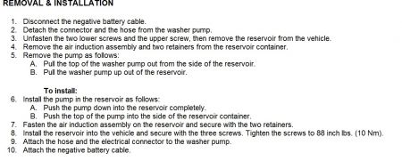

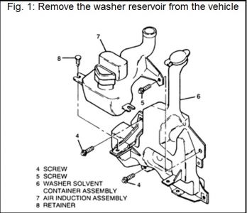

Windsheild reservoir seems not to hold fluid. Not sure yet. Is the reservoir easy to remove for inspection. Could it be a line and are they readily accessible.

Your on the right track, don't know how easy to remove, have to look at it.
