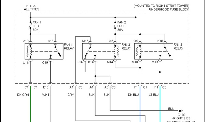

Hi, my cooling fans are not kicking in. I checked the relays and appear to be good, but switched them out for others to double check and all is good. The temp rises at an idle and the templ light and check engine soon light come on, but when driving it drops down to a normal temp and the warning lights go off. I have heat so I'm assuming the thermostat is working. I jumped the connection where the engine diagnostic tool plugs in and the fans turned on right away. I've boiled it down to either the temp sensor or possibly the fuse before the relay, but I can't find the fuse. Any help is appreciated. Jeremy

Check ignition fuse 10amp and 15amp-also the coolant temperature sensor if all okay test the engine control module

The ign. fuses are good, but how do you test the temp sensor, I have a multimeter but don't know how to test this. I heard that it is powered with ohms, if that makes sense,

A bad coolant temperature sensor can be diagnosed by measuring its resistance and watching for a change as the engine warms up. No change, or an open or closed reading would indicate a bad sensor

The most likely suspect is a defective fan motor, but electrical tests need to be done to verify the rest of the circuitry is okay. To eliminate the relay, just swap it with a different one like it.

Hello –
Thanks for the info……..
The light does not have to be on to have thrown a code. Some – the light comes on – a code is thrown and when the key is cycled the light is off but the code remains.
Below is some info for you……….the last item is the actual fans are always on troubleshooting.
Inside Electrical Center At Right Side Of Engine Compartment
3.1L & 3.8L "W" BODY (GRAND PRIX)
NOTE: Cooling fan circuit utilizes 3 cooling fan relays. Relays directly controlling fan motors are 4-pin type and are referred to as No. 1 and 2. Relay determining cooling fan motor low speed or high speed operation is referred to as 5-pin relay in this test. See WIRING DIAGRAMS .
Cooling Fan Always On (3.8L)
1. If diagnostic system check has been performed, go to next step. If diagnostic system check has not been performed, see DIAGNOSTIC SYSTEM CHECK .
2. Turn ignition on, engine off. If one or both cooling fans are on, go to next step. If one or both cooling fans are not on, problem is intermittent.
3. If both cooling fans are running continuously, go to step 5 . If both cooling fans are not running continuously, go to next step.
4. Remove cool fan relay. If left cooling fan turned off, go to step 6 . If left cooling fan did not turn off, go to step 7 .
5. Repair short to voltage in right cooling fan supply voltage circuit. After repairs, go to step 8 .
6. Repair short to voltage in right cooling fan low reference circuit. After repairs, go to step 8 .
7. Repair short to voltage in left cooling fan supply voltage circuit. After repairs, go to next step.
8. Operate system to verify repair.

Turns out I had the car brought in and it had a code of PO128 ECT below thermostat regulating temperature. The code was reset and my cooling fans operate as normal. Although they did not that my car only runs at 150 degrees down the highway, my car has always ran cool in the winter versus about just under 210 in the summer. I put a new thermostat in about a month ago and I know Grand Prix's like mine also run cool. I don't know why but I wonder if maybe that's why it takes my car so long to warm up, any thoughts? Anyways, it's fixed now and you know what the problem was.
