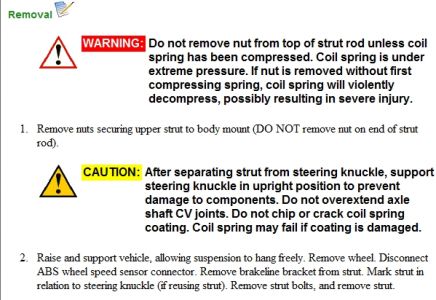

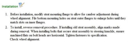

How to replace
Thursday, May 6th, 2010 AT 4:02 PM
BLUELIGHTNIN6
MECHANIC
16,542 POSTS
Thursday, May 6th, 2010 AT 11:18 PM
