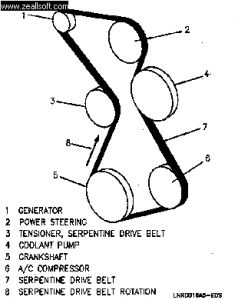

1995 Pontiac Grand Am 3.1 139000 miles
serpentine belt diagram and can I replace belt without removing motor mount

BMRFIXIT
  • 19,053 POSTS
https://www.2carpros.com/forum/automotive_pictures/99387_s10_3.jpg
https://www.2carpros.com/forum/automotive_pictures/99387_s100_1.jpg
have to remove the mout
