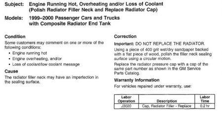

Well my 1999 pontiac grand am gt keeps on over heating it trows steem out tough the radiator bleeder I bleed it like a dozen timez but it keepz doin da samething trowin all da coolent out

I ran across that bulletin, just something to check. You might also check that the cooling fans are running?
