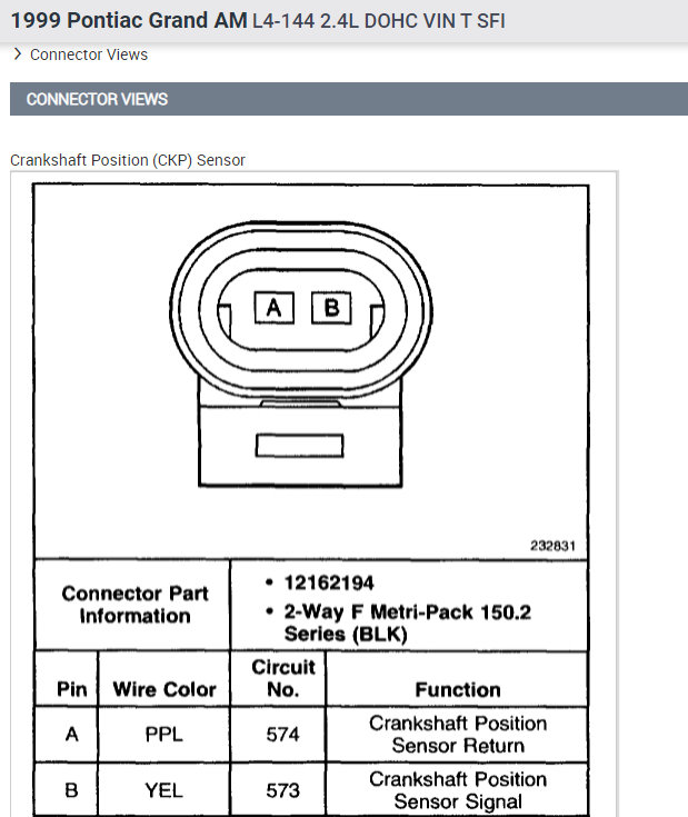

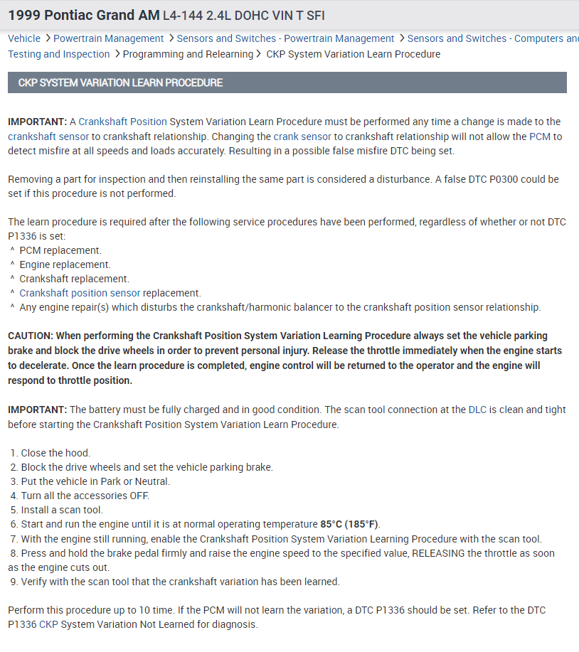

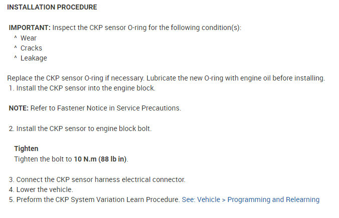

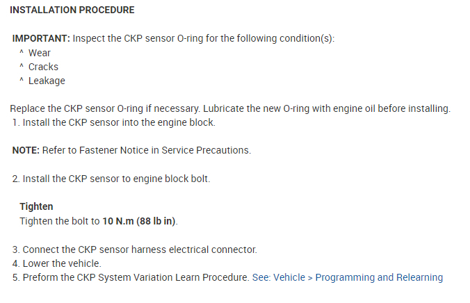

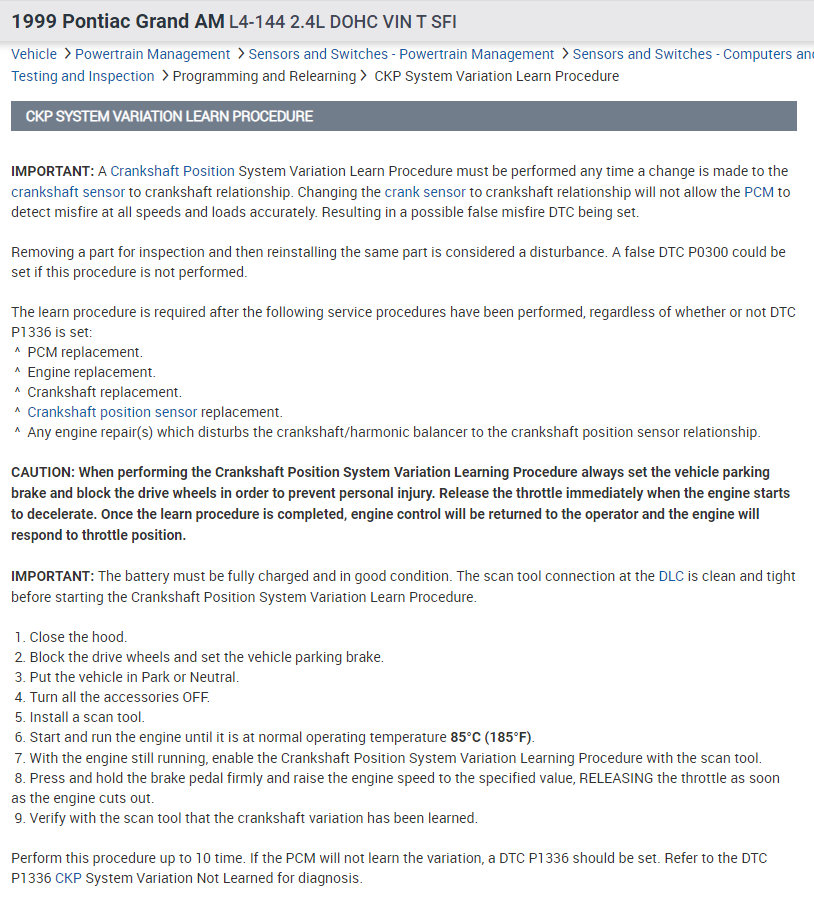

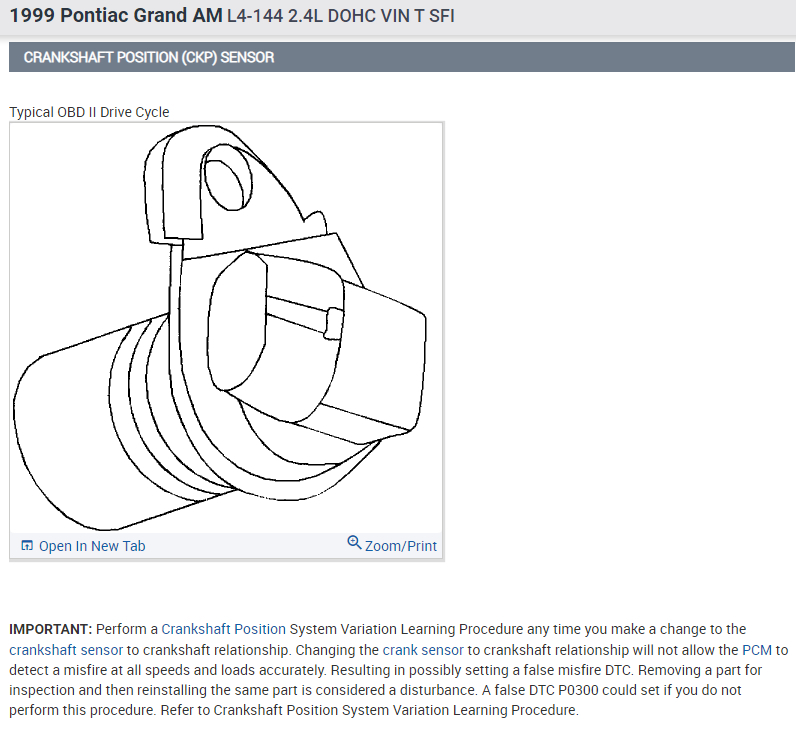

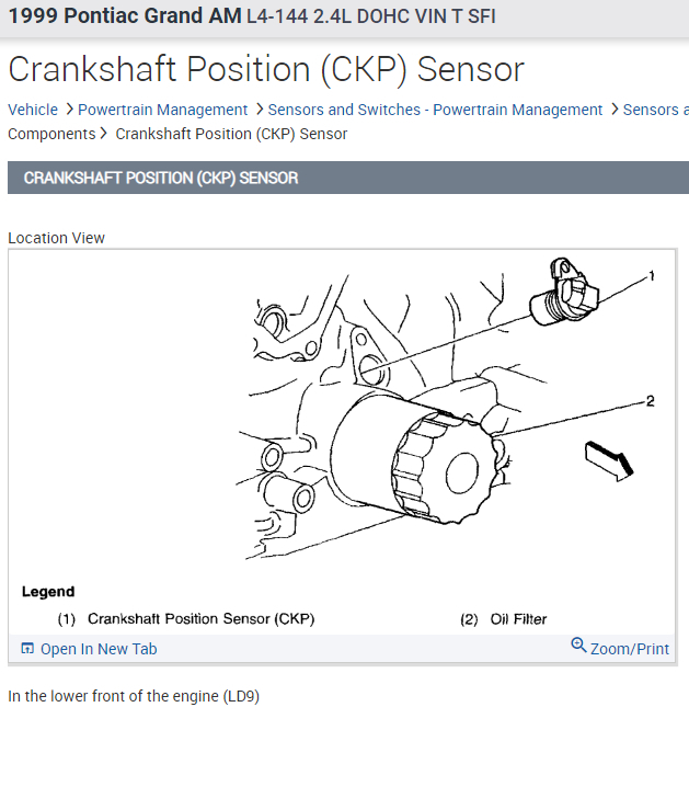

It sounds like it could an issue with the crankshaft position sensor.
From the heat and vibration of the engine the crankshaft can lose its internal calibration.
As the crank sensor starts to go bad it could produce these intermittent no start.
Typically you can try few times it will start. However overtime it will progressively get worse and won't start at all.
It can even stall the engine while you are driving.

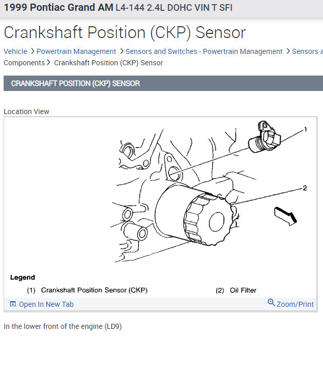

The crank sensor is located at the bottom of the engine, right next to the oil filter housing.
