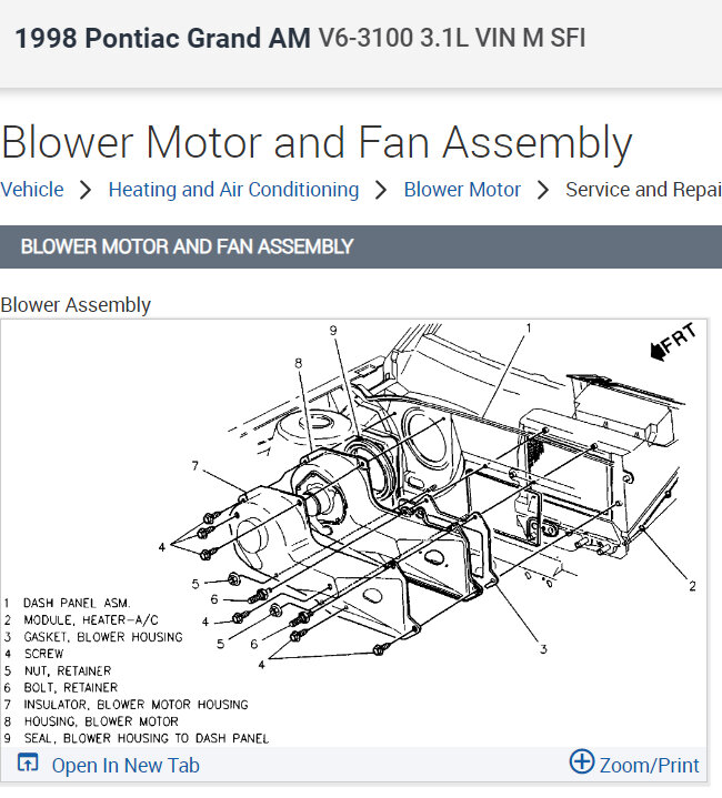

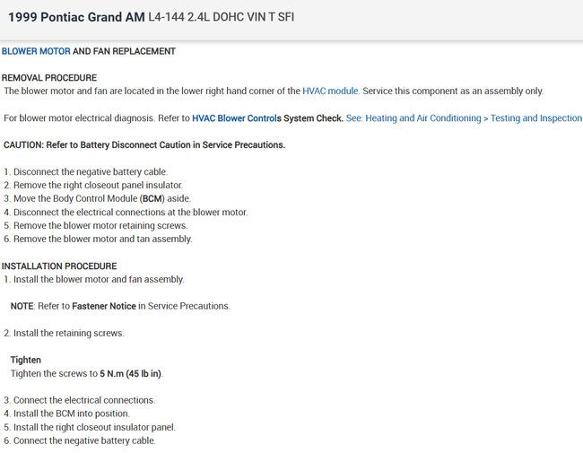

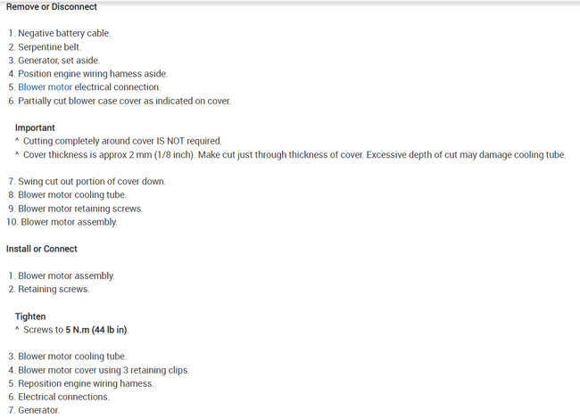

I agree with BMRFIXIT, here is the blower motor location and how to replace it. Check out the images (below). Let us know if you need anything else.

Yes, if the blower motor is not working the heater will not work as well. Here is how to test he blower motor power and ground to make sure the motor is the problem.
https://www.2carpros.com/articles/how-to-test-an-automotive-hvac-system-blower-fan-motor-a-detailed

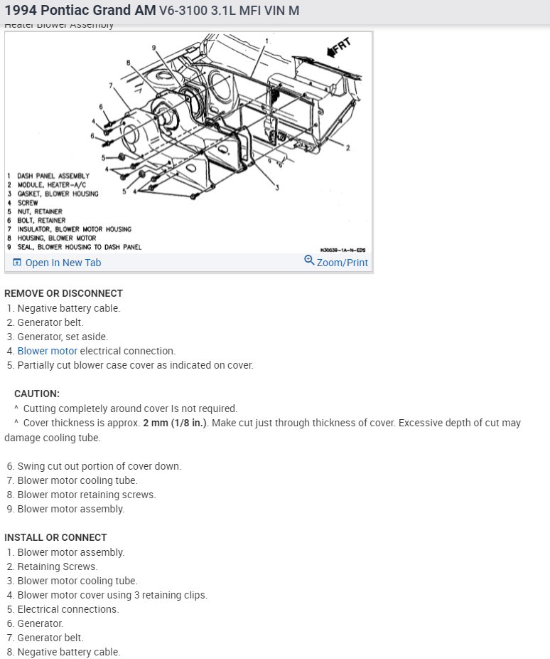

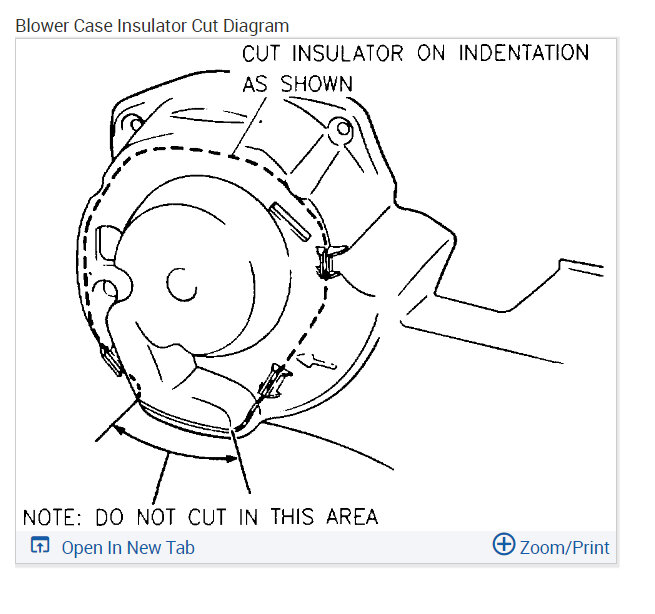

Here is the location of the blower motor and how to change it out. Check out the images (below). Let us know how it goes. You will need to cut the insulation to get at the blower motor.

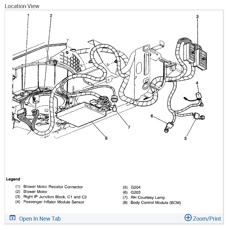

Have you checked heater fuses? I don't know an easy way to get at the connector. You may have to access the blower motor and follow the wires.
The autozone site has info on getting at the blower motor. Click on( vehicle repair guides) follow the links for y--m--m, then type blower motor in their( parts search box), that page will have a link at the bottom for getting at the blower motor.

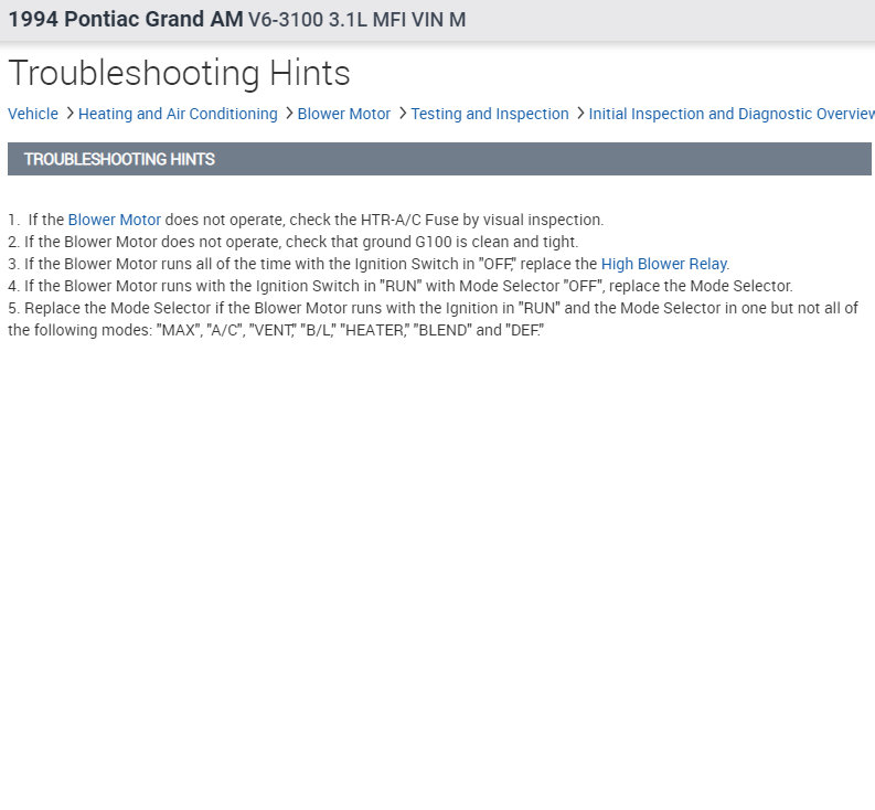

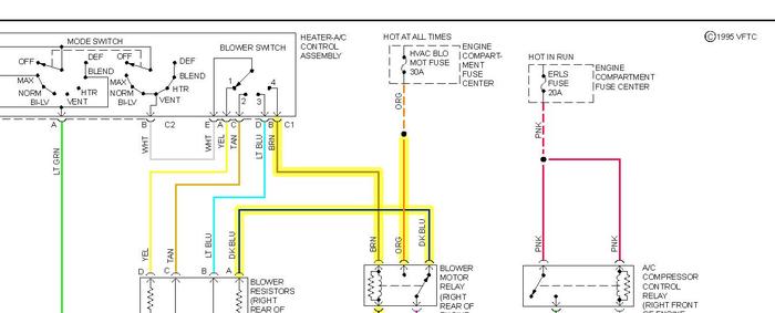

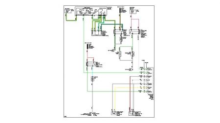

BLOWER MOTOR WILL NOT RUN
Check fuses. Turn ignition switch to RUN position. Check for voltage at function control switch. Switch blower switch to HI position. Check for voltage at switch and at high-speed blower relay. Ground blower motor with ignition switch in RUN position. If blower operates, motor is okay.
Check the blower motor fuse 30amp in engine compartment fuse center and blower relay in right rear in engine compartment-
Do this -you can power the blower motor purple wire and see if it works direct from the battery postitive post-

If a fuse keeps blowing, it usually means something is faulty in the circuit. The wiring should be checked along with the components in the circuit to determine if there's a short or other problem. If a fuse blows in a motor circuit (heater blower motor, cooling fan motor, power seat or window, electric fuel pump, etc.), it often indicates a shorted motor. In your case, I would suspect a faulty blower motor.

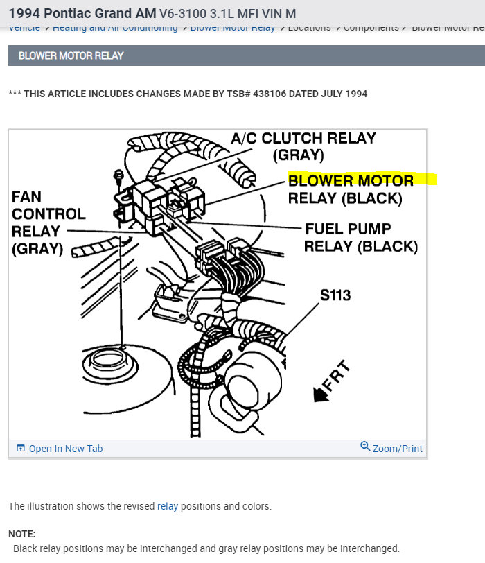

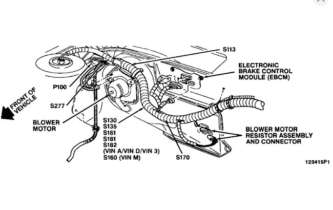

At fuse block check the Heater/AC fuse 25amp. This problem could be the Heater/AC control assembly,blower motor resistor/blower motor relay located it in the right rear of engine compartment. See below
https://images.2carpros.com/forum/automotive_pictures/12900_blower_2.jpg

An inoperative blower fan can be due to a faulty switch, bad relay, malfunctioning blower motor resistor, bad motor or wiring issue.
First check the relay.
The blower motor relay is located under the hood (see diagram).
Check for any corrosion or burnt pin(s).
You can also test the relay.
If the relay is good, then make sure the blower motor is getting power. To see if the motor is good or bad you can test it by simply applying 12V power to it.

Also, where is the fan located? How do I go about getting to it? Do I need to take apart the dash?Thanks
Nov 9, 2024 at 4:52 PM (Merged)
  • CAR REPAIR CONTRIBUTOR
  • 110,190 POSTS
The fan is located under the dash on the passanger side. And yes, you need to take part of the dash apart to access it. As far as the problem, it could be a bad blower motor relay that is reacting to the temp change. To be sure, you will need to check the fan to see if it is getting power when it isn't working. Also, I would also suggest making a new ground strap from the motor to a ground on the body to make sure it has a good ground.
