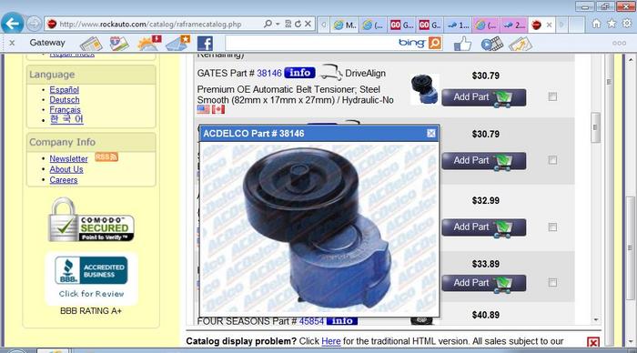

Main bolt broke off. A pic. On replacing pully.W/ spring would be very helpfull. I know I got to drill out broken bolt first
Tuesday, July 28th, 2020 AT 1:08 PM (Merged)
SATURNTECH9
  • 30,869 POSTS
Idler pulley with spring?The idler pulley shouldn't have a spring. Are you talking about the belt tenisor?If so did the bolt break that holds the pulley on?
SATURNTECH9
  • 30,869 POSTS
Does it look like the one I posted?
FUNNYF
  • 17 POSTS
Yes, that looks like it. The main bolt that holds tenisor onto motor broke, not the bolt that just holds pully onto the spring tenisor. HOW DO I GET TO IT to get broken threaded thats broke off in block? Thank you!
