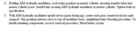

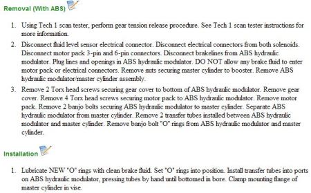

need to know how to replace a master cylinder on a 1994 grand am with abs brakes. We need to know how to set the gears for the abs brakes.
