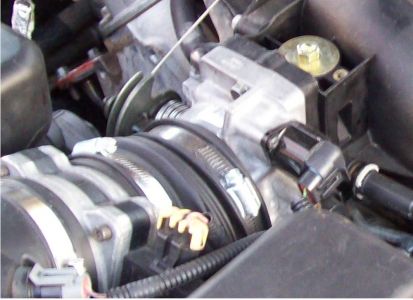

Can you get me a closer picture of the throttle body when you get a chance I wanna see if we can cheat a little bit?

Is this a good pic I coud remove the air intake, so you could see the whole throttle?

This isnt the correct way to fix it, but since I am not there to see what the car is doing you can try this. There should be a stop screw on the throttle cable side that you may be able to turn up to raise your idle. I cant see in the pic if there is one or not.

I know what screw that is, how much should I turn it, or how high?

I would say just enough to get the idle where you want it and it doesnt interfer with the throttle position sensor reading.

I did the throttle stop adjustment. At first I did it too much and the RPM were going up and down erratically at a stop(it would be idling correctly then the rpm would go down slowly, then they would jump into 900, repeatedly. So I lowered it a little and it stopped idling erratically, but the RPM still would drop(500rpm, then it start shaking a lot). What I am thinking it is that vacuum line that I found not connected to any thing, probably the end I can't find is causing my car to do it. I just need to get a diagram of the vacuum line. Where to look for one? Is there anything else that may cause this?
