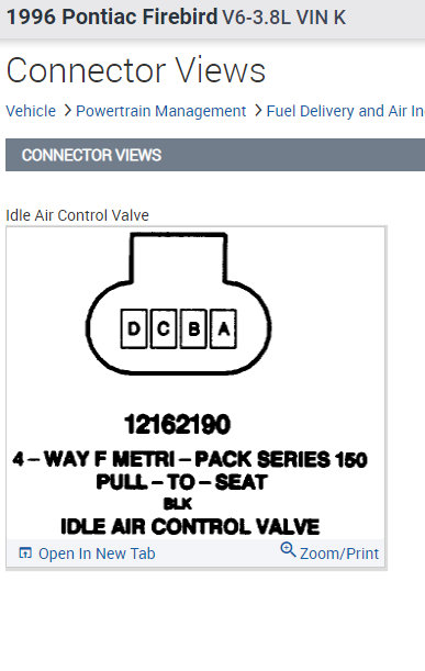

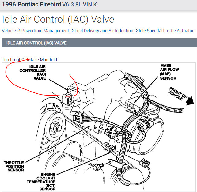

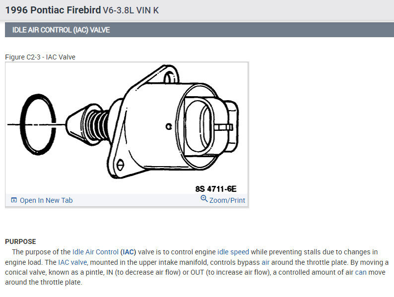

It sounds like an issue with the idle air control motor (IAC).
The IAC is located on the throttle body.
https://www.2carpros.com/articles/engine-idles-too-high

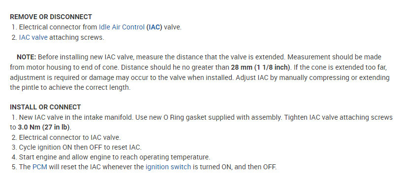

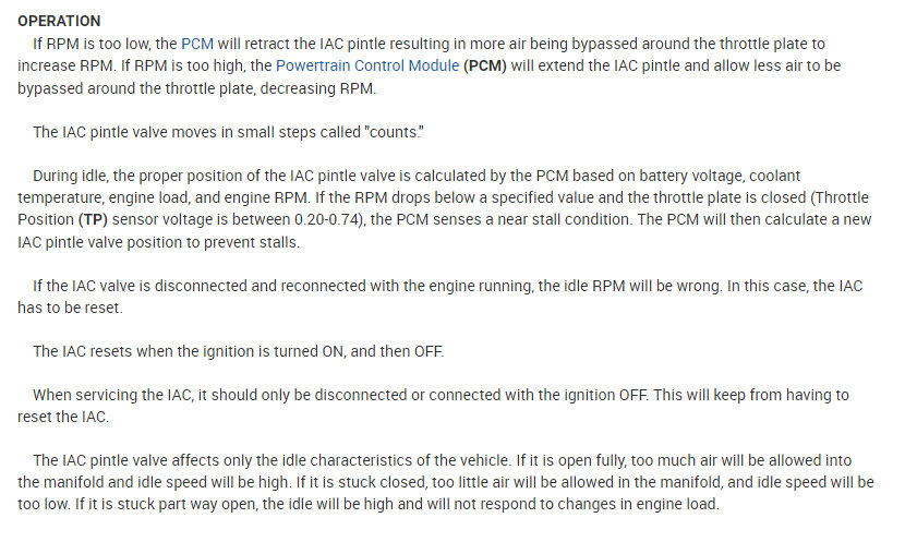

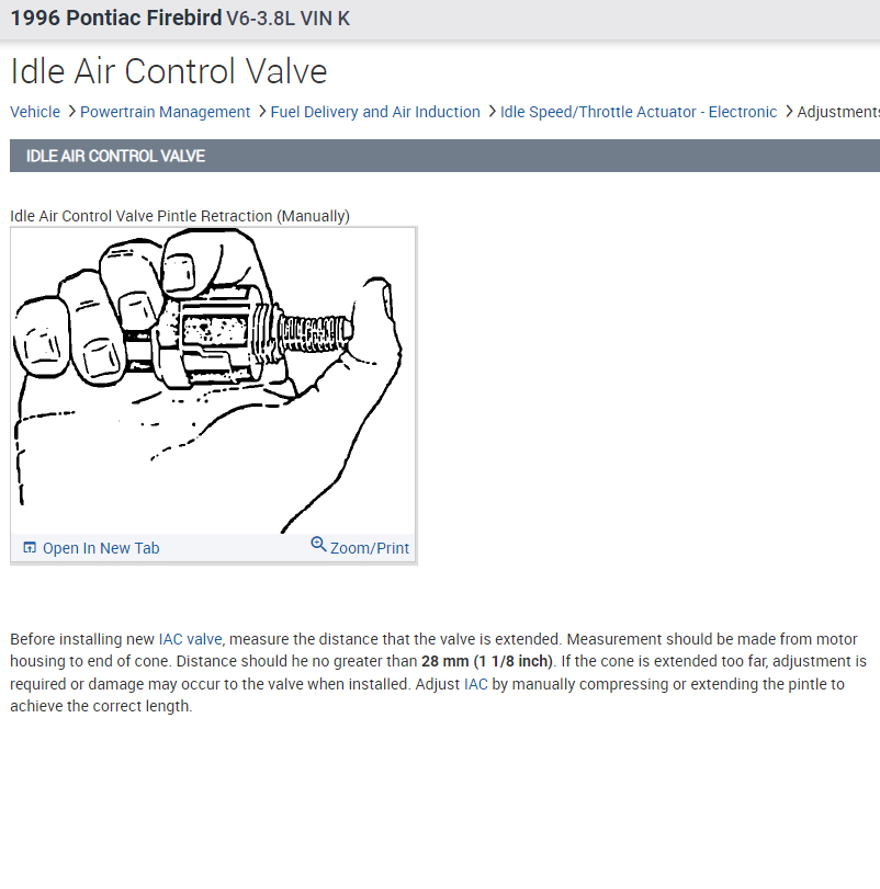

A weak spring inside the IAC can cause the idle to be high. It can also be high if there are too much corrosion buildup on the spring which allow more than correct amount of air.
Cleaning the IAC many times fixes this issue.
Here are couple of helpful article:
https://www.2carpros.com/articles/how-a-idle-air-control-valve-works
https://www.2carpros.com/articles/idle-air-control-valve-service
