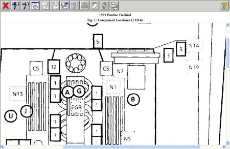

The fuel pump won't turn off even with the key out of the ignition any idea's or advice would be great also if anyone knows the location of the fuel relay. I found three relays behind the master cylinder on the drivers side firewall and pulled each one individually and none of them shut off the fuel pump.

Fuel pump relay-see below item no.3 location
https://www.2carpros.com/forum/automotive_pictures/12900_fuel_pump_relay_14.jpg

I pulled that relay and it didn't kill the pump any idea why?

Okay disconnect the oil pressure switch and let me know what happened.

Pulling it off and if it continues the wires gray and orange are shorted together

I pulled the connector and it shut the fuel pump off so I guess I need a new switch right? And thankyou for all your help, you were dead on.
