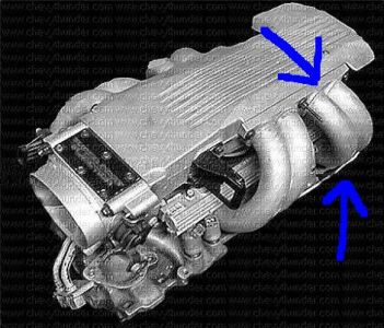

Ok so I have changed out the plugs and wires, its running better but still feels and sounds like its missing, and still pluming a light colored smoke when its given gas. In addition to this the rear pipes on the driver side coming from the plenum to the intake manifold are cold while its running... like refrigerator cold... to the point that they condensate

Also throwing codes 32, 34, 42, 44, and 45

Code 45 rich Code 44 lean pull connector from O2 place Volt meter between O2 term and ground what is voltage? Rev up engine does voltage change?
Code 42 possible Ignition control module my experence replace not much $ and will cause all kinds of trouble.
Code 34 MAF sensor try cleaning and look for any leakes in air plenum. Disconnect wire run does code 33 set? If yes replace
Code 32 EGR maybe solenoid or not seating pull off and clean carbon out.
