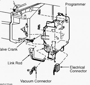

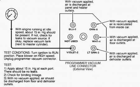

You can try adjusting the air mix valve link, here's how, and test the vacuum connector too!
AIR MIX VALVE LINK Remove glove box. Disconnect link rod from output crank on programmer. See Fig. 1 . Start engine. Set control panel for maximum heating. Allow at least 45 seconds for programmer to reach full heating position. Move air mix valve crank to maximum heat position, hold it in this position, and snap the link rod onto the output crank.
