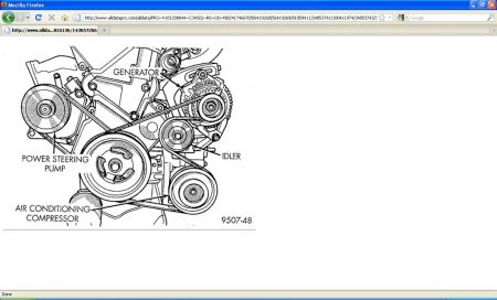

i NEED to replace the serpentine belt on my 97 plymouth voyager 2.4L SFI DOHC 4cyl
I am looking for the BELT DIAGRAM and best way to put it on. The belt broke and I did not find any diagram on its placement under the hood. The Auto Parts store said there is no automatic tensioner for this model?
Thank You

What is the 8th digit of your vin?Also which belt broke?What Does the belt run?

The belt runs the AIR COMP and ALT

https://www.2carpros.com/forum/automotive_pictures/416332_1997_plymouth_voyager_drive_belt_part_1_1.jpg
https://www.2carpros.com/forum/automotive_pictures/416332_1997_plymouth_voyager_drive_belt_part_2_1.jpg
https://www.2carpros.com/forum/automotive_pictures/416332_1997_plymouth_voyager_drive_belt_part_3_1.jpg
1. Loosen lower generator pivot bolt and upper locking nut, then loosen adjusting bolt to remove belt tension.
CAUTION: Belt damage may occur if the following procedure is not performed.
2. Tighten lock nut to 21 Nm (180 inch lbs.) and torque generator pivot bolt to 54 Nm (40 ft. lbs.) . To assure proper alignment of generator assembly. Adjust belt tension by tightening the adjusting bolt until proper belt tension is obtained.
3. Torque lock nut to 54 Nm (40 ft. lbs.) .
There you go.
Sunday, September 19th, 2010 AT 11:07 AM

BUT the last 2 pictures are of the power steering pump. I don't have to make any adjustments too that do I? Do You have the CLOSE UP pictures of the ALT/COMP?

I was just giving you the other adjustment point's in case you wanted to change that belt too.I emailed you the diagram for the alternator and a/c compressor so you can see it better.I don't know the difference between the B and the X engine's it's possible dodge used a mistubushi engine they worked together to make some model's of car's even.I checked for technical Service Bulletins for the timing belt but couldn't find any that's the best I can tell you about that.
