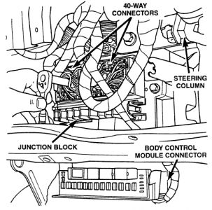

The instrument panel and speedometer and tach and fuel gauge will quit working when driving. Sometimes you can hit the dash to the right of the steering wheel and it comes back on.

The instrument panel wiring harness connector is located at the bottom of the body control module.
It's exactly the side where you hit when it's not working.
Check if the connector to the module is tight (check all of them) the instrument panel is one of them.
